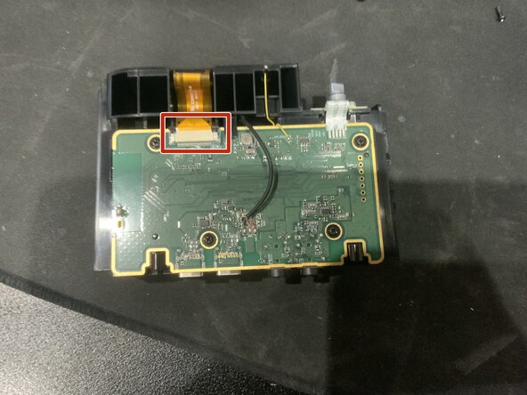

    7. Steelseries Arctis Nova Pro Wireless Teardown, Disconnect the screen: step 7, image 1 of 1
      • To remove the ribbon cable connecting the screen:
      • Use a spudger to gently push on alternating sides of the plastic tab until it clicks up into its unlocked position.
      • Once the tab is unlocked, you can gently pull the cable straight out of its socket.
      • The cable should be able to slide in and out of the socket with little to no force. If you feel resistance, the tab may not be fully unlocked.
