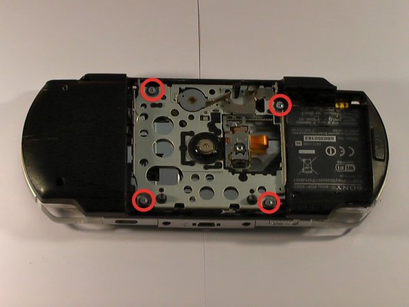

    • Start by removing the three screws highlighted by the red circles.
    • Take care when removing the forth screw, as it's slightly tighter than the rest. This screw is highlighted in blue.
    • This is the point of no return, if you choose go on, you're voiding your warranty. So, carefully peel back the warning sticker all the way off.
    • You'll find two small screws concealed below the label, remove those screws.

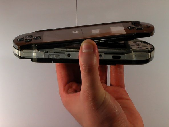

    • You can now start to carefully pry the top cover from the unit, using the spudger. Start from right to left, leveraging slowly.
    • Contrary to what this picture might suggest, this PSP hasn't contracted chickenpox. Each red circle indicates a screw that you need to remove.
    • Carefully unclip the connector circled in red.

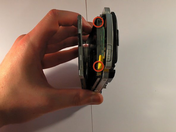

    • Open the UMD slot. With the screen facing towards you, unclip the locks at the bottom right outer-side of the hinge, and the bottom left, inner-side of the hinge. Remove this component.
    • Remove the four newly revealed screws, in any order. If you're afraid of commitment, you might like to assign each screw a number between 1-4, and decide using a random number generator. Remove this component.
    • Place the PSP face up, with the joystick side on the right. There are two lock clips located on the right side of the LCD, unhinge these. Remove this component.

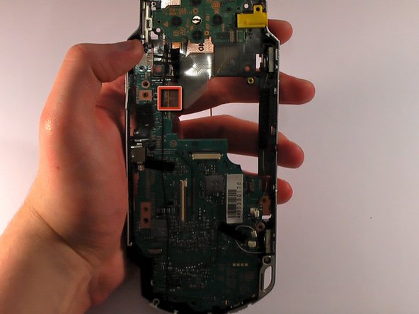

    • Now don't get all gung-ho, be careful when detaching the LCD, as it's attached with two connectors. You can unlock these connectors by pulling back the brown latches VERY carefully.
    • Same deal again, go crazy with remove the screws highlighted in red... Crazy in a calm and collected way. Remove this component.
    • Disconnect these two cables.

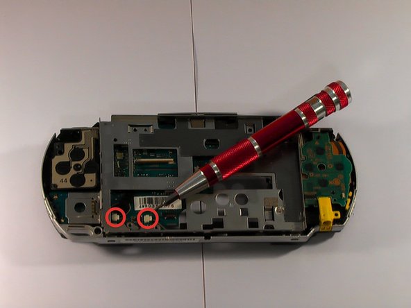

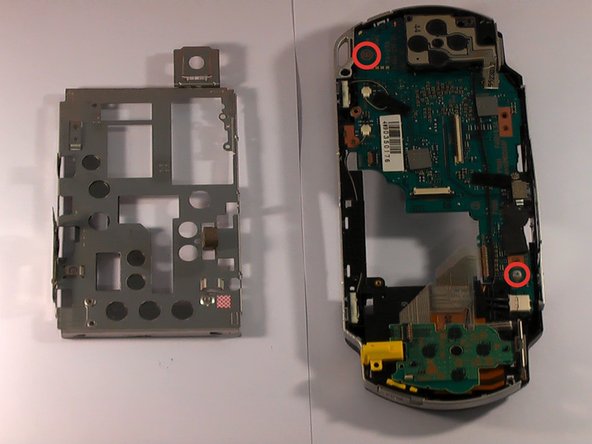

    • Remove the screw labelled in red (to the top right of the device, the other is incorrectly labeled in the image). These are holding down the main circuit board.

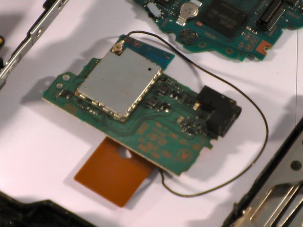

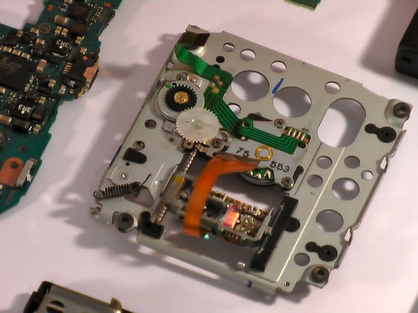

    • Almost there, if you've come this far, I commend you on your effort! Again, carefully pry open the cable lock and remove the WiFi component.

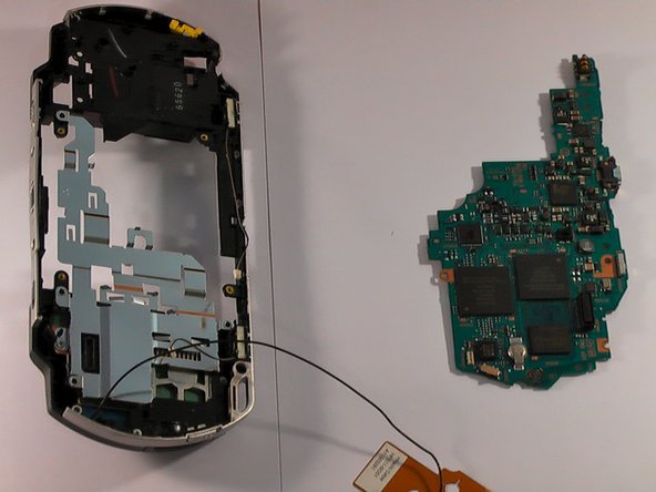

    • Remove the circuit board, this might be the most important step. Sit back and gaze at the chips for at least 5-8 minutes. NOTE: You can come back to this step at any point.
  7. PSP 1000 Teardown: step 7, image 1 of 3 PSP 1000 Teardown: step 7, image 2 of 3 PSP 1000 Teardown: step 7, image 3 of 3

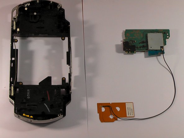

    • You can now remove the WiFi board and chip, along with the metal plate.
    • The chip Sony used in the original PSP could pick up wireless G bands, which made it a nippy handheld network device for its time.
    • At the time, £280 worth of circuitry, wires, metal and plastic. Beautiful sight.

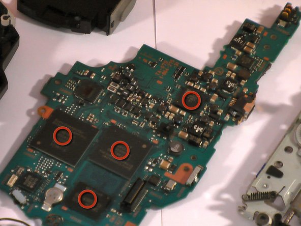

    • Mmm... circuits. SIDE NOTE: I'm not certain, but I think that the chips circled in red control the DRM for the device ;)
