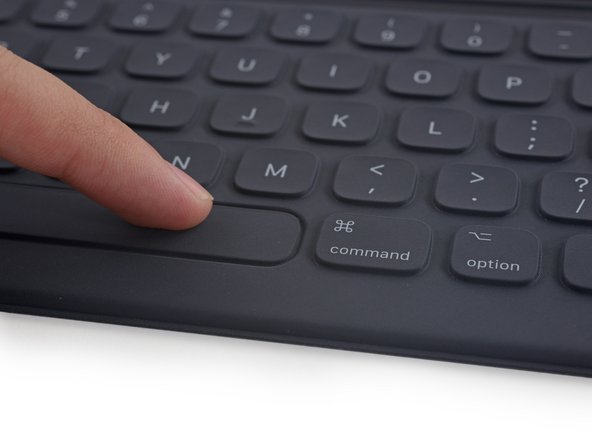

  • One design choice we like is the placement of a stiffening weight in the spacebar.
    • The addition of this bar means the spacebar key can register a push no matter where you tap on it. No wobbly spacebar woes here.

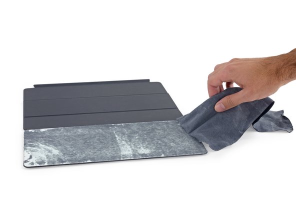

  • We call upon our iOpener to heat the microfiber lining, allowing us to delve further into the multiple layers of the Smart Keyboard cover panel.
    • We're starting to feel like archeologists, digging through the ages...
  • Underneath the soft display cover we find... nothing really.

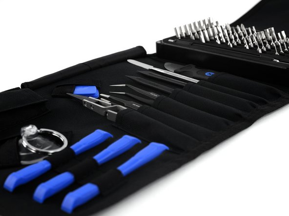

  • Time for a brief message from our sponsors: We're excited to announce that we've just released a completely redesigned Pro Tech Toolkit, complete with all of the tools you need, and none that you don't.
  • With this tough plastic layer blocking further keyboard inroads, we're going to need one of those tools...

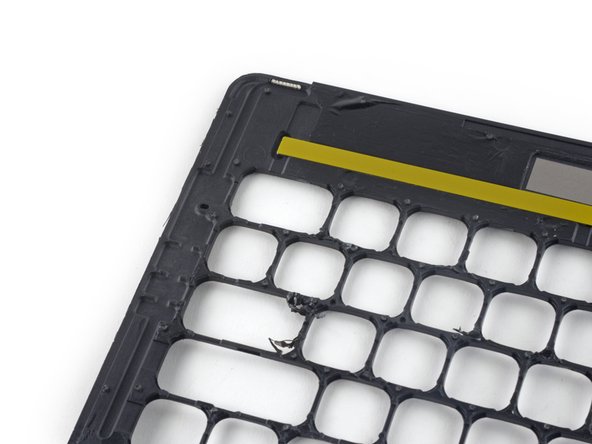

Image 1/2: There are some interesting intestinal squiggles in this plastic frame, what's up with that?
Edit Step 8  ¶
  • Another one bites the dust. We pull the keycap frame away for a closer look.
  • There are some interesting intestinal squiggles in this plastic frame, what's up with that?
  • Closer inspection shows these channels lead to tiny vents at the top of the keyboard.
    • We assume this keeps the Smart Keyboard from becoming a pressurized balloon every time a key is depressed.
    • Let's hope these holes don't let water in...

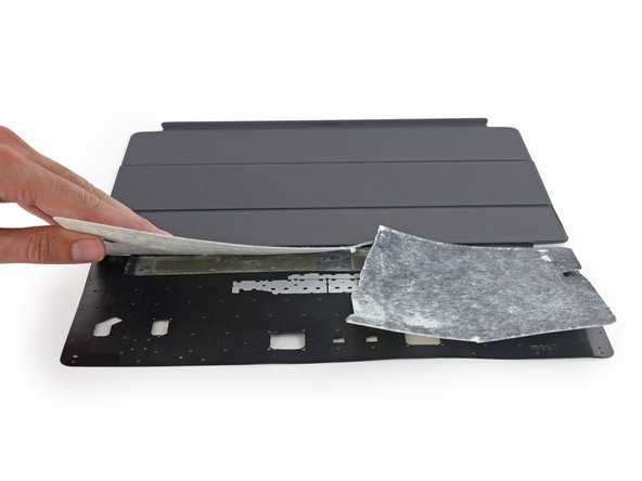

  • Time to peel up yet another layer! In fact, it's that tough plastic backing we encountered earlier. It's aggressively glued, so we aggressively, well, ripped in in half...
  • Finally, the true keyboard is revealed—a plane of switches and chips!
  • The brains of the operation is Apple's latest go-to microcontroller for peripheral input devices:
