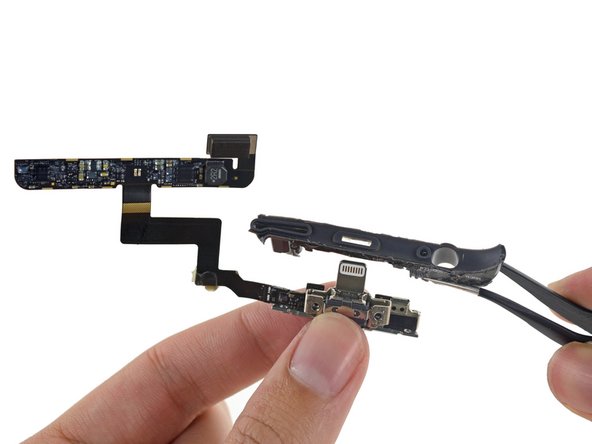

Image 1/3: The two Lightning connectors are housed on the same board, with its connecting cable wrapped around a plastic frame.
Edit Step 9  ¶
  • We're free! After some dedicated snipping, that had us harkening back to teardowns of yore, we extricate the parts that make this battery Smart.
  • The two Lightning connectors are housed on the same board, with its connecting cable wrapped around a plastic frame.

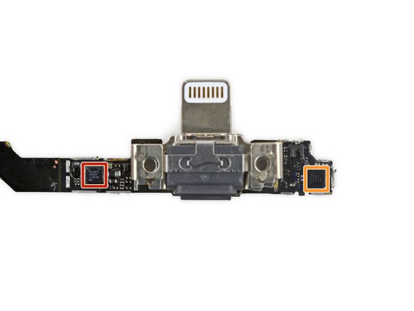

Image 1/3: NXP NX20P3 load switch, also found in [http://www.chipworks.com/about-chipworks/overview/blog/inside-apple-lightning-cable|Lightning to USB cables|new_window=true]
Edit Step 10  ¶
  • For such a Smart battery, it looks like most of the brains probably live in software on your iPhone. We only find some rudimentary ICs inside:
