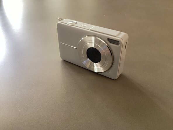

  1. Small Digital Camera Teardown, Small Digital Camera Teardown: step 1, image 1 of 3 Small Digital Camera Teardown, Small Digital Camera Teardown: step 1, image 2 of 3 Small Digital Camera Teardown, Small Digital Camera Teardown: step 1, image 3 of 3
    • This is a digital camera I bought from a thrift store for $10. It has a very small 0.3 megapixel camera sensor and a depressing low resolution screen .
    • The camera is very light, weighing significantly less than an ounce.
    • The battery keeps dying after charging almost instantly, so it is time to put an end to this thing.

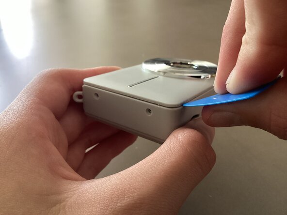

  2. Small Digital Camera Teardown: step 2, image 1 of 3 Small Digital Camera Teardown: step 2, image 2 of 3 Small Digital Camera Teardown: step 2, image 3 of 3
    • For Step One, use a Philips screwdriver to remove the 2 screws on the right side of the camera.
    • Once the screws have been removed, use a Flathead screwdriver or an opening pick to unclip the plastic tabs holding the outside case together.
    • Be careful of any ribbon cables that may be under the front plastic case, as a screwdriver or opening pick may damage one of the cables, if any.

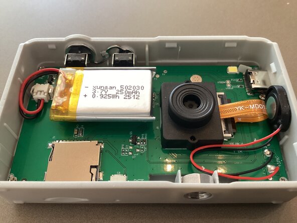

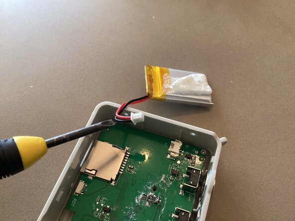

  3. Small Digital Camera Teardown: step 3, image 1 of 3 Small Digital Camera Teardown: step 3, image 2 of 3 Small Digital Camera Teardown: step 3, image 3 of 3
    • Once the front plastic case is removed, disconnect the battery.
    • Do not puncture the battery. You will have a hard time with the battery entering thermal runaway, eventually putting out poisonous gasses, and flames…
    • (Please use an opening pick, and not a flathead to pry out the battery. You will be happy…)

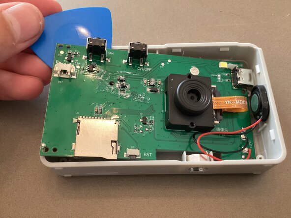

  4. Small Digital Camera Teardown: step 4, image 1 of 3 Small Digital Camera Teardown: step 4, image 2 of 3 Small Digital Camera Teardown: step 4, image 3 of 3
    • Unscrew the four screws holding the PCB in place by using a Philips head screwdriver.
    • Use an opening pick or flathead to pry the board out.
    • To get the board out, you must remove the SD card from the card slot. (I already removed it before I even started this teardown.)
  5. Small Digital Camera Teardown: step 5, image 1 of 3 Small Digital Camera Teardown: step 5, image 2 of 3 Small Digital Camera Teardown: step 5, image 3 of 3
    • The PCB is quite uneventful, as only one major chip exists. I can’t find any information on the main chip, but it is a quad-flat package from “JR” integrated circuits.
    • You can remove the screen by un-fastening the clip holding the ribbon cable in place. Just use your finger.
    • Other components on the board include another small IC, a quartz crystal/oscillator, and a couple of capacitors and resistors.
