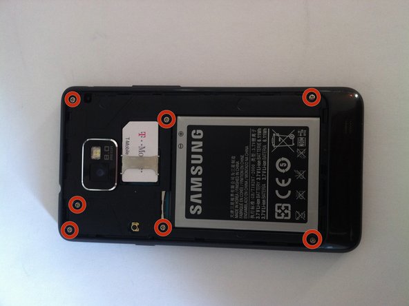

Look at how compact everything is inside!
  • Look at how compact everything is inside!
  • Remove the seven visible screws.
  • Then unclip the back panel starting on the left next to the audio jack. Go slowly.
Removing the back panel gives you an impressive and sophisticated view of the internals. Removing the back panel gives you an impressive and sophisticated view of the internals. Removing the back panel gives you an impressive and sophisticated view of the internals.
  • Removing the back panel gives you an impressive and sophisticated view of the internals.
