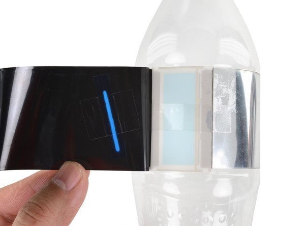

Our first look inside! This is definitely not your ordinary Coke bottle.

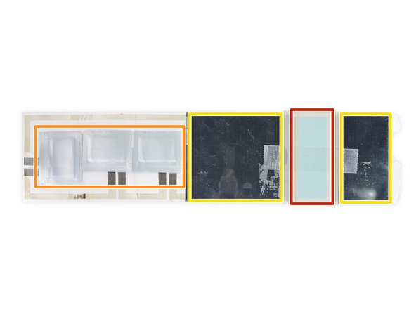

Carefully peeling away the paper-backed circuit, we find:
The OLED panel
Kyber crystalsBattery packs -
Membrane switches
That's all to this drinkable lightsaber!
Inuru, the company behind these limited-edition bottles, hopes to usher in a new era of smart labels with this technology.

So what kind of battery chemistry does it use?
Good question! The site has little to say about the battery, other than the fact that it’s similar to fruit. I would hypothesize that it’s multiple little battery packs in series, each with an acidic gel electrolyte between anode and cathode plates.
