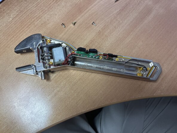

  1. Presidian Power Wrench 63-195 Teardown, Remove Phillips screw holding the battery compartment: step 1, image 1 of 1
    • its the only philips head screw on thee whole thing so it shouldn't be hard to keep track of it
  2. Presidian Power Wrench 63-195 Teardown, Take the three hex screws out: step 2, image 1 of 1
    • depending on what you have you can use either the number 2 hex head bit or a 5/64th allen key
  3. Presidian Power Wrench 63-195 Teardown, take the shell off: step 3, image 1 of 1
    • the plastic shell should come off easy if you pull from the battery compartment
  4. Presidian Power Wrench 63-195 Teardown, Remove the Power and action switch: step 4, image 1 of 1
    • they both slot into the case so its easy to get in and out
  5. Presidian Power Wrench 63-195 Teardown, take out the left and right soft jaws in the head: step 5, image 1 of 2 Presidian Power Wrench 63-195 Teardown, take out the left and right soft jaws in the head: step 5, image 2 of 2
    • Because of the space we are working with this is where the allen key can come in real handy
