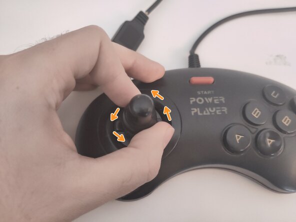

  1. Power Player Super Joy III - Second Player Controller Teardown, Remove the D-Pad extender.: step 1, image 1 of 3 Power Player Super Joy III - Second Player Controller Teardown, Remove the D-Pad extender.: step 1, image 2 of 3 Power Player Super Joy III - Second Player Controller Teardown, Remove the D-Pad extender.: step 1, image 3 of 3
    • Some controllers have an extended joystick pole in the middle of their D-Pad.
    • This can be removed by hand, simply rotating the stick counter-clockwise.

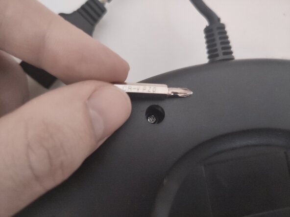

  2. Power Player Super Joy III - Second Player Controller Teardown, Remove the six screws on the back.: step 2, image 1 of 2 Power Player Super Joy III - Second Player Controller Teardown, Remove the six screws on the back.: step 2, image 2 of 2
    • The controller is held together with six Phillips crosshead screws on the back.
    • Use a screwdriver with a 0 size tip with at least 20mm of length in the driver.

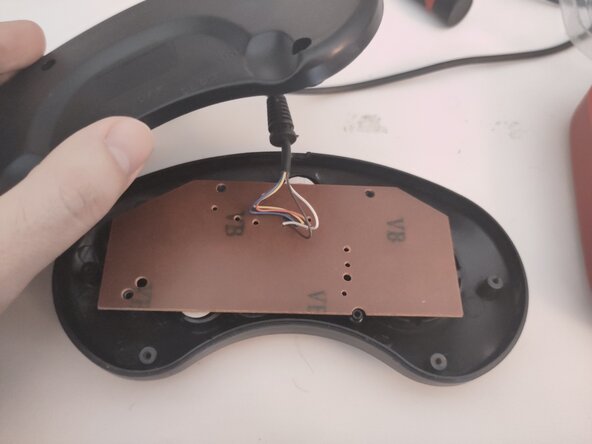

  3. Power Player Super Joy III - Second Player Controller Teardown, Remove the back cover.: step 3, image 1 of 2 Power Player Super Joy III - Second Player Controller Teardown, Remove the back cover.: step 3, image 2 of 2
    • The back of the controller can be removed by grabbing the top and bottom of the back piece and lifting it off.
  4. Power Player Super Joy III - Second Player Controller Teardown, Remove the PCB.: step 4, image 1 of 3 Power Player Super Joy III - Second Player Controller Teardown, Remove the PCB.: step 4, image 2 of 3 Power Player Super Joy III - Second Player Controller Teardown, Remove the PCB.: step 4, image 3 of 3
    • The printed circuit board can be removed by grabbing the top and bottom of the board, then lifting it off.
    • Underneath the board are all the controller's buttons; six on the right side, a four-button D-pad membrane, and the Start button on top.
    • The button membranes may sometimes stick to the board.
    • The printed circuit board is rather simple, but uses a tiny proprietary chip covered under a drop of black epoxy to protect and obscure the logic. However, it is likely a simple 8-bit shift register to send an 8-bit signal similar to an NES controller back to the main famiclone unit.
