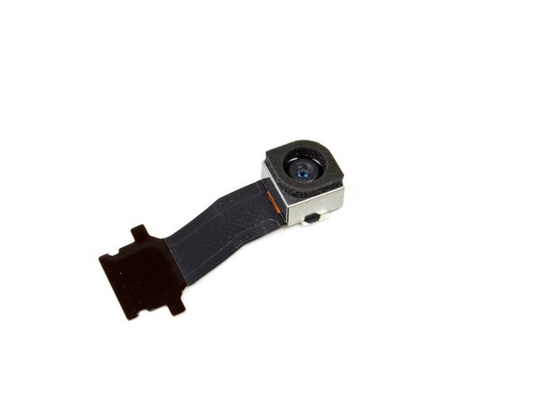

  13. Recruiting the help of our spudger, we remove the rear-facing camera. Though the Vita is the first Sony handheld device to boast a camera, you shouldn't cancel your D800 pre-order quite yet. The 640x480 pixel VGA quality (0.3 MP) camera isn't likely to wow the folks browsing your Flickr stream.
    • Recruiting the help of our spudger, we remove the rear-facing camera.
    • Though the Vita is the first Sony handheld device to boast a camera, you shouldn't cancel your D800 pre-order quite yet. The 640x480 pixel VGA quality (0.3 MP) camera isn't likely to wow the folks browsing your Flickr stream.
    • On a related note, the camera is of perfect quality to turn your world into an Augmented Reality.

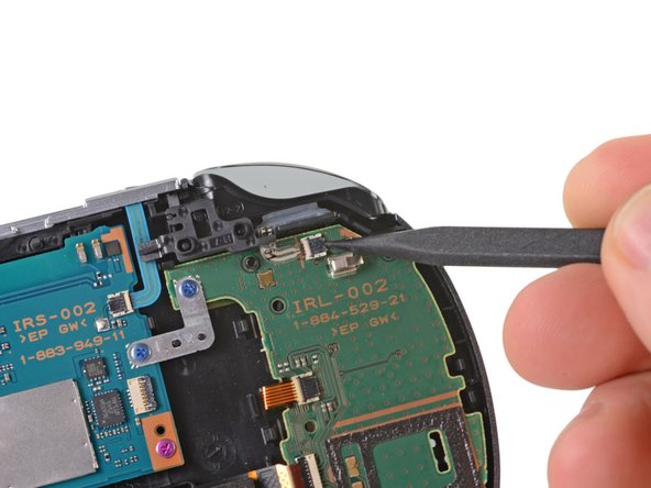

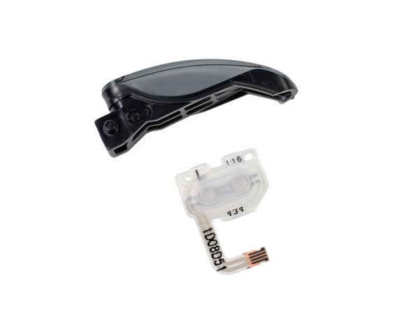

  16. The trigger buttons are easily removed and are a simple, modular design. This means easier and cheaper repair for the masses! If it ain't broke, don't fix it. Sony has used the same basic design for the R and L trigger buttons since the original PSP.
    • The trigger buttons are easily removed and are a simple, modular design. This means easier and cheaper repair for the masses!
    • If it ain't broke, don't fix it. Sony has used the same basic design for the R and L trigger buttons since the original PSP.

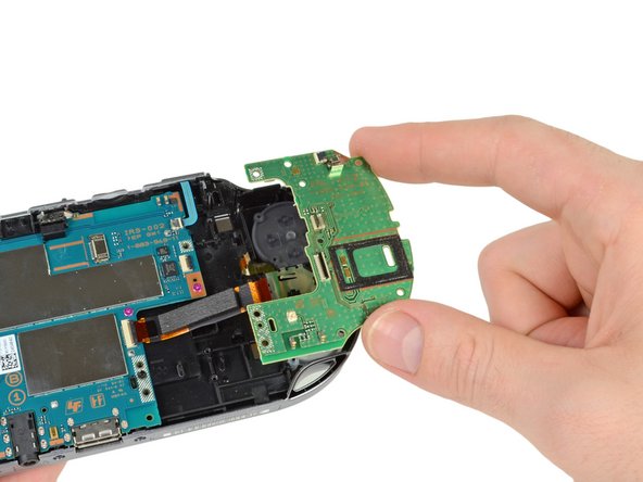

  17. The button boards are held on with nothing more than a few screws. The PS Vita control interfaces are separated into several small pieces, further enhancing repairability of this device.
    • The button boards are held on with nothing more than a few screws.
    • The PS Vita control interfaces are separated into several small pieces, further enhancing repairability of this device.

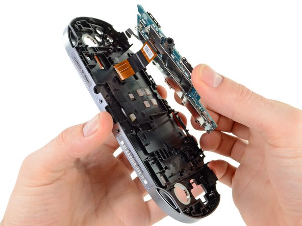

  18. As we begin removing the screws for the motherboard, it slowly dawns on us... Colored screws! The pink-ish screws hold the motherboard in place while the blue screws hold attachments to the motherboard. It's like a boy/girl screw party!
    • As we begin removing the screws for the motherboard, it slowly dawns on us...
    • Colored screws! The pink-ish screws hold the motherboard in place while the blue screws hold attachments to the motherboard.
    • It's like a boy/girl screw party!
    • When we were done ogling the colored screws, we lifted the motherboard up and away, detaching the OLED display and touchscreen connectors.

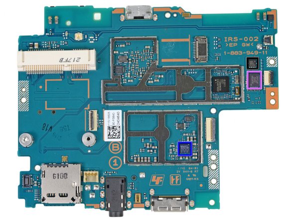

  20. With the motherboard finally all by itself, we can begin chip identification: Sony CXD5315GG quad-core processor + system memory
    • With the motherboard finally all by itself, we can begin chip identification:
    • Sony CXD5315GG quad-core processor + system memory
    • Samsung KLM4G1FE3A-F001 NAND flash memory
    • Fujitsu MB44C026A
    • Marvell 88W878S-BKB2 Avastar WLAN/Bluetooth/FM Single-Chip SoC
    • Wolfson Micro WM1803E audio codec
    • STMicroelectronics 3GA51H gyroscope
    • Kionix KXTC9 three-axis MEMS accelerometer

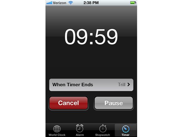

    • We baked our Vita in order to separate the front plastic (and fused OLED display) from the frame. Our quick recipe for frame removal:
    • Pre-heat oven to 200 F.
    • Place PS Vita front panel assembly in the oven and set timer for 10 minutes.
    • Remove the PS Vita from the oven and carefully peel the plastic off the front case using several guitar picks. Watch out -- it's hot!
    • Take 10 points back from Gryffindor.
    • Baking electronics: much easier than baking bread. All the ingredients are pre-mixed!

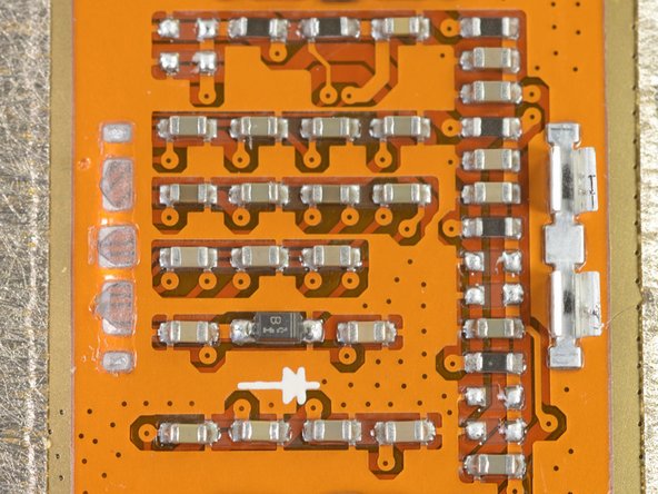

  21. The front plastic and OLED display slowly came off from the frame. Note that the OLED display is fused to the plastic, making this procedure very precarious. Underneath we find another Atmel mXT224 touchscreen controller, which has graced tons of teardown devices in the past, including this one! We also found a grid of what appears to be a smörgåsbord of capacitors, resistors (and one lonely diode) under the frame. Interesting...
    • The front plastic and OLED display slowly came off from the frame. Note that the OLED display is fused to the plastic, making this procedure very precarious.
    • Underneath we find another Atmel mXT224 touchscreen controller, which has graced tons of teardown devices in the past, including this one!
    • We also found a grid of what appears to be a smörgåsbord of capacitors, resistors (and one lonely diode) under the frame. Interesting...
