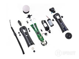

  • Let's see what's inside shall we?
  • Removing a few Phillips screws allows us to detach the rear cover of the motion controller.
  • A simple tug of the rear cover reveals the innards of the PlayStation Move motion controller.

  • We continue delving deeper into the motion controller by removing the single Phillips screw securing the battery housing to the motherboard.
  • The vibrator motor lifts off, however it still remains connected to the motherboard.
Edit Step 9  ¶
Image #1
Edit Step 9  ¶
  • The motherboard can be lifted out after removing the last few screws securing it to the case assembly.

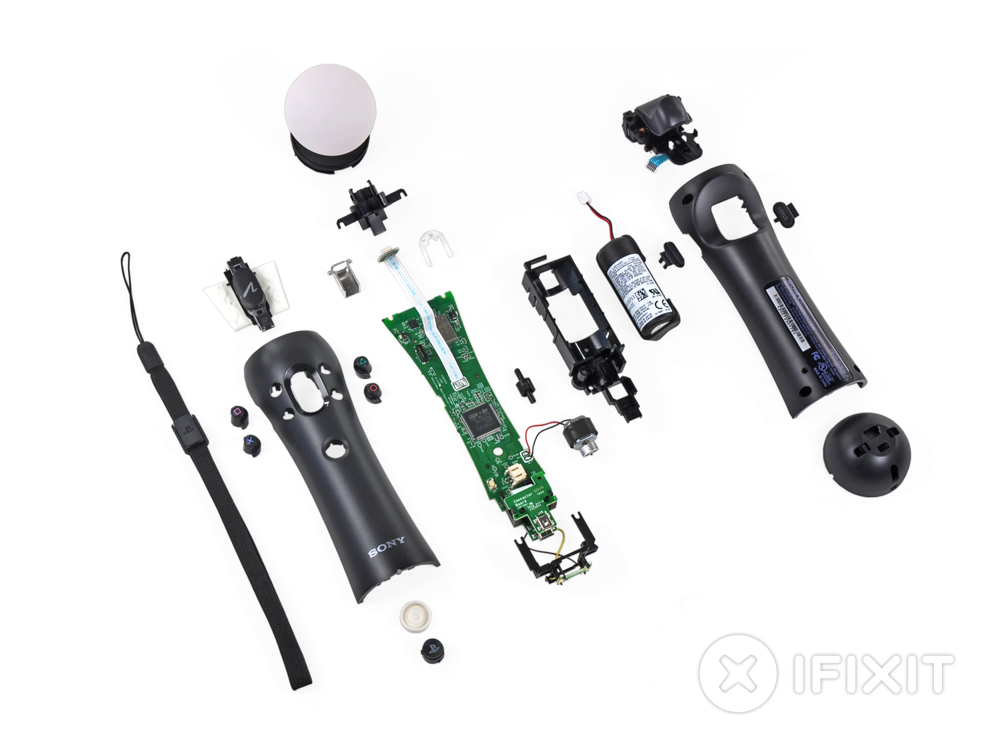

  • Front and back side of the controller motherboard.
    • The Move board loses points on repairability due to the vibrator motor, LED, charge contacts, and EXT cables being soldered down.
  • The top half of the front side of the motherboard is dedicated to the button contacts, while the bottom half is crammed full of chips.
  • The back side is dominated by the ARM processor.

  • STM32F103VBT6 ARM-based 32-bit MCU with Flash, USB, CAN, seven 16-bit timers, two ADCs and nine communication interfaces.
  • Y5250H 2029 K8QEZ. This is quite possibly the gyroscope, but we won't be able to tell for sure without decapping the chip.
  • Kionix KXSC4 10227 2410 accelerometer
  • Texas Instruments BQ24080 1-cell Li-Ion Charger.
  • A little birdy helped us identify this TPS63030 High Efficient Single Inductor Buck-Boost Converter.
  • CSR (Cambridge Silicon Radio) BC4RE A16U Bluetooth transmitter
  • AKM AK8974 three-axis Electronic Compass (MEMS)

  • PlayStation Move Repairability: 8 out of 10 (10 is easiest to repair)
  • Good: You can easily open the controller to access the internals.
  • Good: Battery can be easily replaced once you open the controller -- it has a connector instead of soldered contacts.
  • Good: The trigger comes out as one unit, making it easy to replace.
  • Good: The LED has a heatsink that will make it operate more efficiently and last longer.
  • Bad: Other components, such as the vibrator motor and LED, are soldered to the motherboard.
