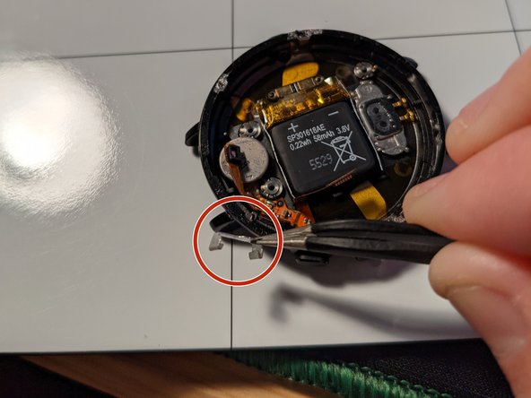

  2. Pebble Time Round Teardown, Open the case: step 2, image 1 of 1
    • Use a guitar pick and push on the left or right side, above the buttons to separate the case from the glass front.
    • Don’t push too far in, or you may hit some key internal components.
    • A heat gun will make this easier, but it’s not required.

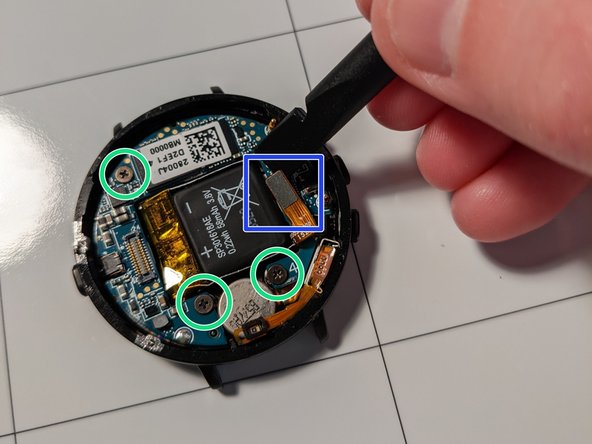

  3. Pebble Time Round Teardown, Internal Springs: step 3, image 1 of 1
    • There are three small springs that are embedded in the casing, just waiting to pop out. Once you separate the case enough to see inside, look and make sure they don’t come loose.
    • You can see in the picture where they are located. The screws are in green, and the holes for them are in red.
    • These are part of the bluetooth antenna, be careful not to lose them.

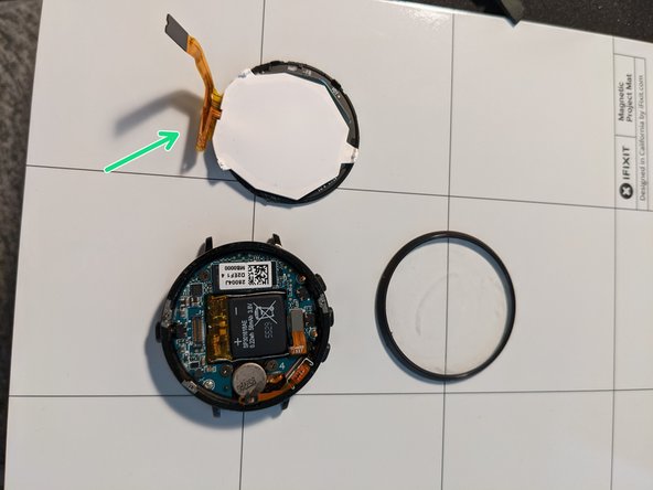

  4. Pebble Time Round Teardown, Separate the screens: step 4, image 1 of 3 Pebble Time Round Teardown, Separate the screens: step 4, image 2 of 3 Pebble Time Round Teardown, Separate the screens: step 4, image 3 of 3
    • The glass face should come off with a little coaxing from a pick.
    • Gently separate the white touch panel from the e-paper screen. These fall apart easily but are held together by two cables.
    • Use a spudger to detach the small cable from the white touch panel. This cable is for the microphone and vibration motor.
    • Use a spudger to detach the second cable. This cable is for the display. The second picture shows it already detached.
    • Be extremely careful with the display cable. It is attached to the display at an extremely thin glass piece that breaks easily. If the glass breaks, it cannot be repaired.

  7. Pebble Time Round Teardown, You now have all the pieces of the screen apart: step 7, image 1 of 1
    • The glass face
    • The bezel ring
    • The e-paper screen
    • The backlight panel

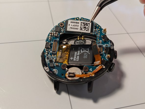

  9. Pebble Time Round Teardown, Examine the motherboard: step 9, image 1 of 1
    • After removing the motherboard, you can peel off the sticker with the QR code and attempt to read the tiny writing on the chip.
    • All I can see is that it is a Spansion chip, and Google tells me the company is now called Cypress Semiconductor.
    • Someone with better eyes can comment and tell me what theirs says.
