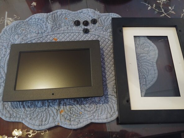

- Disassembled Frame: Front and back plastic halves separated, revealing the stand screws and clips.

#NaN. Unscrew and pry apart the plastic frame.

Disassemble with phillip head screwdriver. Gently pry with guitar pick.
