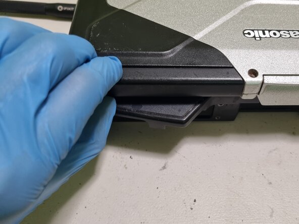

  23. Panasonic Toughbook CF-31 Teardown: step 23, image 1 of 3 Panasonic Toughbook CF-31 Teardown: step 23, image 2 of 3 Panasonic Toughbook CF-31 Teardown: step 23, image 3 of 3
    • Take the handle out by lifting it up.
    • Beware of the piece shown in the second image. There are four of these pieces, their locations are highlighted in the third image. They are essentially the hinge of the handle, and they like to come out when you least expect them and get lost. I recommend taking them out, and saving them individually. Trust me, you'll thank me.

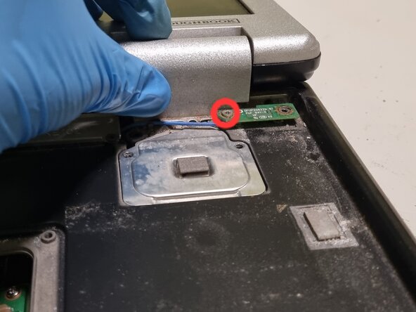

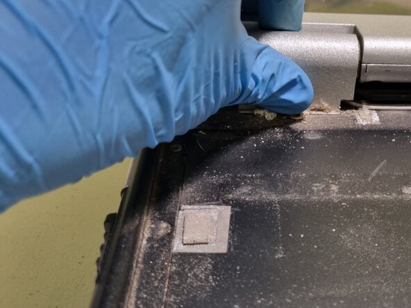

  24. Panasonic Toughbook CF-31 Teardown: step 24, image 1 of 2 Panasonic Toughbook CF-31 Teardown: step 24, image 2 of 2
    • Thake out those screws with a JIS #0 screwdriver, and remove the speaker cover.
    • Take the power slider out by lifting it off.
    • Don't be stupid like me and slide the power button back and forth. The thing quite literally exploded and I had to look everywhere for that spring. (I couldn't find the original one so I just took one from a pen, trimmed it to fit and went with it)

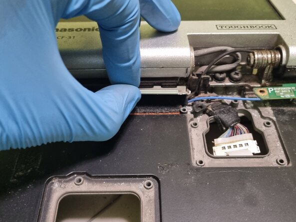

  28. Panasonic Toughbook CF-31 Teardown: step 28, image 1 of 3 Panasonic Toughbook CF-31 Teardown: step 28, image 2 of 3 Panasonic Toughbook CF-31 Teardown: step 28, image 3 of 3
    • Close the lid, and flip the laptop upside down. Ok, now let the real nightmare begin. Disconnect all of the antennas first, I have highlighted them in red.
    • Lift off that piece of tape and unscrew that screw.
    Ask FixBot

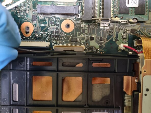

  29. Panasonic Toughbook CF-31 Teardown: step 29, image 1 of 3 Panasonic Toughbook CF-31 Teardown: step 29, image 2 of 3 Panasonic Toughbook CF-31 Teardown: step 29, image 3 of 3
    • Disconnect the big ribbon by pulling the black piece forwards.
    • Remove that piece of tape.
    • Disconnect the little ribbon by lifting the brown piece up.

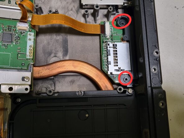

  33. Panasonic Toughbook CF-31 Teardown: step 33, image 1 of 2 Panasonic Toughbook CF-31 Teardown: step 33, image 2 of 2
    • Remove these two screws using a JIS #0 screwdriver, and take the board out.
    • Now grab this ribbon an free it from the black piece holding it.
    • From here on, if I don't say the screwdriver necessary to take the screw out, assume it's a JIS #0. I am tired of writing that much.

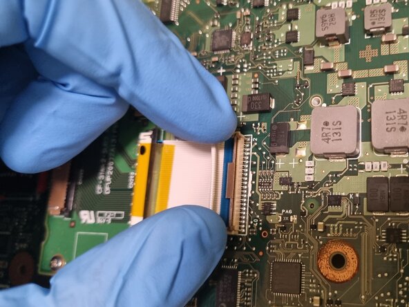

  34. Panasonic Toughbook CF-31 Teardown: step 34, image 1 of 3 Panasonic Toughbook CF-31 Teardown: step 34, image 2 of 3 Panasonic Toughbook CF-31 Teardown: step 34, image 3 of 3
    • Remove those black things on top of the brown release of the ribbon with some tweezers or something.
    • Should look like this.
    • Now unlock both ribbon cables.
    Ask FixBot

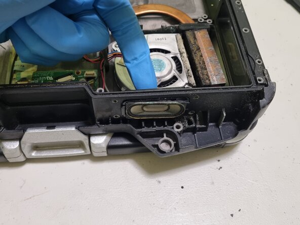

  38. Panasonic Toughbook CF-31 Teardown: step 38, image 1 of 3 Panasonic Toughbook CF-31 Teardown: step 38, image 2 of 3 Panasonic Toughbook CF-31 Teardown: step 38, image 3 of 3
    • Now take the highlighted screws out.
    • Take the top ram stick out.
    • Now grab this piece like I am and pull it out.
    Ask FixBot

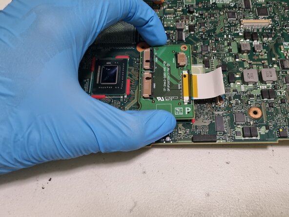

  39. Panasonic Toughbook CF-31 Teardown: step 39, image 1 of 3 Panasonic Toughbook CF-31 Teardown: step 39, image 2 of 3 Panasonic Toughbook CF-31 Teardown: step 39, image 3 of 3
    • Grab the piece from where I am and hinge it backwards carefully. Don't yank it out because it has a ribbon we have to disconnect under it.
    • Remove that black square from on top of the brown unlock thing.
    • Pull the brown thing backwards so that it faces up.
    Ask FixBot

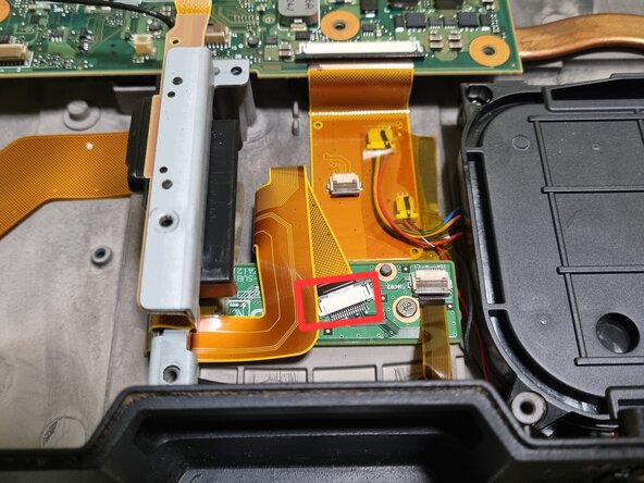

  41. Panasonic Toughbook CF-31 Teardown: step 41, image 1 of 3 Panasonic Toughbook CF-31 Teardown: step 41, image 2 of 3 Panasonic Toughbook CF-31 Teardown: step 41, image 3 of 3
    • Unplug those two ribbons by lifting the black tab up.
    • Unscrew all those screws. Use a 5 mm Hex Socket to unscrew the vga and serial ports.

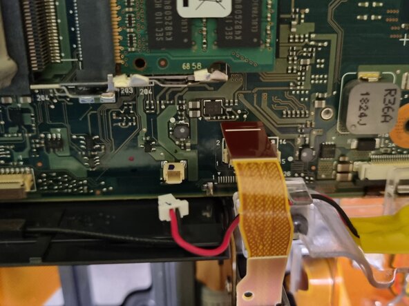

  42. Panasonic Toughbook CF-31 Teardown: step 42, image 1 of 3 Panasonic Toughbook CF-31 Teardown: step 42, image 2 of 3 Panasonic Toughbook CF-31 Teardown: step 42, image 3 of 3
    • Grab the board from where I am and take it out.
    • Unclip only this antenna from the black clip of the piece that we left dangling around.
    • Now grab this board and take it out.

  46. Panasonic Toughbook CF-31 Teardown: step 46, image 1 of 2 Panasonic Toughbook CF-31 Teardown: step 46, image 2 of 2
    • Unplug those.
    • Remove those screws.
    Ask FixBot

  52. Panasonic Toughbook CF-31 Teardown: step 52, image 1 of 3 Panasonic Toughbook CF-31 Teardown: step 52, image 2 of 3 Panasonic Toughbook CF-31 Teardown: step 52, image 3 of 3
    • Unplug this ribbon.
    • Unplug those ones too.
    • Unplug those.
    Ask FixBot

  62. Panasonic Toughbook CF-31 Teardown: step 62, image 1 of 3 Panasonic Toughbook CF-31 Teardown: step 62, image 2 of 3 Panasonic Toughbook CF-31 Teardown: step 62, image 3 of 3
    • Flip the board and remove the other ram stick.
    • Grab the wifi card like I do and take it out.
    Ask FixBot

    • Congratulations, you are done with the motherboard. Lets get back to the case. Push the speaker out like this.
    • The speaker is actually made of a speaker and a driver, don't loose them.
    • As tempting as it might be, don't poke the center of the speaker, this will deteriorate it's sound quality.

    • I won't be taking the track pad, status lights or physical power button out since I see no non-destructive way to do it, and I don't feel like absolutely ruining mine. So I won't be guiding you through that process. But I'll tell you, roughly, how to do it. I DON'T RECOMMEND DOING IT IF YOU DON'T HAVE A SPARE ON HAND.
    • Start by disconnecting those ribbons and un-route them.
    • Then flip the laptop and open it. The thing highlighted in red is actually a giant sticker. Remove it.
    • After you do, find screws, take them out, grab pieces, take them out, it's just what we've been doing all this time.
    • If you managed to do it without any help whatsoever, congratulations, you are now a technician. (This is actually how technicians work most of the time)

  69. Panasonic Toughbook CF-31 Teardown: step 69, image 1 of 2 Panasonic Toughbook CF-31 Teardown: step 69, image 2 of 2
    • Remember the piece we left dangling around on the inside? Let's remove only those antennas and take out the piece. (Finally!! I hear you say)
    • Now un-route the black antenna.
    Ask FixBot
