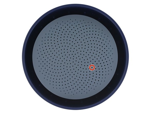

Edit Step 2  ¶
Image 1/2: This LED ring will change colors based on what state the OnHub is in. Blue means you're ready to begin setup. [https://www.ifixit.com/Teardown/Orange+Teardown/13470|Orange] is for, “Oh snap, something is wrong." Teal means you’re good to go!
Edit Step 2  ¶

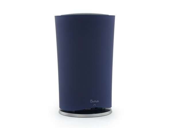

  • No blinking router lights here; let's hope the constant status light isn't blinding in the dark (it's not).
    • This LED ring will change colors based on what state the OnHub is in. Blue means you're ready to begin setup. Orange is for, “Oh snap, something is wrong." Teal means you’re good to go!
    • This mysterious anomaly in the speaker grille is probably an ambient light sensor enabling dimming.
  • We also spy a small cutaway on the bottom of the cowling for the cabling.
    • A novel idea for cable management, but not great for ease-of-access. You've got to twist the cowling off to plug anything in.

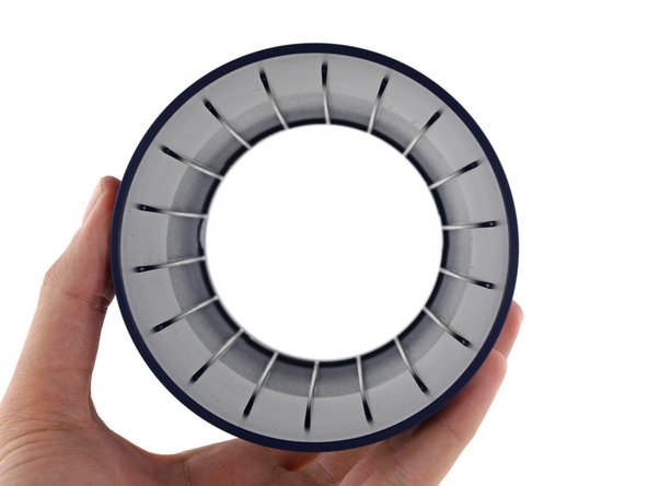

Edit Step 3  ¶
Image 1/3: The ~~rifling~~ fins along the inside of the ~~barrel~~ cowling are perhaps there to encourage air circulation, as this tower has no fan to cool itself.
Edit Step 3  ¶

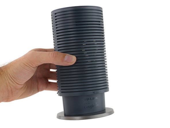

  • Luckily the outer cowling comes off with a simple twist. You can't plug any cables in without shucking that shield, it better be simple.
  • The rifling fins along the inside of the barrel cowling are perhaps there to encourage air circulation, as this tower has no fan to cool itself.
  • Under the hood we see the real branding on this guy. Google has contracted with TP-Link for the first iteration of the OnHub.
  • We also get a peek at some components. Is that an antenna we see? We're itching with anticipation.

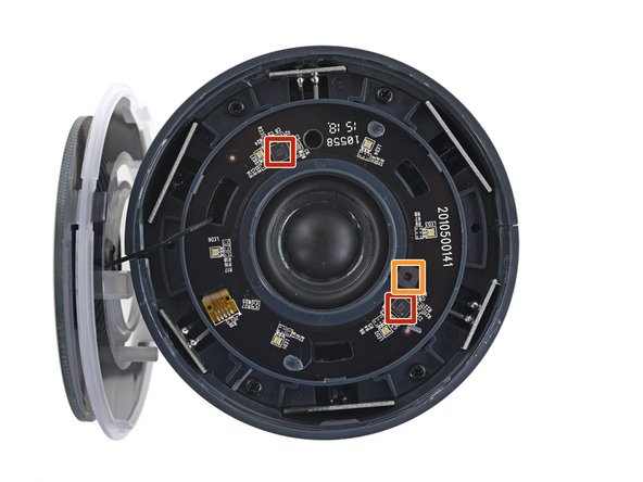

Image 1/3: We really wish this thing came with a repair manual—this cap ''should'' have been the first to go.
Edit Step 5  ¶
  • We turn our attention back to what we thought was a solid top, it turns out this was the way in all along.
    • We really wish this thing came with a repair manual—this cap should have been the first to go.
  • We finally pop the top off this can of worms, and the first component we spy is the famed congestion-sensing antenna.
  • We can't quite remove it yet, so leaving that to dangle gently to the side exposes the LED board with some control hardware:
    • National Semiconductor LP5523 programmable 9-output LED driver
    • Ambient light sensor

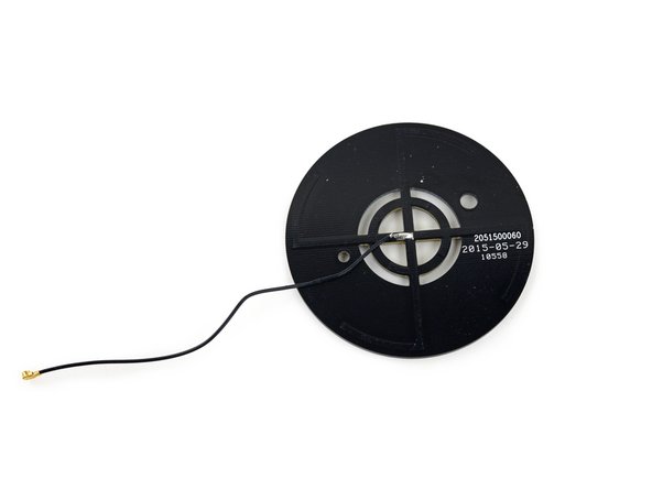

  • That crazy disk antenna up top, responsible for sniffing out network congestion in the air, is finally free to leave the OnHub.
    • Looks like the OnHub intends to keep unbroken Wi-Fi on target with this bullseye shaped antenna.

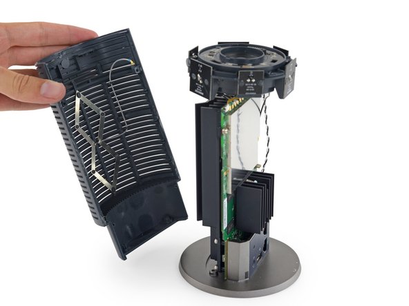

  • There are 12 cables across the top of the device (six 2.4GHz antennas and six 5GHz), plus the congestion antenna along the side, and a final coax cable along the other side.
    • Google seems to have some kind of color coding system, which might help for repair, but the board markings don't give us any hints just yet.
  • Peeling off the second half of the outer shell, we find an interesting antenna arrayed in a double diamond. More on this guy later.
  • The OnHub's antenna array is revealed in all its Lovecraftian glory, the antenna leads looking spookily like tentacles.

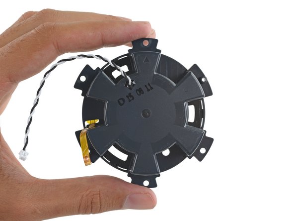

2 Edit Step 8  ¶
Image 1/3: Look at that enormous speaker. [http://www.amazon.com/Amazon-SK705DI-Echo/dp/B00X4WHP5E|Alexa], why does Google's router need a 3-watt speaker?
2 Edit Step 8  ¶
  • With a dozen connectors dispatched, we can finally separate the antenna assembly from the motherboard.
  • Look at that enormous speaker. Alexa, why does Google's router need a 3-watt speaker?
    • Turns out, OnHub uses a loud tone to pair with ultrasonic tones to configure Android devices running Google's companion app—but will it feature sick beats in the future?
  • The hexagonal speaker enclosure has disturbing similarities to the Galactic Empire's logo.

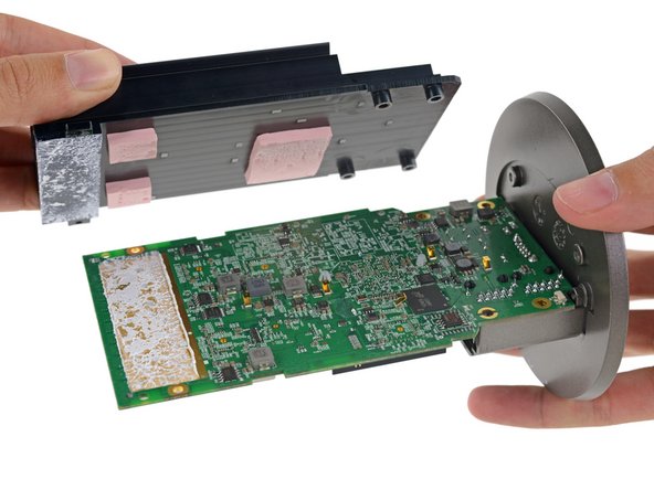

Edit Step 10  ¶
Image 1/3: The heatsink serves as a reflector dish, pushing that extra bit of Wi-Fi to the far corner of your house where you need it most.
Edit Step 10  ¶
  • Remember that diamond shaped antenna a few steps back? Turns out that's the directional antenna, for boosting the signal in a specific direction.
    • The heatsink serves as a reflector dish, pushing that extra bit of Wi-Fi to the far corner of your house where you need it most.

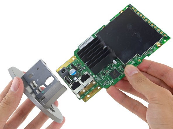

  • The components in this thing have been pretty big so far, and the heat sink is no different. Prying up the metal mass reveals some equally hefty thermal pads.
  • It looks like the heat sink actually draws heat through the motherboard—we spy the real heavy hitters heaters on the reverse.
  • The plastic base and port cover slides off and the motherboard is free!

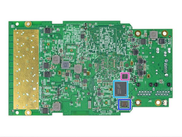

Edit Step 12  ¶
Image 1/2: Skyworks SKY2623L 2.4 GHz WLAN power amplifier
Edit Step 12  ¶
  • But wait, there's more!
    • Skyworks SKY2623L 2.4 GHz WLAN power amplifier
    • Skyworks SKY85405 802.11ac 5 GHz WLAN power amplifier
    • Atheros 3012-BL3D Bluetooth radio
    • Bluetooth antenna
    • Micron MTFC4GACAAAM 4 GB NAND flash
    • Micron 25Q064A 64 Mb SPI flash
    • Infineon SLB9615 Trusted Platform Module
Edit Step 13  ¶
Image 1/1: The speaker is replaceable.
Edit Step 13  ¶
  • OnHub Repairability Score: 4 out of 10 (10 is easiest to repair)
    • The speaker is replaceable.
