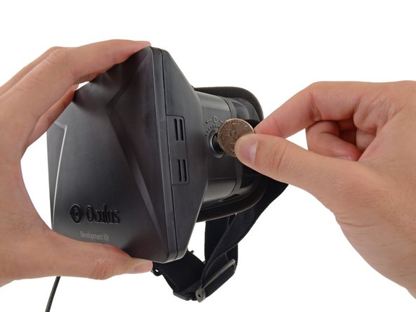

  • Before we crack into the device, we can't help but play around with it a bit!

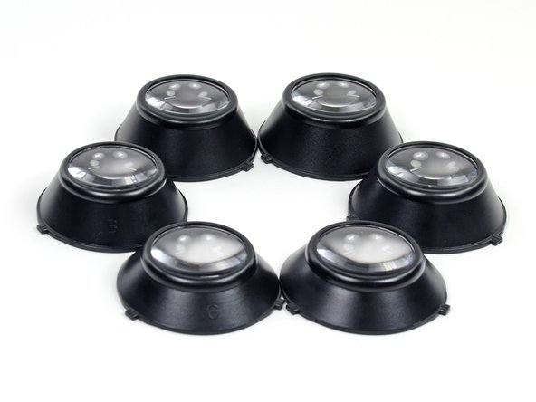

  • Using a shiny cupronickel coin, we adjust the focal lengths on either side of the Rift to optimize it for our 3D viewing pleasure.
  • We're ready to play. Bring it on, Team Fortress 2!
    • Nope, not just yet.

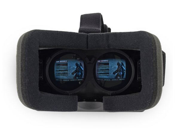

    • Apparently we have to choose either A cups, B cups, or C cups for our eyes. Then we have to measure our IPD (inter-pupillary distance), and put TF2 into VR mode.
    • A couple of hours later, we're ready to play. Bring it on, Team Fortress 2!

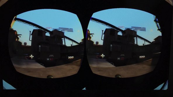

  • Check it out! Wearing the Rift allows one eye to see the image on the left, while the other eye sees the image on the right. As it turns out, the 3D effect of the Rift is not actually magic, but science!
  • If you look closely, you can see that the left-hand image is framed slightly to the right, and vice versa. Our brains—fantastic computers that they are—note the disparities between the images in each eye, calculate the angles and dimensions, and merge them into a single image with perceptible depth.
  • Prest-o blam-o! 3D rockets flying past our n00b heads.

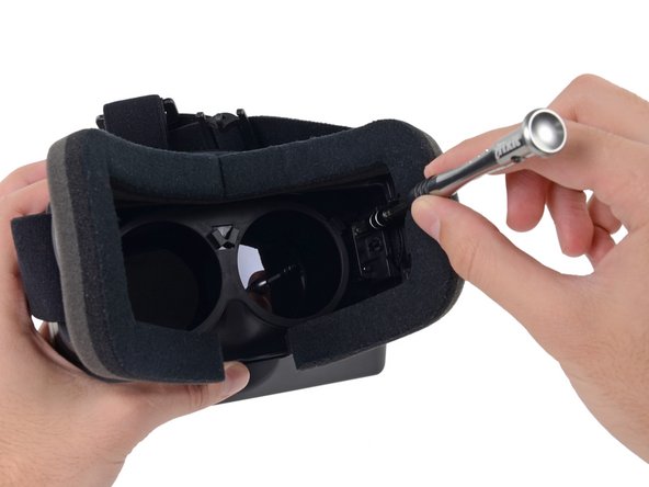

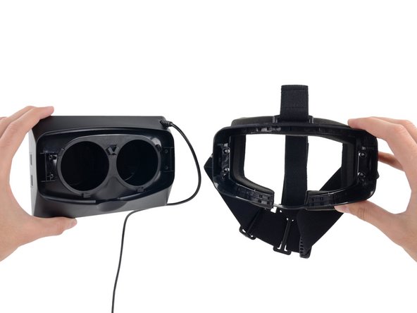

Image 1/3: Does the fact that this isn't the final production version of the Rift have anything to do with it being easy to take apart? Perhaps -- only time will tell. Image 2/3: Will the final consumer version be more difficult to get into? We hope not. Image 3/3: Will the final consumer version be more difficult to get into? We hope not.
  • In order to separate the display from the strap assembly, all we need is the Phillips #1 bit from our 54 Bit Driver Kit.
  • Does the fact that this isn't the final production version of the Rift have anything to do with it being easy to take apart? Perhaps -- only time will tell.
    • Will the final consumer version be more difficult to get into? We hope not.

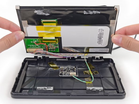

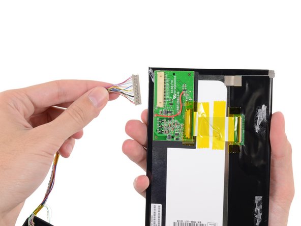

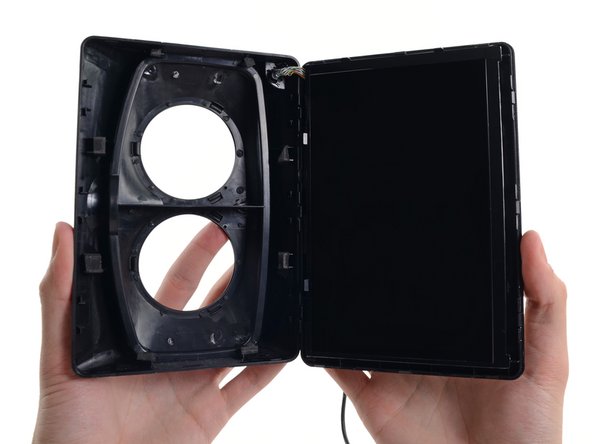

Image 1/3: Disconnecting one cable from the display assembly allows us to completely remove it for further examination. Image 2/3: Disconnecting one cable from the display assembly allows us to completely remove it for further examination. Image 3/3: Disconnecting one cable from the display assembly allows us to completely remove it for further examination.
  • A couple of clips and some sticky foam adhesive hold the display securely into the front panel of the Oculus, ensuring a firm grip on the screen while you're whipping your head around in-game.
  • Disconnecting one cable from the display assembly allows us to completely remove it for further examination.

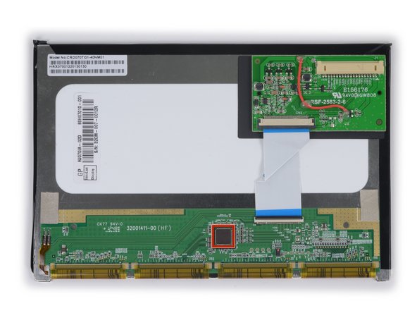

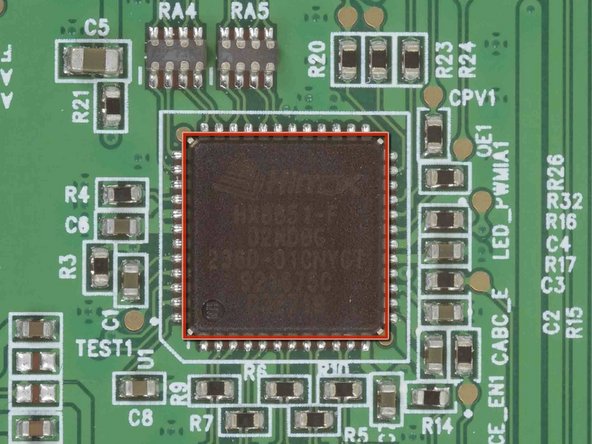

Image 1/2: [http://en.wikipedia.org/wiki/Chimei_Innolux_Corporation|Chimei Innolux|new_window=true] is Taiwan's largest LCD manufacturer and  [http://appleinsider.com/articles/13/03/28/apple-said-to-drop-samsung-turn-to-innolux-for-ipad-mini-displays|is rumored|new_window=true] to be a replacement source for Apple's iPad Mini screens. Image 2/2: The back of the LCD hosts a Himax [http://www.himax.com.tw/en/product/pd111.asp|HX8851|new_window=true] timing controller.
  • Great News! The Oculus uses an Innolux HJ070IA-02D 7" LCD.
    • Chimei Innolux is Taiwan's largest LCD manufacturer and is rumored to be a replacement source for Apple's iPad Mini screens.
  • The back of the LCD hosts a Himax HX8851 timing controller.

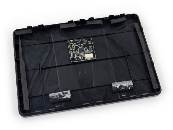

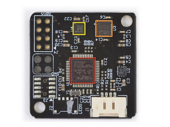

Image 1/3: Here we find the chips controlling the revolutionary head-tracking device: Image 2/3: STMicroelectronics [http://www.st.com/web/en/catalog/mmc/FM141/SC1169/SS1031/LN1565/PF164476|32F103C8|new_window=true] ARM Cortex-M3 microcontroller with 72 MHz CPU Image 3/3: Invensense [http://www.invensense.com/mems/gyro/mpu6050.html|MPU-6000|new_window=true] six-axis (gyro + accelerometer) motion tracking controller
  • The final component out of the headset is the Oculus Tracker V2 board, custom designed and optimized for a 1000 Hz refresh rate.
  • Here we find the chips controlling the revolutionary head-tracking device:
    • STMicroelectronics 32F103C8 ARM Cortex-M3 microcontroller with 72 MHz CPU
    • Invensense MPU-6000 six-axis (gyro + accelerometer) motion tracking controller
    • Honeywell HMC5983 three-axis digital compass, probably used in conjunction with the accelerometer to correct for gyroscope drift
  • The back of the sensor board is covered in shiny contact points, presumably for easily testing each board in a spring contact rig.
The A983 three-axis magnetometer is the Honeywell HMC5983:
http://www.digikey.com/product-detail/en...
C C Tan - Reply

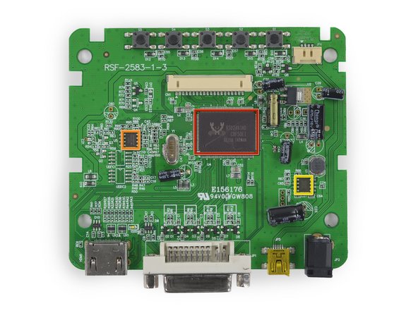

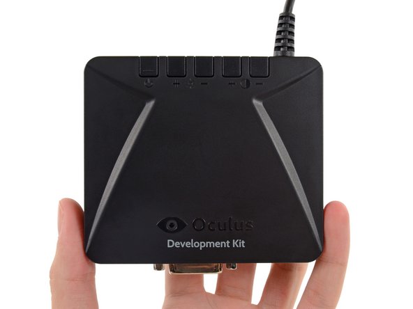

Image 1/2: Our Development Kit control box is a pretty basic device, consisting of buttons for adjusting the Rift's settings and a handful of I/O ports. Image 2/2: From left to right: HDMI, DVI, Mini USB, and DC-in.
  • How does the Oculus Rift hook up to your PC, you ask? With the control box, of course.
  • Our Development Kit control box is a pretty basic device, consisting of buttons for adjusting the Rift's settings and a handful of I/O ports.

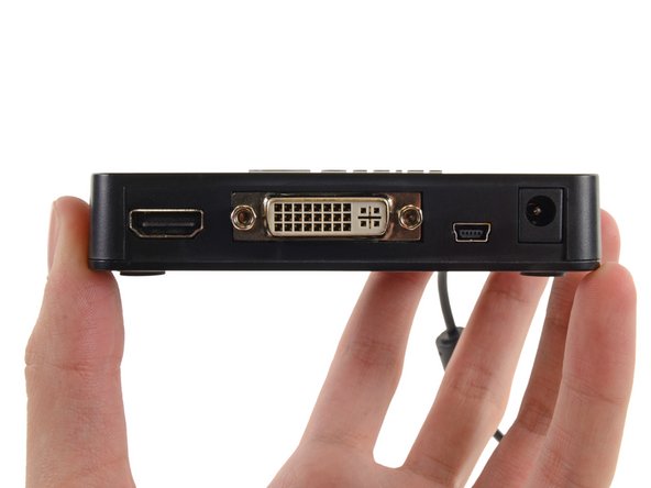

  • From left to right: HDMI, DVI, Mini USB, and DC-in.
    • Video input to the Oculus Rift is DVI, but the handy dandy control box is capable of converting your PC's HDMI output to DVI. VGA is not supported at this time.

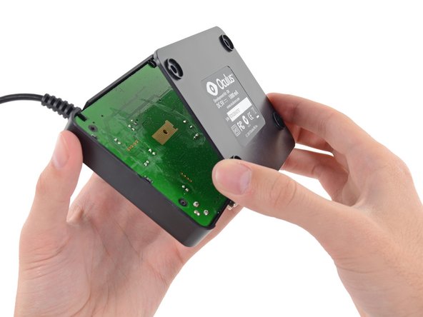

Image 1/2: Oculus could have simply glued the control box shut rather than securing it with screws and a removable panel. This design goes to show that even devices of the future can be easily accessible. Image 2/2: The main chips on the control box motherboard:
  • Just like its headset counterpart, the control box opens up after removing four Phillips #1 screws.
    • Oculus could have simply glued the control box shut rather than securing it with screws and a removable panel. This design goes to show that even devices of the future can be easily accessible.
  • The main chips on the control box motherboard:
    • Realtek RTD2483AD display interface controller
    • Winbond W25X20CL 256 KB serial flash
    • Techcode TD1484A synchronous rectified step-down converter

I have a Dell M6400 with only a VGA (female) out, would a DVI adapter work? Any Suggestions?
Are the cables/connections provided female/male? DVI-D, DVI-A, or DVI-I?
hello - Reply
You would need something like this:
http://www.datapro.net/products/vga-to-d...
It requires a converter with active electronics; a passive adapter would not work.
A different rev. of the Rift might support analog input, but this one does not appear to have the signals hooked up (based on what I can see, which isn't quite enough).
cityzen -
Thank you for the confirmation cityzen! and for the recommendation.
a digital converter is a pricey addition, do you think a USB2.0 to HDMI adapter (http://www.amazon.com/Sabrent-1920x1080-...) could be a more economical option?
or maybe an ExpressCard or PCMCIA card would provide the necessary bandwidth? But don't see many offerings.
hello -
A USB2.0 adapter would not be suitable for fast-action video. I wouldn't count on the other options, either. You can find cheaper adapters than the one I pointed out, which was just the first I happened to come across. Another example is: http://www.ambery.com/2covivgatodv.html
Actually, looking at the specs for your notebook, you should have a DisplayPort, and you can get a cheap adapter from that to DVI-D.
cityzen -
cityzen, you are a gentleman and a scholar. my thanks go out to you!
hello -
