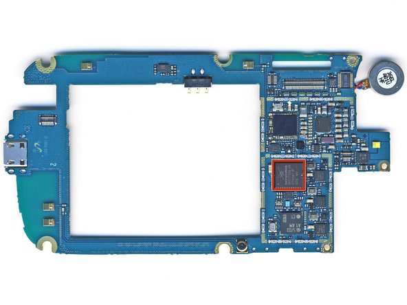

Taking out the motherboard requires removing three Phillips screws and disconnecting a few cables here and there. The design of the motherboard is peculiar to us. It is designed such that its inner perimeter encloses the battery. We've seen oddly-shaped PCBs before, but rarely do they have giant holes in the middle of them.
  • Taking out the motherboard requires removing three Phillips screws and disconnecting a few cables here and there.
  • The design of the motherboard is peculiar to us. It is designed such that its inner perimeter encloses the battery. We've seen oddly-shaped PCBs before, but rarely do they have giant holes in the middle of them.
Can you be more specific on "few cables". =D
Victor Araujo
Victor Araujo - Reply
We are more specific when we write repair guides. However, as we state above, "teardowns provide a look inside a device and should not be used as disassembly instructions."
David Hodson -
Just changed my screen according to this guide. There were two cables.
Thomas Mardh
vajsing -

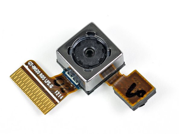

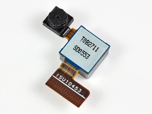

Much like the Samsung Galaxy S, the Nexus S features both a rear and front-facing camera. Interestingly, the two cameras share the same connector on the motherboard and can be removed as a singular unit.
  • Much like the Samsung Galaxy S, the Nexus S features both a rear and front-facing camera.
  • Interestingly, the two cameras share the same connector on the motherboard and can be removed as a singular unit.
  • The front-facing VGA camera provides a resolution of 640 x 480 pixels.

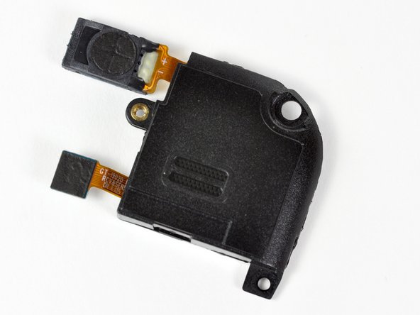

The EM-Tech EME1511AFRC integrates the earpiece speaker, loudspeaker for speakerphone and media use, and a sensor bank all into one unit with a singular shared data connector. This is definitely a win for integration, but at the same time forces users to replace the entire unit if only one component malfunctions.
  • The EM-Tech EME1511AFRC integrates the earpiece speaker, loudspeaker for speakerphone and media use, and a sensor bank all into one unit with a singular shared data connector.
  • This is definitely a win for integration, but at the same time forces users to replace the entire unit if only one component malfunctions.
This component is actually two distinct components which are sold seperately. Is the sensor bank housed inside the plastic box with the loudspeaker, or attached to the flex ribbon cable along with the proximity sensor and earpiece?
Jerome C - Reply
Big players on the motherboard include: Skyworks SKY77529 Tx Front-End Module for Dual-Band GSM / GPRS / EDGE
  • Big players on the motherboard include:
    • Skyworks SKY77529 Tx Front-End Module for Dual-Band GSM / GPRS / EDGE
    • SanDisk SDIN4C2 16GB MLC NAND flash.
    • Samsung KB100D00WM-A453 memory package and S5PC110A01 1GHz Cortex A8 Hummingbird Processor.
    • Infineon 8824 XG616 X-Gold baseband processor
    • Wolfson Microelectronics WM8994 ultra-low power audio codec.

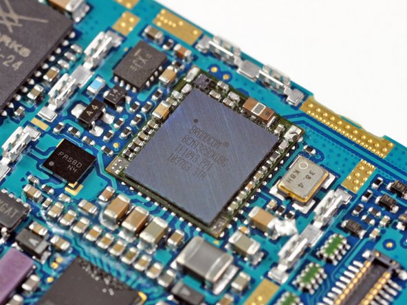

Hidden underneath an EMI cover is the Broadcom Wi-Fi chip.
  • Hidden underneath an EMI cover is the Broadcom Wi-Fi chip.
  • The chip reads: BCM4329GKUBG TE1043 P21
  • According to UBM Techinsights, the chip is a low-power package with 802.11n, Bluetooth 2.1, and FM capability.
  • Variants of this chip have been around for over a year. We first saw it used in the 3rd generation iPod Touch.

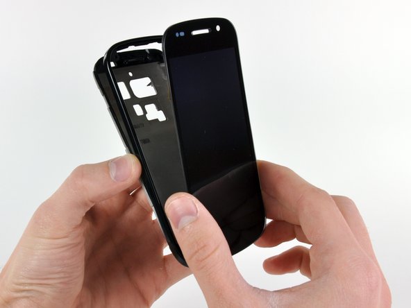

Removing the display presented us with the first stumbling block in our disassembly. A heat gun made quick work of the front case assembly, though. Removing the display presented us with the first stumbling block in our disassembly. A heat gun made quick work of the front case assembly, though.
  • Removing the display presented us with the first stumbling block in our disassembly. A heat gun made quick work of the front case assembly, though.
what heat gun would be good to use??
christian gonzalez - Reply
Could you go into more detail on step 12? Where do I have to heat and where to put in the opening tool? Is it glued together?
srinne - Reply

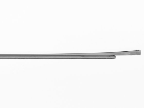

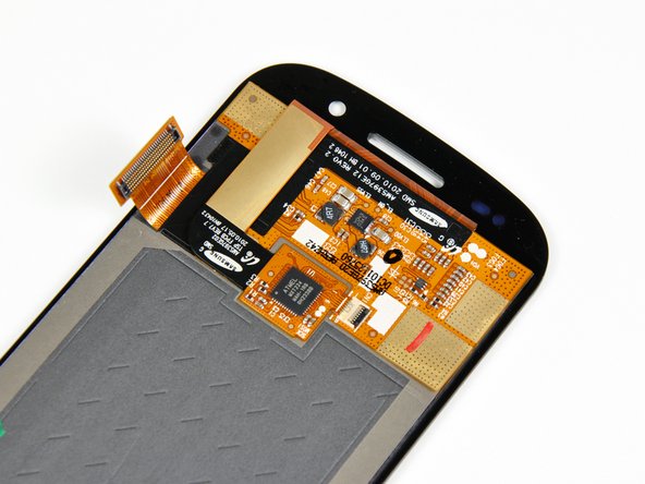

Here you can see a side view of the Super AMOLED display and front glass panel. The Super AMOLED is attached to the front glass. The digitizer is a PET layer between the glass and the display.
  • Here you can see a side view of the Super AMOLED display and front glass panel.
  • The Super AMOLED is attached to the front glass. The digitizer is a PET layer between the glass and the display.
  • You can definitely see that only the front glass panel is curved. The rest of the components are flat as a board, just as any other phone on the market.
  • Google describes it as a "...curved glass screen...", however that may be misconstrued to mean a curved Super AMOLED display, which is a bit misleading.
  • There's also a small PCB on the back of the display with an Atmel MXT224 touchscreen controller on it.

Hint for Step 9: The earpiece-ribbon-cable-assembly and loudspeaker are actually two separate pieces, you can buy each one individually (e.g. on ebay).
