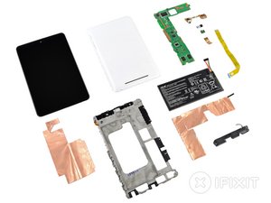

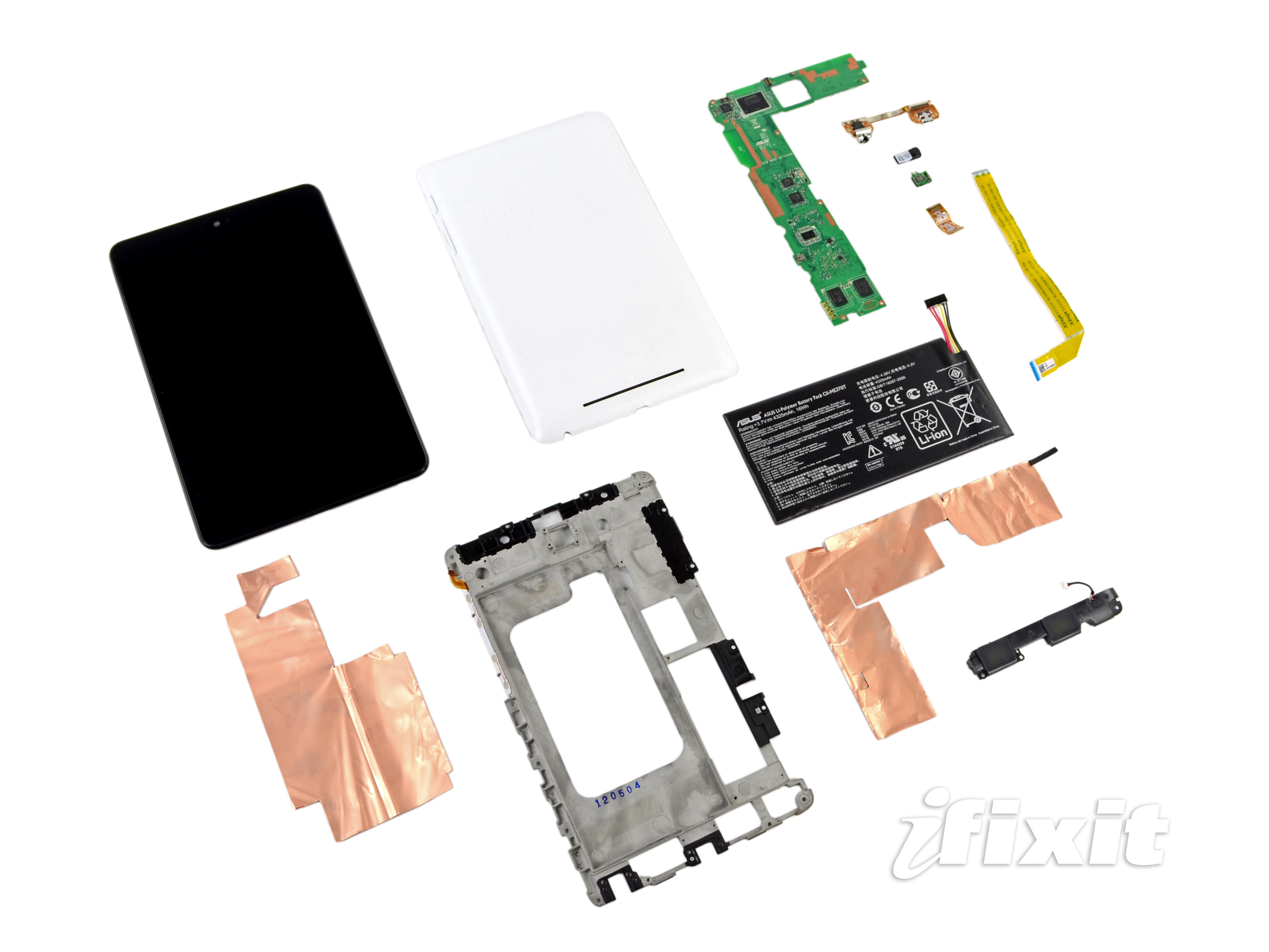

Image 1/2: Nexus 7 Repairability Score: '''7 out of 10''' (10 is easiest to repair)
Edit Step 21  ¶
  • Nexus 7 Repairability Score: 7 out of 10 (10 is easiest to repair)
  • The rear case is very easy to open, and requires minimal prying effort with a plastic opening tool to remove.
  • All fasteners inside are Phillips #00 screws—no security or proprietary screws here.
  • Battery replacement can be accomplished without soldering—or even a screwdriver.
  • Many components, including the I/O ports, can be replaced independently of the motherboard.
  • Copper alloy sheets provide convenient shielding, but they could tear during disassembly.
  • The LCD does not separate from the display glass, increasing repair costs.

Could you add a tag in the pic for which antenna is located in which spot, pretty please?
Aaron Parish, · Reply
I color-coded it just for you, buddy.
Here's the marked-up image.
