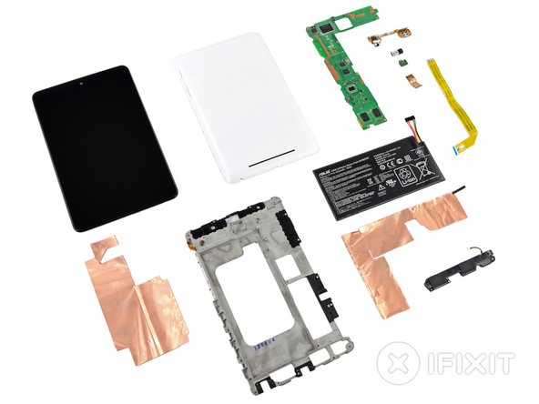

Here she is, the motherboard:
  • Here she is, the motherboard:
    • NVIDIA T30L Tegra 3 processor
    • Hynix HTC2G83CFR DDR3 RAM
    • Max 77612A inverting switching regulator
    • AzureWave AW-NH665 wireless module
    • Broadcom BCM4751 integrated monolithic GPS receiver
    • NXP 65N04 Integrated NFC Chip
    • Invensense MPU-6050 gyro and accelerometer

On the flipside:
  • On the flipside:
    • Kingston KE44B-26BN/8GB 8GB flash
    • Realtek ALC5642
    • ELAN eKTF36248WS EKTF3624 series 16-bit touch panel signal processor MCU
    • ELAN eKTH10368WS EKTH1036 series touch panel controller

Nexus 7 Repairability Score: 7 out of 10 (10 is easiest to repair) The rear case is very easy to open, and requires minimal prying effort with a plastic opening tool to remove.
  • Nexus 7 Repairability Score: 7 out of 10 (10 is easiest to repair)
  • The rear case is very easy to open, and requires minimal prying effort with a plastic opening tool to remove.
  • All fasteners inside are Phillips #00 screws—no security or proprietary screws here.
