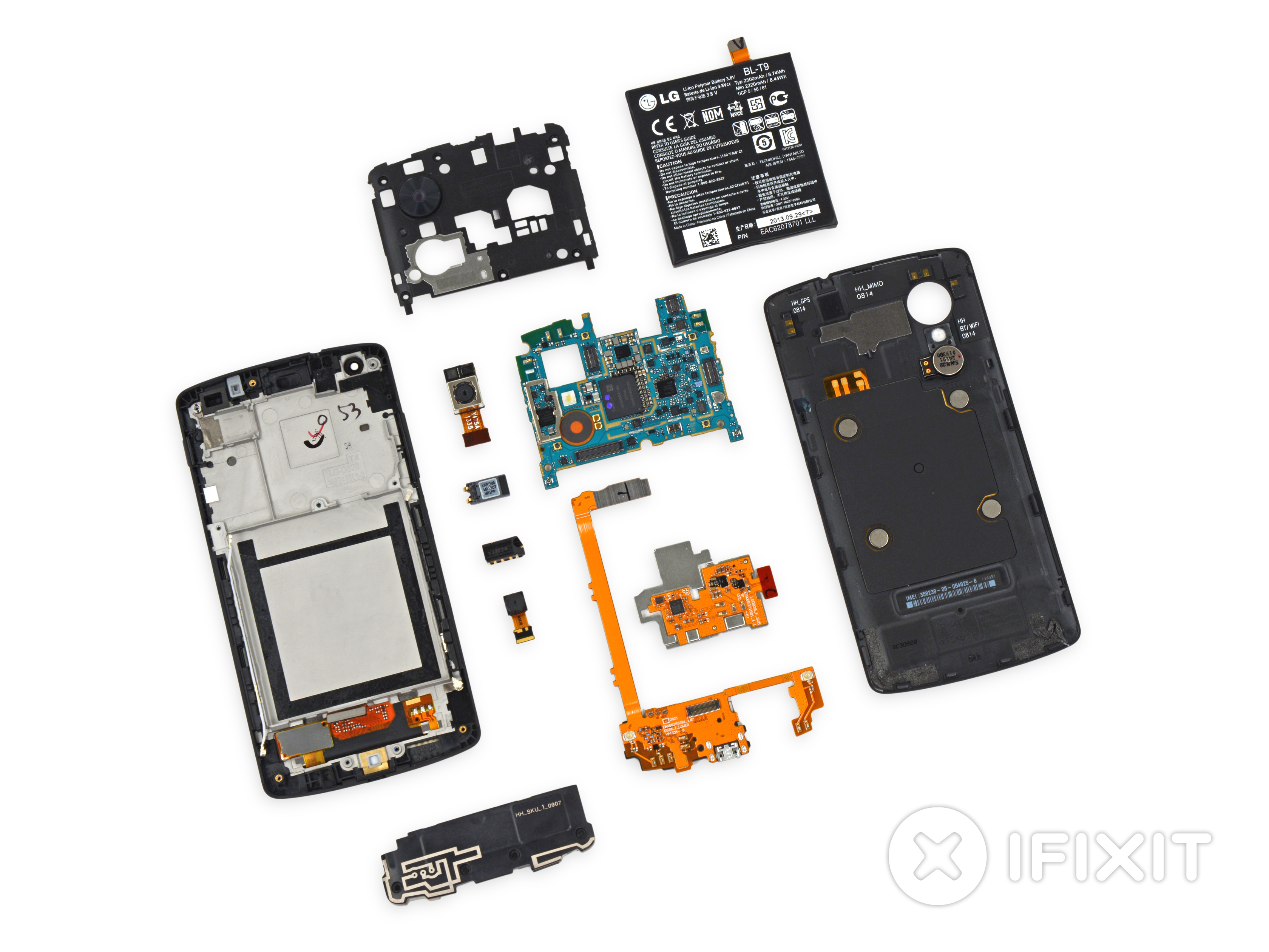

Edit Step 1 Nexus 5 Teardown  ¶
  • The Nexus 5 is the first phone to ship with the latest version of Android's OS, KitKat. It may not be coated in chocolate, but it has plenty of tasty features:
    • 4.95" full HD 1920x1080 display at 445ppi
    • Quad-core, 2.26 GHz Snapdragon 800 processor and 450 MHz Adreno 330 GPU
    • 2 GB RAM
    • 8 MP/1080p rear camera with optical image stabilization, and 1.3 MP front-facing camera
    • 4G/LTE wireless support, 802.11 a/b/g/n/ac (2.4GHz and 5GHz) dual-band Wi-Fi, NFC, Bluetooth 4.0, and wireless charging
    • 16 GB or 32 GB built-in memory
    • Android 4.4 KitKat
Image #1
Edit Step 2  ¶
  • Sounds of joy emanate from the teardown factory as we find this Nexus is held together by…plastic clips!
    • These clips are plenty stubborn, but nothing like the headache that a glued panel would be.
  • Agent P.O.T. (plastic opening tool) is deployed to handle this noble mission.
Image #1
Edit Step 3  ¶
  • We may have cheered too soon—either someone spilled some chocolate syrup, or that's adhesive securing the bottom of the case.
    • Finding glue in your gadget is as much fun as finding chewed gum on your shoe.
  • Luckily this bit of foam adhesive is no match for a few swipes of a plastic opening pick. Our poor fixer souls have seen much worse recently.
  • With the adhesive out of the way, we get our first peek inside this delicious new device.
Image #1
Edit Step 4  ¶
  • Before taking another bite, we pause to chew over the back case:
    • We find conveniently labeled antennas for the Wi-Fi, MIMO, and GPS. It's not quite instructions, but hey, we'll take what we can get.
    • The NFC and wireless charging cables' spring contacts aren't so nicely identified, but are present and accounted for.
    • The vibrator is held in place with only a small amount of adhesive. That means an easy repair, should your phone lose its ability to shake it up.
  • How many licks screws does it take to get to the center of a Nexus 5?
Edit Step 5  ¶
  • Google gives us the Goldilocks of glue: It's just enough to hold the battery in place, but not too much—the battery can still be removed with minimal prying and virtually no bending.
  • Non-LG manufacturers, take note! We don't want none of your "that ain't possible" funny business when it comes to using glue in devices.
Image #1
Edit Step 6  ¶
  • LG's 3.8 V, 2300 mAh battery offers a slight jump in capacity over last year's Nexus 4.
  • Google boasts that this pack will keep you sugar-high for 17 hours of talk time, 300 hours of standby, or 7 hours of LTE web browsing.
  • We're pretty sure this warning icon indicates that it's unsafe to let pets smaller than this battery anywhere near it.
Image #1
Edit Step 7  ¶
  • Time to break us off a piece of this KitKat phone!
  • The speaker pops out with minimal fuss; it's only secured by few screws and no cables. This is the Nexus standard single speaker, despite the dual grilles.
    • No, this Nexus is not preparing for a BBQ—the second grille is for the microphone. Don't worry; we'll get there soon.
Image #1
Edit Step 8  ¶
  • We free the Oompa-Loompa-colored daughterboard, and she's got more goodies than the Easter Bunny:
    • Microphone
    • RGB Indicator LED
    • Micro-USB port
    • Speaker spring contacts
    • Antenna spring contacts
Image #1
Edit Step 9  ¶
  • Less tasty, but more powerful than a Pixy Stick, our spudger makes motherboard removal easier than taking candy from a baby.
  • We quickly spudge away the wireless charging control and NFC board. LG built this little board into an EMI shield assembly that pops in right over the motherboard.
  • NFC is the tech behind Google Wallet—one of the Nexus devices' most loved features and one often blocked by carriers. Last month, the rumor mill speculated that the Nexus 5 would feature a Broadcom NFC controller that could eliminate carriers' ability to wallet-block customers.
    • Lo and behold: the Broadcom BCM20793M NFC controller.
Image #1
Edit Step 10  ¶
  • That's some scrumptious silicon! Feast your eyes on these ICs:
    • Sandisk SDIN8DE4 16 GB NAND flash
    • Qualcomm WTR1605L LTE/HSPA+/CDMA2K/TDSCDMA/EDGE/GPS transceiver
    • Qualcomm PM8841 power management IC
    • Broadcom BCM4339 5G Wi-Fi combo chip with integrated power and low-noise amplifiers (the updated version of the BCM4335).
    • Avago RFI335
    • InvenSense MPU-6515 six-axis (gyro + accelerometer) MEMS MotionTracking device
    • Asahi Kasei AK8963 3-axis electronic compass
Image #1
Edit Step 11  ¶
  • SK Hynix H9CKNNNBPTMRLR-NTM 2 GB LPDDR3-1600 RAM
    • The Quad-core, 2.26 GHz Snapdragon 800 SoC is layered beneath the RAM
  • Qualcomm WCD9320 audio codec
  • Analogix ANX7808 SlimPort transmitter
  • Qualcomm PM8941 power management IC
  • Texas Instruments BQ24192 I2C controlled 4.5 A USB/adapter charger
  • Avago ACPM-7600 Multi Mode, Multi Band RF power amplifier
  • Qualcomm QFE1100 Envelope Tracking IC
Image #1
Edit Step 12  ¶
  • Out next is the 8MP rear-facing camera.
  • Google has taken some criticism for the less-than-impressive image capture in last year's candy-powered devices. This year they've added Optical Image Stabilization (OIS), but we've only heard tepid reviews so far.
    • The Nexus 5's OIS is powered by an InvenSense IDG-2020 dual axis gyroscope.
Image #1
Edit Step 13  ¶
  • We pop out the last of the bite-sized morsels in the Nexus 5:
    • Earpiece speaker
    • Headphone jack
    • 1.3 MP front-facing camera.
  • What a treat! These components were modular and only lightly adhered, seasoned just to our repair tastes.
Image #1
Edit Step 14  ¶
  • Unfortunately, our hopes come crashing down like a blood sugar crash after a candy binge: the front panel is one fused flustercluck.
  • While we saw this in the Nexus 4, we had hoped the LG/Google team could learn the error of their ways.
  • Alas, the front frame, LCD, and glass are doomed to a single shared death sometime down the road to Candy Land.
    • Imagine if one cavity meant losing all your teeth... Talk about a hard pill to swallow.
  • Tucked in at the base of the display, a Synaptics S3350B IC provides touchscreen control.
Image #1
Edit Step 15  ¶
  • Nexus 5 Repairability Score: 8 out of 10 (10 is easiest to repair).
  • Very modular design allows independent replacement of several wear-prone components—like the headphone jack and speakers.
  • Only very mild adhesive holds the battery in place, making it fairly easy to safely remove and replace.
  • Standardized screws (ten identical #00 Phillips) simplify repairs and reassembly.
  • The back cover is held in place with plastic clips. Sturdy and rather difficult to remove, but easier than glue.
  • The glass and LCD are fused to the display frame. Fixing broken glass will be either expensive or very difficult.
