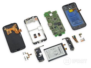

Edit Step 1 Motorola Moto X Teardown  ¶
Image 1/2: The love child of Motorola and Google is here, and we are dying to crack open the little Motoroogle.
  • The love child of Motorola and Google is here, and we are dying to crack open the little Motoroogle.
  • Technical Specifications:
    • Dual-core 1.7 GHz Qualcomm Snapdragon S4 Pro processor
    • 2 GB RAM
    • 4.7-inch 1280x720 pixels AMOLED display
    • 16 or 32 GB internal storage
    • Qualcomm Adreno 320 GPU
    • 10 MP rear-facing camera

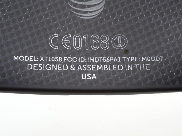

Image 1/3: The top of the Moto X houses the centered headphone jack. We haven't seen this placement on too many recent smartphones.
Edit Step 2  ¶
  • The top of the Moto X houses the centered headphone jack. We haven't seen this placement on too many recent smartphones.
  • Does it make more sense than a headphone jack on the bottom of a phone? Only time will tell…(but yes, it probably makes more sense).
  • Since we tend to have a lot of devices laying around, we might as well do some comparisons! The Moto X is certainly not small, but it is a bit smaller than the S4, and we are fans of the contoured back.
  • This is the first and only smartphone that's "Designed & Assembled in the USA," to our knowledge.

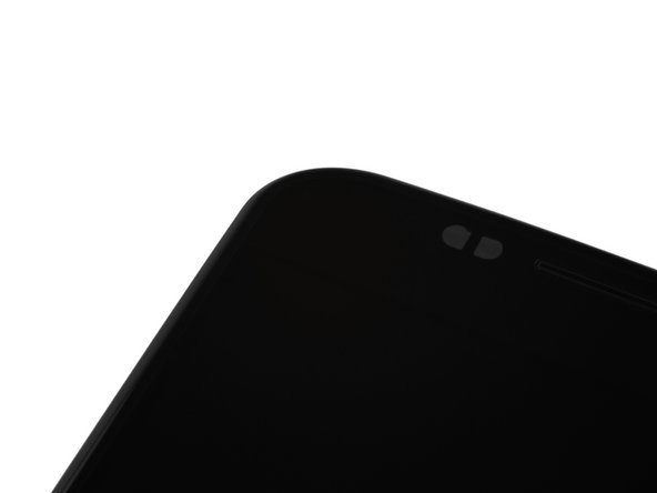

Image 1/2: Our Moto X has a small defect next to the SIM card tray. Hmmmm...
Edit Step 3  ¶
  • Our Moto X has a small defect next to the SIM card tray. Hmmmm...
    • Hopefully this sort of flaw will be limited to the first run phones, and my custom teal model will be made with a little more care.
  • Using the fancy SIM eject tool provided by Motoroogle, we remove the SIM card tray from the side of the device.
  • We're interested to see the internal layout of this device, with so many components lined up along the center.

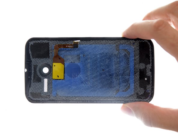

Image 1/3: Even after defeating Big Blue, the rear panel still does not yield.
Edit Step 6  ¶
  • Even after defeating Big Blue, the rear panel still does not yield.
  • We release the ZIF connector of a big ol' rear-case-mounted flash assembly, and after 6 full steps, we are finally into the device.
    • Our guess is that the adhesive pad was added to make the phone feel more solid than one purely secured with clips. The pad also keeps the flash firmly in place, and may act as as padding to protect internal components.
  • Our "Woven Black" case has a nice weave. While it's probably not actual kevlar fibers, the molding makes for a nice view — you can see right through it!

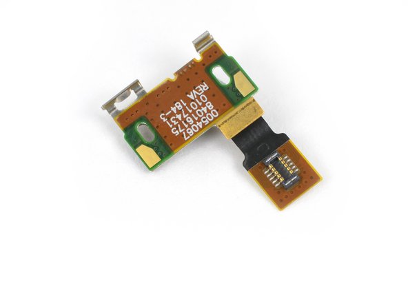

Image 1/3: After selecting our favorite pair of [product|IF145-060|precision tweezers], we remove the 2 MP front-facing camera from the Moto X.
Edit Step 12  ¶
  • After selecting our favorite pair of precision tweezers, we remove the 2 MP front-facing camera from the Moto X.
  • The front-facing camera is labeled as 84016172 REV A 0054067 01017429 142-3.

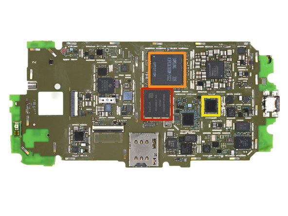

Image 1/1: Notable ICs on the motherboard:
Edit Step 15  ¶
  • Notable ICs on the motherboard:
    • Toshiba THGBMAG7A2JBAIR 16 GB eMMC NAND Flash
    • SK Hynix H9TKNNNBPDAR RAM (we assume that the Snapdragon S4 Pro is also layered under this IC)
    • Qualcomm PM8921 Power Management IC
    • Texas Instruments TMS320C55 Digital Signal Processor
    • NXP 44701 NFC Chip
    • Skyworks 77619-12 Multiband Multimode Power Amplifier Module for Quad-Band GSM / EDGE and Penta-Band (Bands I, II, IV, V, VIII) WCDMA/ HSDPA/ HSUPA/ HSPA+/ LTE
    • Texas Instruments MSP430 F5259 Mixed Signal Microcontroller

Image 1/1: Additional ICs:
Edit Step 16  ¶
  • Additional ICs:
    • Qualcomm WCD9310 Audio Codec
    • Qualcomm WCN3680 802.11ac Combo Wi-Fi/Bluetooth/FM
    • NXP TFA9890 High Efficiency Class-D Audio Amplifier
    • Skyworks 77737 SkyHi™ Power Amplifier Module for LTE Bands 12/17 (698-716 MHz)
    • EPCOS 7959 Wireless LAN/Bluetooth Filters (IF)
    • Qualcomm WTR16505L LTE/HSPA+/CDMA2K/TDSCDMA/EDGE/GPS Transceiver

Image 1/1: '''Teardown update:''' We got ahold of a Verizon version of the Moto-X and played a little game of 'spot the difference' with the motherboard:
Edit Step 17  ¶
  • Teardown update: We got ahold of a Verizon version of the Moto-X and played a little game of 'spot the difference' with the motherboard:
    • SanDisk SDIN8DE2-16G 16 GB NAND Flash replaces the Toshiba
    • Samsung K3PE0E00QM-CGC2 2 GB LPDDR2 RAM instead of SK Hynix
    • The Verizon model adds another Qualcomm modem, the WTR1605 (in addition to the WTR1606L, possibly used solely for LTE support on this model)
