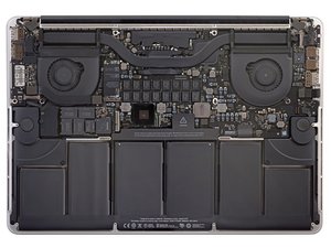

This is it: The Chosen One of MacBook Pros. While other MBPs were gifted only the standard annual updates, this particular model was bestowed with a Retina display, a thinner profile, two Thunderbolt ports, a full sized HDMI port, and less annoying cooling fans. Apple claims that this is the "best computer Apple has ever made."
Apple may have already spilled the beans when it comes to what the inside of this MacBook Pro looks like, but we aren't convinced. Join us today as we set out to see what is so significant about this special MacBook Pro.
Can't get enough teardown? Does an insatiable hunger for gadget guts burn in your belly? Want to be more l33t than your geek counterparts and know about the teardowns as soon as they're live? Follow iFixit on Twitter for the latest updates.
This teardown is not a repair guide. To repair your MacBook Pro 15" Retina Display Mid 2012, use our service manual.
Image 1/2: What is it that's got everyone in the tech world buzzing? Image 2/2: 15.4" LED-backlit Retina display with IPS  with a resolution of 2880 x 1800 at 220 ppi
  • Everyone Mac enthusiasts don't have to wait months anymore to see what's inside the new MacBook Pro.
  • What is it that's got everyone in the tech world buzzing?
    • 15.4" LED-backlit Retina display with IPS with a resolution of 2880 x 1800 at 220 ppi
    • Intel Ivy Bridge Core-i7 processor with Turbo Boost and Intel HD Graphics 4000
    • 8 GB 1600 MHz DDR3L RAM
    • NVIDIA GeForce GT 650M with 1 GB of GDDR5 VRAM

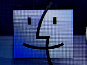

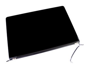

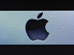

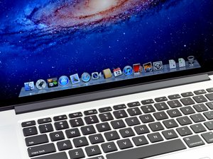

Image 1/3: A bunch of colored, square-ish dots, that's what. Image 2/3: All joking aside, the resolution of this display really is incredible. There's no doubt that the cost to manufacture the Retina display is a big reason for the new MacBook Pro's $2200 (starting) price tag. Image 3/3: All joking aside, the resolution of this display really is incredible. There's no doubt that the cost to manufacture the Retina display is a big reason for the new MacBook Pro's $2200 (starting) price tag.
  • What does an Apple logo or Finder icon made up of 220 pixels per inch look like up close?
    • A bunch of colored, square-ish dots, that's what.
  • All joking aside, the resolution of this display really is incredible. There's no doubt that the cost to manufacture the Retina display is a big reason for the new MacBook Pro's $2200 (starting) price tag.
Is it me or do I see 5 stuck pixels on that small close-up of the screen?
msu320 - Reply
Yeah, stuck pixels, but not on MB display but in CMOS sensor fo the camera probably ;)
Alex -

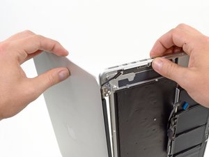

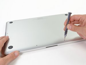

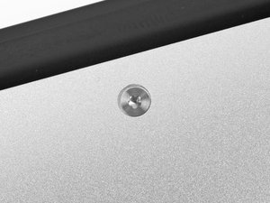

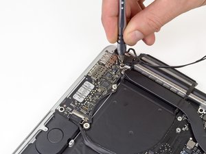

  • We love a challenge, which is good news, because unlike previous generations of MacBook Pros, the MacBook Pro with Retina display is guarded by Apple's proprietary pentalobe screws.
  • We work with bated breath as our pentalobe screwdriver sloughs off a stack of proprietary screws.
  • Finally, we are in!
What size of pentalobe is this?
haloerika - Reply
It's 1.2.
Btw, where are the 3 longest screw located ?
Roberto Sonzogni - Reply

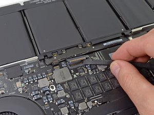

Image 1/2: Two things haven't changed, though: the 7-hour battery life and the pestering reminder that Apple doesn't think you're qualified to service your own battery. Image 2/2: '''Spoiler alert:''' they might be [guide|9462|right|stepid=36209].
  • The new battery packs quite a punch: 95 Wh at 10.95 V compared to last year's puny 77.5 Wh.
  • Two things haven't changed, though: the 7-hour battery life and the pestering reminder that Apple doesn't think you're qualified to service your own battery.
    • Spoiler alert: they might be right.

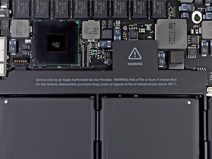

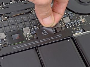

Image 1/2: While Apple seems to have an extensive warning label, it fails to mention potential shocks by failing to disconnect the battery during gadget surgery. Is it possible Apple wasn't expecting us? Image 2/2: While Apple seems to have an extensive warning label, it fails to mention potential shocks by failing to disconnect the battery during gadget surgery. Is it possible Apple wasn't expecting us?
  • It's always a good idea to disconnect the battery when gutting your gadgets.
  • While Apple seems to have an extensive warning label, it fails to mention potential shocks by failing to disconnect the battery during gadget surgery. Is it possible Apple wasn't expecting us?
"While Apple seems to have an extensive warning label, it fails to mention potential shocks by failing to disconnect the battery during gadget surgery. Is it possible Apple wasn't expecting us?"
Actually, I think they did. :)

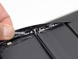

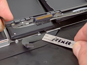

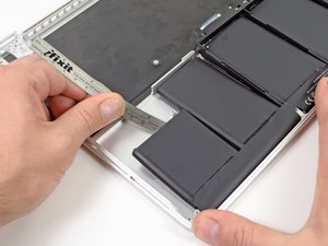

Image 1/2: ''Horrible News''. Apple chose to use the dreaded g-word: '''glue'''. Image 2/2: We're going to move on to more accessible components first, and then come back to the battery.
  • Great news. The battery is no longer screwed into the machine.
  • Horrible News. Apple chose to use the dreaded g-word: glue.
  • We're going to move on to more accessible components first, and then come back to the battery.

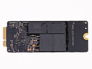

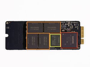

  • Now we are getting to the good stuff, starting with the SSD. We found a 512 GB Samsung flash memory module.
  • The chips are marked:
    • Samsung S4LJ204X01 3-core ARM SSD controller chip - revision seems newer than 830-series SSD
    • Samsung 213 K9UHGY8U7A 20nm MLC NAND chips
    • Samsung 201 K4T263140F 256MB DDR2-800 cache memory
  • Proprietary flash memory is nothing new to Apple. It is, however, new to the MacBook Pro lineup.
This is the same SSD controller used in the Samsung 830. This is a very good thing. I remember seeing a Toshiba SSD module as well which I think uses a Sandforce controller. Performance characteristics are a bit different. I wonder when one is used over the other.
Joon Park - Reply
Is this SSD compatible with the one in Air 2012?
Thanks.
Jon - Reply
The chip number on the RAM is K4T2G314QF-MCF7 (Q, not 0, as noted in Step 10)
These part numbers also noted in my news post here (linking back to you guys):
http://www.pcper.com/news/Storage/New-Ma...
My performance review of the Samsung 830 Series, for those interested:
http://www.pcper.com/reviews/Storage/Sam...
I'm thrilled to see such a great controller in the new MacBooks!
Best,
Allyn Malventano
Storage Editor, PC Perspective
Allyn Malventano - Reply
The SSD card is using a standard mSATA connector and layout. The size of the board is proprietary, but the pinout and the signal standards are maintained.
So, it's possible to build a replacement SSD for the macbook pro Retina. I expect our friends at OWC and others to start making 512, 768 and 1024GB upgrades available. Perhaps faster, since they have shown they have access to the same high-speed controllers and chips.
-M
Martin Bogomolni - Reply
Is it confirm that the physical size of SSD in R-MBP is the same as MBA? If so, that will be a good news for replace or upgrade.
Tembo Hu -
K9UHGY8U7A is the same 25nm MLC NAND as in the Samsung 830.
As others noted, the controller is also identical to the 830 (The MCX). Not a newer revision.
Samsung new NAND in the 840 is 21nm. There is no such thing as 20nm NAND from Samsung.
The 21nm MLC is K9HFGY8U5A
and the TLC is K9CFGY8U5A
Just want to avoid spreading wrong information
Anh Man Tran - Reply

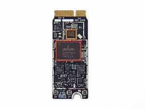

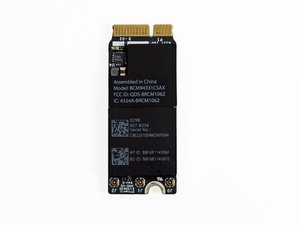

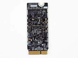

Image 1/3: Closer inspection, however, reveals otherwise: Image 2/3: Broadcom [http://www.broadcom.com/products/Wireless-LAN/802.11-Wireless-LAN-Solutions/BCM4331|BCM4331] single-chip 802.11n dual-band wireless solution Image 3/3: Broadcom [http://www.broadcom.com/products/Bluetooth/Bluetooth-RF-Silicon-and-Software-Solutions/BCM20702|BCM20702] single-chip Bluetooth 4.0 HCI solution with Bluetooth Low Energy (BLE) support
  • At first, the AirPort card in the MacBook Pro looks very similar to the one that we pulled out of the Mid 2012 MacBook Air.
  • Closer inspection, however, reveals otherwise:
    • Broadcom BCM4331 single-chip 802.11n dual-band wireless solution
    • Broadcom BCM20702 single-chip Bluetooth 4.0 HCI solution with Bluetooth Low Energy (BLE) support
    • Skyworks WiFi Block

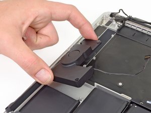

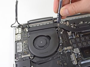

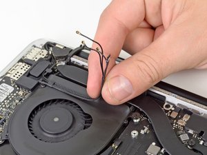

Image 1/3: We jumped at calling the fan inside the [guide|9457|Mid-2012 MacBook Air 13"|stepid=36162] "asymmetrical," but when compared to the fan inside this MacBook Pro, the Air's fan is definitely more ''[http://en.wikipedia.org/wiki/Rotational_symmetry|periodic]''. Image 2/3: Theoretically, the asymmetry spreads the noise produced over multiple frequencies, making it less noticeable. Image 3/3: This fan has been mentioned in almost all press on the MacBook Pro with Retina display. We are surprised at how much attention a minor blade spacing change is getting. It is nevertheless a testament to how much attention Apple puts on minor details overlooked by the rest of the industry, all for the comfort of the end user.
  • A bracket, some antenna cables, a few screws, and finally we get to the crème de la crème, the fan with asymmetric blade spacing.
    • We jumped at calling the fan inside the Mid-2012 MacBook Air 13" "asymmetrical," but when compared to the fan inside this MacBook Pro, the Air's fan is definitely more periodic.
  • Theoretically, the asymmetry spreads the noise produced over multiple frequencies, making it less noticeable.
  • This fan has been mentioned in almost all press on the MacBook Pro with Retina display. We are surprised at how much attention a minor blade spacing change is getting. It is nevertheless a testament to how much attention Apple puts on minor details overlooked by the rest of the industry, all for the comfort of the end user.

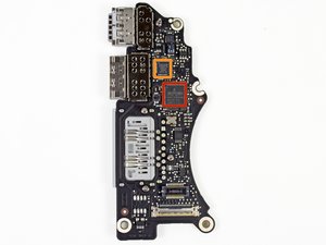

Image 1/2: We love that this Pro has USB 3.0 ports on both sides. At last we resolved the issues of cables that are 12.5" too short and thumb drives, mouse dongles, and [http://www.thinkgeek.com/brain/whereisit.cgi?t=USB&x=0&y=0|USB toys] that are a centimeter too wide. Image 2/2: The I/O board also plays host to a Broadcom [http://www.broadcom.com/products/Ethernet-Controllers/Enterprise-Client|BCM57100] series Gigabit Ethernet + Memory Card reader controller. The Ethernet controller is accessible through the separately-sold Thunderbolt adapter.
  • Next up is the I/O board that plays host to one of the two USB 3.0 ports and the SD card reader.
    • We love that this Pro has USB 3.0 ports on both sides. At last we resolved the issues of cables that are 12.5" too short and thumb drives, mouse dongles, and USB toys that are a centimeter too wide.
  • The I/O board also plays host to a Broadcom BCM57100 series Gigabit Ethernet + Memory Card reader controller. The Ethernet controller is accessible through the separately-sold Thunderbolt adapter.
  • ParadeTech PS8401A HDMI Jitter Cleaning 3 Gbps HDMI repeater
"The Ethernet controller is accessible through the separately-sold Thunderbolt adapter."
Do you really think this is the controller that is accessed with the thunderbold adapter?
First: it is on the other side of the computer...
Second: the adapter itself has the ethernet controller on board?!
So what do you mean by that statement?
derbroti - Reply
I would also like to know whether the onboard ethernet is really wired up? It identifies as 14e4:16a3 "Broadcom Corporation Device 16a3 (rev 21)". I do not think it is used in the Thunderbolt ethernet adaptor, since the thunderbolt adaptor has its own onboard BCM57762 ethernet controller. So what is the point of including ethernet in the Macbook itself? Can it be used?
Chris -
this might sound dumb at first but i think it actually works with the airport wireless NIC somehow. (en0)
tjt263 -

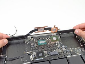

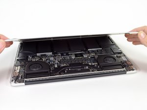

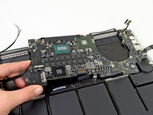

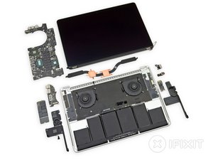

Image 1/3: By pushing the air through a restriction before it gets to the outermost vents, you introduce an additional pressure drop (due to fluid shear stress at the walls) that accelerates the air and pushes it out of the computer faster. Image 2/3: With that last obstacle out of the way, the logic board comes out fairly effortlessly. Image 3/3: With that last obstacle out of the way, the logic board comes out fairly effortlessly.
  • The next piece out is the processor and GPU heat sink and exhaust air vent assembly.
    • By pushing the air through a restriction before it gets to the outermost vents, you introduce an additional pressure drop (due to fluid shear stress at the walls) that accelerates the air and pushes it out of the computer faster.
  • With that last obstacle out of the way, the logic board comes out fairly effortlessly.

Image 1/1: NVIDIA [http://www.geforce.com/hardware/notebook-gpus/geforce-gt-650m|GeForce GT 650M] GPU
  • Major players on the front of the logic board include:
    • NVIDIA GeForce GT 650M GPU
    • Intel Core-i7 3720QM 2.6 GHz processor (Turbo Boost up to 3.6 GHz) with Intel Graphics HD 4000.
    • What appears to be an Intel E208B284 Platform Controller Hub
    • Hynix H5TC2G83CFR DDR3L SDRAM
    • Intel DSL3510L Thunderbolt controller
So I guess there is no easy way to upgrade the RAM...
You cannot swap new/bigger memory bars.
Can you confirm?
Thank you!
Francois Massart - Reply
You're stuck with the RAM you buy. There's no way to upgrade the RAM unless you switch out the entire logic board.
Miroslav Djuric -

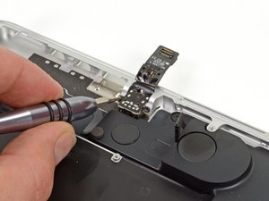

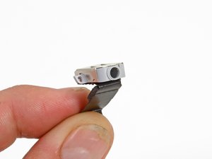

Image 1/2: This is where you plug in headphones or speakers. We're not sure why you wouldn't want to share the magic of Apple's specially-engineered speaker system, though… Image 2/2: This is where you plug in headphones or speakers. We're not sure why you wouldn't want to share the magic of Apple's specially-engineered speaker system, though…
  • The headphone jack is held in place pretty snugly, but that doesn't stop us.
  • This is where you plug in headphones or speakers. We're not sure why you wouldn't want to share the magic of Apple's specially-engineered speaker system, though…
Any chance that it can be used as Line In as well? or only using the iPhone headphones mic (4th position of Tip, Ring, Sleeve, Sheath) And optical in and out?

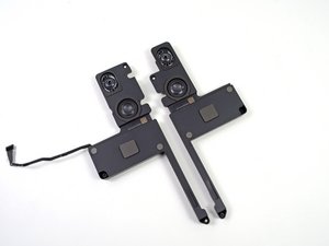

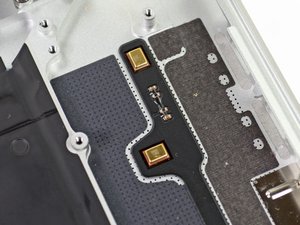

Image 1/3: Apple claims that their custom speakers make the most of "every cubic millimeter" inside the MacBook Pro. For $2200, we sure hope that they wouldn't be plug-and-play. Image 2/3: The dual DXEC02 bottom-port Knowles MEMS microphones (with Job Id/Tape Numbers) lie underneath (or on top of?) the left speaker assembly. They use an "adaptive beam-forming algorithm" to cancel out background noise to make it easier to ~~talk to your computer~~ make calls via Skype and improve the speech recognition performance. Image 3/3: The dual DXEC02 bottom-port Knowles MEMS microphones (with Job Id/Tape Numbers) lie underneath (or on top of?) the left speaker assembly. They use an "adaptive beam-forming algorithm" to cancel out background noise to make it easier to ~~talk to your computer~~ make calls via Skype and improve the speech recognition performance.
  • …and right on cue, out come the speakers.
  • Apple claims that their custom speakers make the most of "every cubic millimeter" inside the MacBook Pro. For $2200, we sure hope that they wouldn't be plug-and-play.
  • The dual DXEC02 bottom-port Knowles MEMS microphones (with Job Id/Tape Numbers) lie underneath (or on top of?) the left speaker assembly. They use an "adaptive beam-forming algorithm" to cancel out background noise to make it easier to talk to your computer make calls via Skype and improve the speech recognition performance.
Does the audio port have optical digital?
Benjamin Green - Reply
From the Apple specs sheet neither this new MacBook Pro or the new MacBook Air have digital outputs. Just looking at the connector in the disassembly photos it appears to be true - Sorry

Image 1/2: The Retina display LCD is situated in the display assembly, and it's not going anywhere. Chances are if anything related to the display goes bad, you'll be replacing the whole kit'n'caboodle. Image 2/2: Don't forget that the display assembly also includes the FaceTime Camera, WiFi antennas, and Bluetooth antennas.
  • A few cables and hefty display hinge screws hold the display assembly in place, but not for long.
  • The Retina display LCD is situated in the display assembly, and it's not going anywhere. Chances are if anything related to the display goes bad, you'll be replacing the whole kit'n'caboodle.
    • Don't forget that the display assembly also includes the FaceTime Camera, WiFi antennas, and Bluetooth antennas.
  • Someone really did not want the battery in the MacBook Pro to come out of the upper case.
  • We tried valiantly with our iFixit 6 Inch Metal Ruler to free the battery from its aluminum confines, but to no avail. Rather than risk puncturing a lithium-polymer battery cell, we left the power source in place.
  • To complicate matters further, the TrackPad cable lies underneath the battery. Attempting to pry the battery off the upper case could easily sever the fragile cable, which would be bad.
What about heat to free the batteries? Since the case is metal, what are the thoughts of gradually heating the case, until the glue begins to loosen up? Naturally, you'd want to do that with as much other stuff removed as possible.
I think the key would be a precision heating of the case (not just hitting the batteries with a heat gun), learning what the meltio0ng point is and not going a degree above that!
John Rees - Reply
Are the battery modules glued to some kind of common rack, which can be then taken out as a whole or are they individually glued to enclosures frame?
Michael Seydl - Reply
The warning label for the batteries says 100 °C. I bet the glue is hot melt and it turns to butter at some temperature well below that. Apple offers battery replacement service so there has to be some reliable way to un-bond the glue.
I bet at about medium well (160 °F or 71 °C) the batteries fall right out.
Dave Adams - Reply
Have your tried a swab of rubbing alcohol on the glue holding the batteries? If it's hot melt adhesive, they'll cleanly pop right off.
Phil Burgess - Reply
Suggest trying "Undu" - scrapbooker's adhesive remover. Brilliant stuff. (chemical = hexane) Dissolves the pressure sensitive adhesive glue bond, then evaporates leaving the adhesive still sticky for reuse. I have used it on iPhone battery with success.
B Louis - Reply
So... while I generally agree with everything said here, I wanted to address the battery issue. I've now stripped out 7x highly used and dying, or damaged batteries without damaging them. I use a 1-1/2" wide very stiff (with a dull front edge, similar to this: http://www.walmart.com/ip/32522800?wmlsp...). I them wrap the entire blade in electrical tape to soften edges. Then, coming at various strategic angles (depends on which portion of the battery I'm removing), I go under each. From a top down view with the battery at the bottom and the logic board on top, the two middle portions are the most difficult (with the middle one on the right being the trickiest) to remove. Leave the two middle portions for last... for one, that's where the trackpad ribbon/trackpad guard is, but also simply because u can go underneath the outside portions to get to those (once you've gotten the outside portions lifted away).
jcarter - Reply
Image 1/2: Proprietary pentalobe screws prevent you from gaining access to anything inside. Image 2/2: As in the MacBook Air, the RAM is soldered to the logic board. Max out at 16GB now, or forever hold your peace—you can't upgrade.
  • MacBook Pro with Retina Display 15" Mid 2012 Repairability Score: 1 out of 10 (10 is easiest to repair).
  • Proprietary pentalobe screws prevent you from gaining access to anything inside.
  • As in the MacBook Air, the RAM is soldered to the logic board. Max out at 16GB now, or forever hold your peace—you can't upgrade.
  • The proprietary SSD isn't upgradeable either (yet), as it is similar but not identical to the one in the Air. It is a separate daughtercard, and we’re hopeful we can offer an upgrade in the near future.
  • The lithium-polymer battery is glued rather than screwed into the case, which increases the chances that it'll break during disassembly. The battery also covers the trackpad cable, which tremendously increases the chance that the user will shear the cable in the battery removal process.
  • The display assembly is completely fused, and there’s no glass protecting it. If anything ever fails inside the display, you will need to replace the entire extremely expensive assembly.

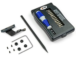

Can you tell whether there is space and a way to fit a sata drive in for additional disk space?
Tay Zombulovich - Reply
If you take out one of the fans or the battery cells, sure. I wouldn't suggest doing either of those, though.

SSD Upgrade: Check out OWC's Aura/Aura Pro 6G... or Transcends Jetdrive 720 (with a 960GB option!!)

can the 802.11ac WiFi card from the late 2013 model work in the mid 2012 model?
cyglenn - Reply

I removed my battery using your method using 91% Isoproyl. It took a little work but it turned out great!! The battery is defiantly removable and not to difficult to do. So happy to see my computer up and running like normal.
Nick Fulton -
I'm surprised no one has tried a heat gun on the battery yet.
mpias - Reply
I have, not recommended. Thankfully it was tested on an out of warranty one that was going to be binned anyway, but the batteries warped to the point that they no longer fit properly in the case, due to the fine tolerances. All in all, a completely shite design. What is wrong with a slimline plastic frame to hold batteries in place, and screws to hold the plastic in place? This is a top of the range computer, and it's batteries are held on with tape? Better check they didn't cable-tie the screen hinges ;)

Replace the whole display assembly!
I managed to find an exact 15" retina display assembly for $160 (an Apple genius want over $600) and replaced my damaged one. The ifixit's instructions is a straight forward. Make sure that you are calm when you reconnect the 3 tiny connectors back, yes very tiny. Thanks to fixit.
Adisak Ratana - Reply
I managed to replace the 15" retina display assembly myself and save big bucks. I found the new exact display assembly for $160 on eBay. Apple store want over $600. when you do the works, pls make sure you are calm and in a good mood. The instruction is a strait forward. Thanks to ifixit.
I removed the battery using "paracord" of strong string to cut the tape underneath the battery in a garotte fashion. Worked a treat. new trackpad and battery win :) search "How to remove 15" MacBook Pro Retina Glued Battery with a Thread" on youtube.
contact - Reply
Interesting, I found a few difffernces with mine. Same model and all, but my 512SSD is using a Marvell control chip, Samsung cache chip, and San disk nand flash memory chips. Maybe mine is made by crucial since it almost follows the Crucial M4 drives.
The Marvell controler is the Marvell 88SS9174-BLD2
Samsung cache is K4B4G1646B-HCK0
And the NAND memory is SanDisk 05055 064GA
This is an original MacBook Pro retina mid 2012 15 inch, but Apple did replace the SSD drive under apple care once. Maybe this is a faster one then the original one it came with?
