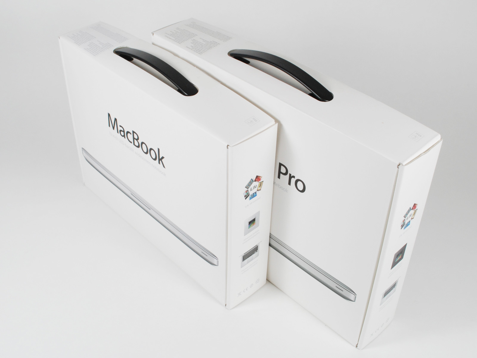

  1. MacBook Pro 15" Unibody Teardown, MacBook Pro 15" Unibody Teardown: step 1, image 1 of 1
    • The new, 37 percent friendlier-to-squirrels and tree-frogs MacBook Pro box. Yay for pallet density! Oh, and it's heavier than it looks.
