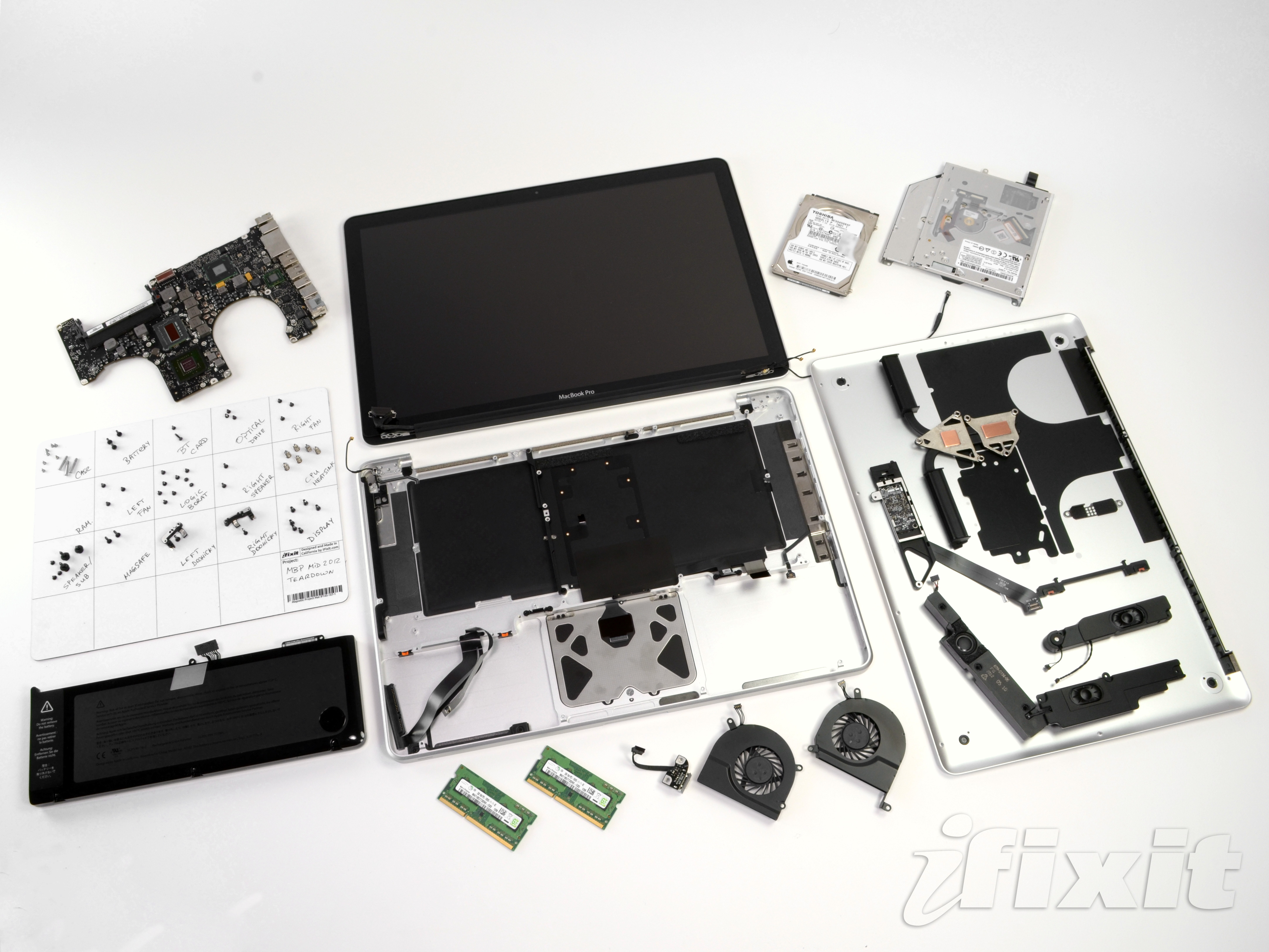

    • The hinges are the last thing securing the display assembly to the case.
    • While the display may not be a Retina, a damaged LCD will still be the most expensive—besides the logic board—repair on this machine. Display replacement is arguably the most difficult MacBook Pro repair, as even the most experienced technician risks shattering the glass panel during removal.
  15. MacBook Pro 15" Unibody Mid 2012 Teardown: step 15, image 1 of 3 MacBook Pro 15" Unibody Mid 2012 Teardown: step 15, image 2 of 3 MacBook Pro 15" Unibody Mid 2012 Teardown: step 15, image 3 of 3
    Tool used on this step:
    Magnetic Project Mat
    $19.95
    Buy
    • There you have it, all the screws from the MacBook Pro Mid 2012, on our fancy magnetic project mat. As you can see there are no pesky pentalobe screws, just Phillips, Torx, and Tri-Wing.
    • By the way, we don't just make awesome teardowns—we sell parts. And tools! Lots and lots of tools.
    • Like this handy-dandy electronics tool kit that we used to take apart the new iPad. You know you want one. It'll pay for itself the first time you use it!
    • We sell Mac parts & upgrades, parts for iPhone screen repair, kits for fixing the infamous Xbox Red Ring of Death, and tons more.
    • We need your support to continue building the free repair manual for everything in the world.
  16. MacBook Pro 15" Unibody Mid 2012 Teardown: step 16, image 1 of 2 MacBook Pro 15" Unibody Mid 2012 Teardown: step 16, image 2 of 2
    • MacBook Pro 15" Unibody Mid 2012 Repairability Score: 7 out of 10 (10 is easiest to repair).
    • Easily removable bottom panel and readily accessible battery, optical drive, hard drive, fans, and RAM.
    • Standard screws were used for all components, save for the battery.
    • Significant amounts of thermal paste may be a pain in later repairs.
    • Tri-wing screws on the battery require a specialty driver that an average user may not have.
    • LCD replacement is still the most difficult repair. Inexperienced (and even experienced) technicians may shatter the glass during repair.
