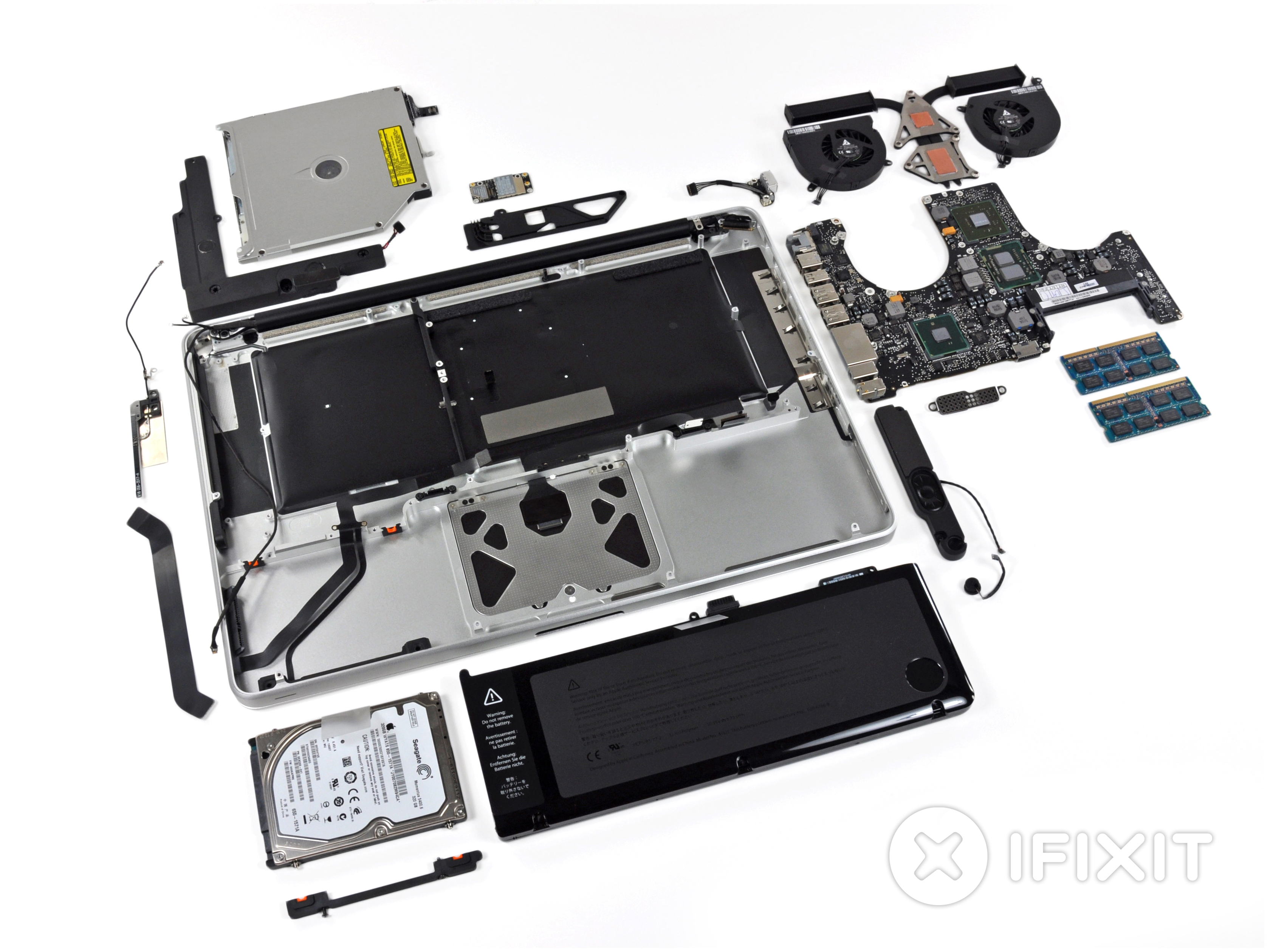

Removing the rear cover will get things going.
Servicing the battery is not super easy due to the fact that you need a Tri-Wing screwdriver to get it out of the machine.
Taking off the rear cover reveals a machine that is not very exciting or different from earlier MacBook Pro models.
As usual, there's a sticker warning against removing the battery. Por qué, Apple?
Silly sticker... You can't stop us!
For some odd reason, Apple has stopped using five-point Torx screws found on other MBP 15" Unibodies in favor of Tri-Wing screws. Try as you may, Apple, you won't win. We got all the screwdrivers right here.
The battery is now rated at 77.5 Wh. That's just a tad bit more than the 73 Wh battery found in last year's 15" model, but not enough to explain the 1-2 hour battery life improvement Apple is claiming for this machine.
Perhaps they optimized the Pro's power consumption?

With the antenna out of the way, the optical drive can be removed.
The new MacBook Pro uses the same Seagate hard drive from the previous model.
Removing the speaker and subwoofer assembly requires removing four measly screws holding it on the upper case.
Since the AirPort/Bluetooth board is mounted inside the all-metal case of this machine, Apple added an antenna that is mounted on the frame for the optical drive opening. Pretty clever!
After removing the two cooling fans and disconnecting many connectors, the logic board and DC-In board can be removed as one piece.

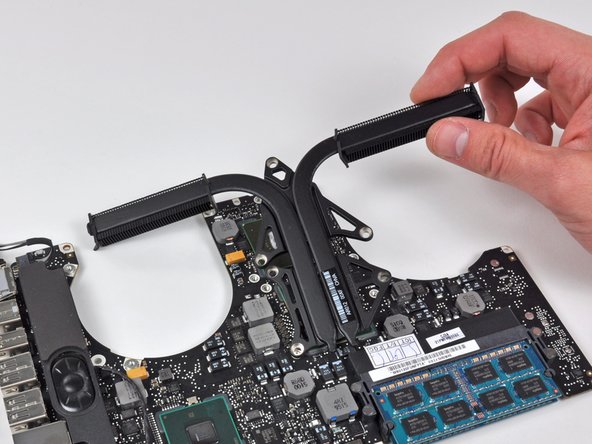

The logic board and heat sink assembly by itself.
The speaker, microphone, and port layout are unchanged from previous MBP 15" Unibody machines.
Huge versions of these scans can be found here and here. 56K beware!
Intel Core i5 processor with integrated graphics.
NVIDIA GeForce GT 330M. The OS switches to the NVIDIA graphics for higher demand applications.
Intel BD82HM55 S LGZS Platform Controller Hub. Interestingly enough, the hub is not connected to the heat sink. Apparently, enough heat is convected from the surface of the silicon to remove the small amount of heat generated by the graphics switching operations.
Upclose of the Intel BD82HM55 S LGZS Platform Controller Hub.
We assume this chip could be some sort of switch between the Intel and NVIDIA graphics.
The heat sinks can be separated from the logic board, leaving it very cold and lonely.

Step 3
What size of tri-wing screw driver is needed?
charlie dropbox - Reply
Same question from me. Just bought the new MacBook Pro, and I want to get a triwing screwdriver to remove the back case for hard drive replacement.
I have 6 screwdrivers sets, nice ones, but no triwing bits.
Jason G - Reply
iFixit has two bit driver kits, both which contain the Y0 bit necessary to remove the screw:
54 piece kit
26 piece kit
Brady Cabe - Reply
Excellent! Thank you Brady.
charlie
Are the tri-wing screws actually holding the back, or are these only for the battery retainer? The online instructions Apple makes available for HD replacement for the 17" i7 (here) say you only need a #00 Phillips.
Eric Tiffany - Reply
Eric,
The back only needs the Phillips. If you want to remove the battery, you would need the triwing bits.
charlie
Bought! Thanks. Now I have 6 nice screwdriver sets. :-)
Jason G - Reply
Oops, now I have 7.
Jason G - Reply

Step 16
The Platform Controller Hub is all the I/O - USB, SATA, additional PCIe, SPI for Flash, LPC for embedded controller, etc.
On the back-side there is an NXP DisplayPort switch and a Lattice programmable chip for switching LVDS going to the LCD display. These are the same chips use to switch between the 9400M and the 9600GT in the previous unibody MacBook Pros. So I wonder if Apple could add automatic GPU switching to them as a sotware update?
toppernh - Reply
Step 17
Wouldn't that make the logic board hot and bothered rather than cold and lonely?
Robert Coleman - Reply
