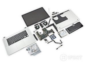

We got our hands on Apple's newest MacBook Pro 15" on February 24, 2011. This is Apple's first laptop to sport a quad-core processor, and also adds a brand-new I/O technology with a Thunderbolt port. Follow us on Twitter to get all the latest updates.
This teardown is not a repair guide. To repair your MacBook Pro 15" Unibody Early 2011, use our service manual.

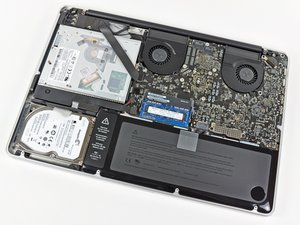

Image 1/3: The RAM in this machine is [link|http://www.ifixit.com/search?query=pc3-10600|PC3-10600 RAM]. That's the same RAM used in the 2010 revision of the 21.5" and 27" iMacs, but different from earlier Apple laptops. PC3-10600 RAM is backwards compatible with the PC3-8500 RAM in older MacBook Pro Unibody machines, but you can't use older PC3-8500 RAM in this machine. Image 2/3: The RAM in this machine is [link|http://www.ifixit.com/search?query=pc3-10600|PC3-10600 RAM]. That's the same RAM used in the 2010 revision of the 21.5" and 27" iMacs, but different from earlier Apple laptops. PC3-10600 RAM is backwards compatible with the PC3-8500 RAM in older MacBook Pro Unibody machines, but you can't use older PC3-8500 RAM in this machine. Image 3/3: The RAM in this machine is [link|http://www.ifixit.com/search?query=pc3-10600|PC3-10600 RAM]. That's the same RAM used in the 2010 revision of the 21.5" and 27" iMacs, but different from earlier Apple laptops. PC3-10600 RAM is backwards compatible with the PC3-8500 RAM in older MacBook Pro Unibody machines, but you can't use older PC3-8500 RAM in this machine.

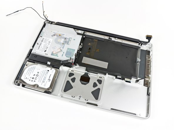

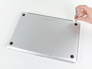

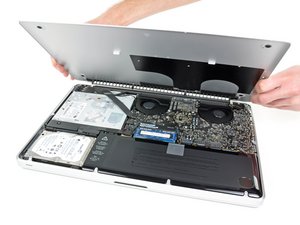

  • The lower case is secured by ten Phillips #00 screws. There are no pentalobe screws since Apple still considers the RAM and hard drive to be user-replaceable. However, like the machine this replaces, the battery is not user-replaceable (at least according to Apple).
  • The RAM in this machine is PC3-10600 RAM. That's the same RAM used in the 2010 revision of the 21.5" and 27" iMacs, but different from earlier Apple laptops. PC3-10600 RAM is backwards compatible with the PC3-8500 RAM in older MacBook Pro Unibody machines, but you can't use older PC3-8500 RAM in this machine.

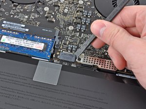

  • This machine boasts a 77.5 Watt-hour battery. That's the same capacity as the previous revision, but the reported battery life has gone from 8-9 hours to 7 hours. Has performance really decreased, or is Apple being more realistic with their estimates? We don't have 7 hours to wait and find out, so we'll have to leave that investigation to someone with a fully-assembled unit.
  • Just like the previous revision, the battery is secured by Tri-Wing screws.
  • A spudger makes disconnecting the battery easy enough.
  • On this model, you're able to disconnect the battery without having to remove it from the laptop. It's a nice design choice since you need to disconnect the battery before performing any repairs.

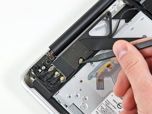

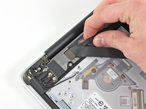

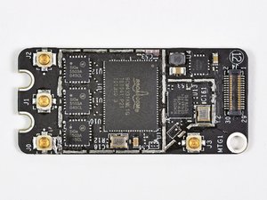

  • The wireless card includes support for 802.11n wireless with 3 antennas as well as what seems to be a dedicated antenna for Bluetooth 3.0.
Actually its more of a question. Is that tape or a thin matted plastic holding the ribbon like antenna down?
deryl - Reply
It's a metallic fabric tape to probably ground the cable and protect the connector from EMI.

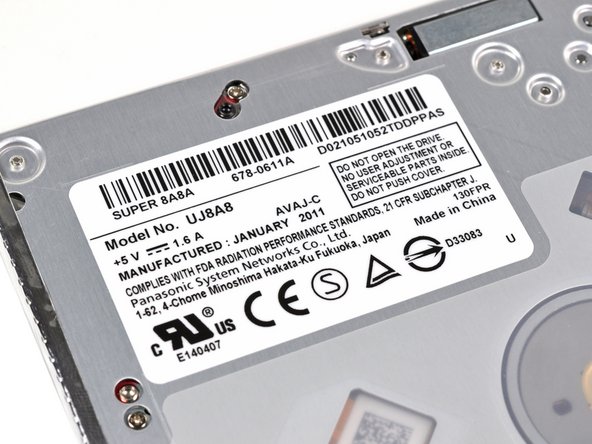

Anyone get a close look at the screws holding down the optical drive? I'm curious as to what sort of screwdriver I may need since apple seems to be no-longer using phillips there.
vicrhombus - Reply
They are T6 Torx screws.

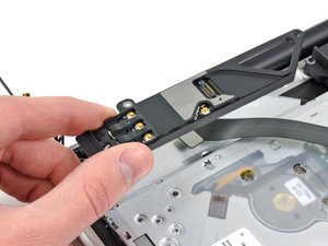

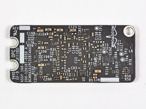

Image 1/3: According to Broadcom, the BCM4331 chip provides "three transmitting and three receiving streams of data in both the 2.4Ghz and 5Ghz bands. Increased number of streams and antennas results in faster speeds, longer range, fewer dropped connections, and better overall wireless coverage." Image 2/3: The BCM2070 Bluetooth controller is described as follows on the Broadcom site: "The Broadcom BCM2070 is a monolithic, single-chip, stand-alone baseband processor with a high performance integrated 2.4-GHz RF transceiver. It is fully compliant with Bluetooth 3.0 and all prior standard features...using advanced 65-nm LP CMOS technology," Image 3/3: The wireless card bracket is aluminum, rather than the plastic in previous revisions. Perhaps this change was made for thermal reasons, as a visible pink thermal pad is used to transfer heat from the board to its aluminum bracket.
  • After removing a soldered EMI shield, we find 802.11n wireless connectivity provided by a Broadcom BCM4331 "Single-Chip 802.11n Dual-Band 3x3 Wireless Solution." Bluetooth 3.0 support is handled by a BCM2070 in a separate, shielded section of the board.
  • According to Broadcom, the BCM4331 chip provides "three transmitting and three receiving streams of data in both the 2.4Ghz and 5Ghz bands. Increased number of streams and antennas results in faster speeds, longer range, fewer dropped connections, and better overall wireless coverage."
  • The BCM2070 Bluetooth controller is described as follows on the Broadcom site: "The Broadcom BCM2070 is a monolithic, single-chip, stand-alone baseband processor with a high performance integrated 2.4-GHz RF transceiver. It is fully compliant with Bluetooth 3.0 and all prior standard features...using advanced 65-nm LP CMOS technology,"

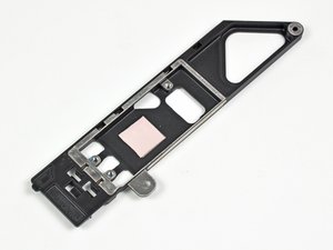

  • The wireless card bracket is aluminum, rather than the plastic in previous revisions. Perhaps this change was made for thermal reasons, as a visible pink thermal pad is used to transfer heat from the board to its aluminum bracket.
I tried to edit Step 7 to point out the BCM2070 Bluetooth chip and how 3 antennas are for wifi while the forth is for Bluetooth, but the edit was apparently denied without explanation. It seems complete and correct information is not desired here.
cityzen - Reply

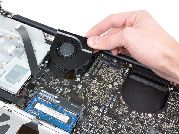

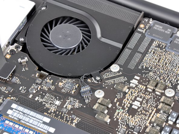

  • Like most 15" Unibody laptops, there are two fans. To make sure things stay cool, there's a plethora of temperature sensors scattered throughout the machine, including near the trackpad, in the battery, and on the logic board.
What kind of screwdriver was used to remove fans?
Rodrigo Siqueira - Reply
Hi Rodrigo! This guide is a teardown and shouldn't be followed for repairs! You can take a look at our full manual or look at the left fan replacement guide or right fan replacement guide. The screws will be T6 Torx screws.
Sam Lionheart -

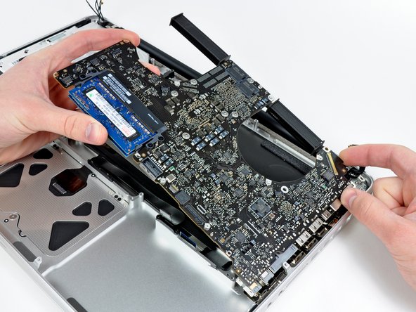

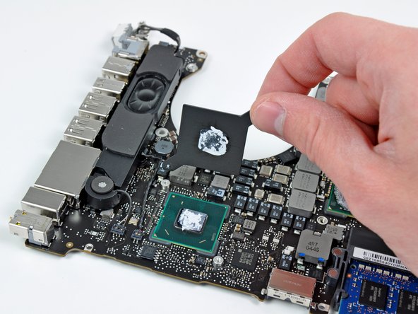

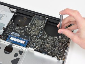

  • The main board lifts out along with the heat sink still attached. This is a nice feature, as this way you have to remove the heat sink and reapply thermal paste only if you're completely replacing the logic board.

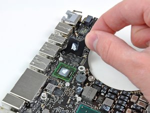

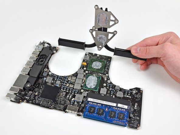

Image 1/3: Holy thermal paste! Time will tell if the gobs of thermal paste applied to the CPU and GPU will cause overheating issues down the road. Image 2/3: The [guide|2212|Mid 2010 15" Unibody] was equipped with only one large heat sink to cool just the CPU and GPU. Also for that revision, the graphics switching chip seen in the second image was present, but didn't receive a heat sink. Image 3/3: The chip under the heat sink in the third image is a new chip that is most likely the Thunderbolt controller.
  • This machine features not only the large primary heat sink, but also two smaller heat sinks.
  • Holy thermal paste! Time will tell if the gobs of thermal paste applied to the CPU and GPU will cause overheating issues down the road.
  • The Mid 2010 15" Unibody was equipped with only one large heat sink to cool just the CPU and GPU. Also for that revision, the graphics switching chip seen in the second image was present, but didn't receive a heat sink.
  • The chip under the heat sink in the third image is a new chip that is most likely the Thunderbolt controller.
The Intel BD82HM65 Platform Controller Hub is not just a "graphics switching chip". It is an I/O hub, where all the various I/O interfaces come together before going to the CPU and memory. This includes PCIe, USB 2.0, SATA, ethernet, HD audio, and various other interfaces as well as the display outputs.
cityzen - Reply
Question on the thermal paste. Since the gobs of thermal paste applied to the CPU and GPU will cause overheating issues down the road, is it advisable for us to redo the thermal paste to avoid issues in the future especially overheating? Guess this probably will void the warranty. Any advice anyone?
dw4510619 - Reply
Regarding the imperfect thermal paste;
Why would this be a problem? As long as the thermal conducting surfaces are covered, simply installing the heatsink will squish out any excess while not set; leaving the required thickness and coverage to perform.
Sure; it's less pretty, but do you see it every day? And overspill onto the green varnished parts of the chip(s) isn't going to have any effect.
Better people leave well alone than cause mass panic of the less capable ripping off heatsinks, sandpapering chips, and under applying paste to a single corner, thinking this will ensure optimum performance or something...
Googlyhead - Reply
I should probably also have said; just b'cos one has a less-than-aesthetically-pleasing goo application doesn't mean they all have. I'm sure there's temperature monitoring tools that can help you see if there's any deficiency, without the need to pop the covers.
Googlyhead - Reply

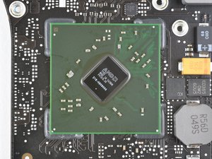

Image 1/3: In the second picture is the AMD Radeon HD 6490M GPU. Image 2/3: If you're wondering about the AMD GPU, ATI was purchased by AMD in 2006. However, only within the last few months has AMD retired the ATI name and begun branding their graphics chips with AMD. Image 3/3: In the third picture is the quad-core Intel i7 processor.

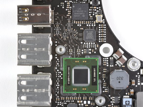

  • The Thunderbolt port is shown in the top left corner of the first picture. Also seen are the traces leading to what we think is the Thunderbolt controller IC.
  • In the second picture is the AMD Radeon HD 6490M GPU.
  • If you're wondering about the AMD GPU, ATI was purchased by AMD in 2006. However, only within the last few months has AMD retired the ATI name and begun branding their graphics chips with AMD.

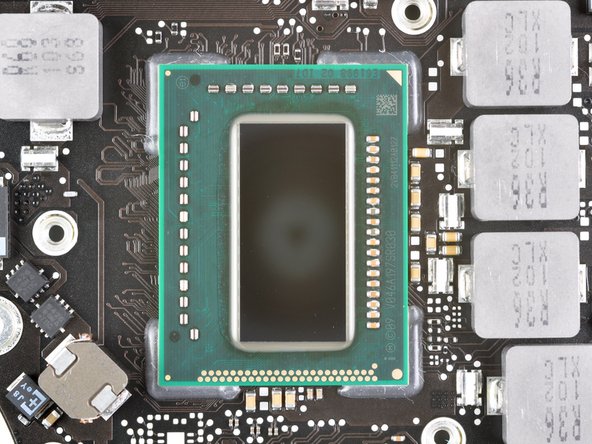

  • In the third picture is the quad-core Intel i7 processor.
Image 1/1: Intel [link|http://ark.intel.com/Product.aspx?id=52808|BD82HM65] Platform Controller Hub
  • Front side of the logic board (gigantic version can be seen here):
    • Intel BD82HM65 Platform Controller Hub
    • AMD Radeon HD 6490M GPU (labeled as AMD 216-0809000)
    • Quad-Core Intel i7-2630QM Mobile Processor (labeled as 2V041112A0127)
    • Broadcom BCM57765B0KMLG Integrated Gigabit Ethernet and Memory Card Reader Controller
    • Intel L051NB32 EFL (we assume this is the Thunderbolt port controller)
    • Parade PS8301 U08FUC
    • TDK 6T213HF 1045 H
Going by Apple's specs, looking at Intel's site I believe these are the 3 i7 CPU models in the 15" 2011 MBP:
Intel Mobile i7 compare Hyperlink
So from low to high performance, the chips should be:
2.0 GHz Quad Core i7-2630QM
2.2 GHz Quad Core i7-2720QM
2.3 GHz Quad Core i7-2820QM
Dangerous Dave - Reply
The Intel H65 PCH hub appears to be a B3 stepping without the SATA bug (SLJ4P). Buggy B2 stepping chipsets were SLHxx.
Emyr - Reply
Context, as relating to Sandy Bridge issue: http://www.tomshardware.com/news/Cougar-...
Martin Cleaver -
You missed marking the important LSI FW843 Firewire controller chip in Step 12 (it's between the Broadcom BCM57765B0KMLG and Parade PS8301 chip).
audio01mail - Reply
The PS8301 could be a Display Port repeater. A similar part is here:
http://www.paradetech.com/wp-content/upl...
barabas - Reply
The AMD Radeon chip number you provide (216-00809000) is wrong, it should be 216-0809000.
cheers.
Marcin Nowak - Reply

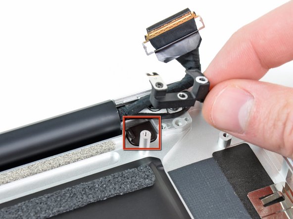

Image 1/3: Small plastic plates adhered near the display hinges seem to keep the display data cable and antenna cable bundle stationary while the display is opened and closed. Image 2/3: The SuperDrive used on this machine has the model number UJ8A8, making it presumably different from the model UJ898 used in the Mid 2010 15" Unibody. Image 3/3: The SuperDrive used on this machine has the model number UJ8A8, making it presumably different from the model UJ898 used in the Mid 2010 15" Unibody.
  • Aside from the logic board differences, there really isn't much else that makes this machine different from its 15" Unibody ancestors.
  • Small plastic plates adhered near the display hinges seem to keep the display data cable and antenna cable bundle stationary while the display is opened and closed.
  • The SuperDrive used on this machine has the model number UJ8A8, making it presumably different from the model UJ898 used in the Mid 2010 15" Unibody.
Your teardown is of a HDD based machine. If I bought a SSD 128gb & added HDD via MCE Optibay, I'd seek to move the SDD into the OptiBay, because http://www.ehmac.ca/anything-mac/84938-d... "regular hdd slot has the sudden motion sensor which hdds should have and the optical bay doesn't have the sudden motion sensor which for an ssd doesn't matter anyway"
Martin Cleaver - Reply
According to http://en.wikipedia.org/wiki/Sudden_Moti... , the MacBook Pro has in the past featured a Kionix three-axis accelerometer chip, (KXM52-1050), for protecting its HDD. That said, I couldn't see a KXM chip on the teardown photos (but didn't find them on past models either.)
My conclusion / assumption on this is that the SSD models are all build-to-order vs, ready made for the HDDs. The drive is considered user replaceable - such that users can swap either HDD for SSD or (less likely) SSD for HDD - meaning the motherboards must be identical and include the Sudden Motion Sensor.
I suppose that shifting the SSD to the OptiBay and adding a HDD would necessitate changing a PRAM / NVRAM setting.
I've an outstanding request with MCE Technologies asking them to verify http://www.facebook.com/permalink.php?st... - they've emailed to say they will know within a few days their official opinions. That link shows people have already fitted exiting OptiBay models.

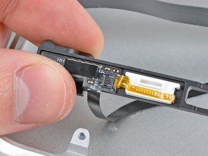

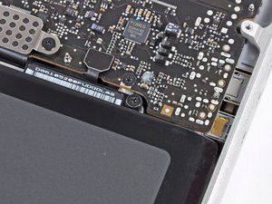

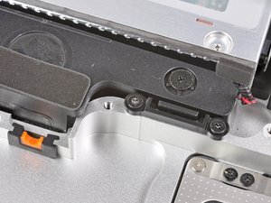

Image 1/2: A stripped screw near the subwoofer enclosure and an unlocked ZIF socket for the IR sensor should not be things found inside a completely unmolested computer with an $1800 base price. Image 2/2: A stripped screw near the subwoofer enclosure and an unlocked ZIF socket for the IR sensor should not be things found inside a completely unmolested computer with an $1800 base price.
  • One thing that has us a little concerned about the new models is their quality control.
  • A stripped screw near the subwoofer enclosure and an unlocked ZIF socket for the IR sensor should not be things found inside a completely unmolested computer with an $1800 base price.

Is the processor model right? The i7-2629 is a 25 W, dual core (not quad core) part.
marinelayer - Reply

There could be more clarity around the wireless card. It does not have an "Extra" antenna for 802.11, that J3 antenna is hooked into the BCM2070 Bluetooth chip at the bottom of that wireless board, so it's a bluetooth antenna.
Apple is still ahead of the game with a 3x3:3 radio, as most APs (Even Cisco enterprise APs) do not support 3 spatial streams today. In fact, most Cisco APs are 3x2:2 (3 antennas, 2 transmit chains, 2 spatial streams). Aruba APs are mostly 3x3:2 (3 antennas, 3 transmit chains, but still only 2 spatial streams). Mobile phones with 802.11n today are usually 1 spatial stream and 1 antenna (Which is why they max at a 65mbps data rate). Most laptops are 2 spatial stream (Max at 150mb data rate on 2.4ghz, or 300mb on 5ghz (when 40mhz wide channels are enabled). Apple is claiming 450 mb data rates because in a 40mhz channel 5ghz situation, they can use a 3rd spatial stream. Most APs don't yet support this, but the AIrport Extreme from Apple does.
Ifixedit - Reply
Might be nice to get close-ups of the PCH and hard drive, in light of the Sandy Bridge bug. Initial reports are that the HD is connected to an SATA-III port and should therefore be unaffected... but it would be nice to know the exact HD model regardless for those considering upgrading it.
Paul Vernaza - Reply
In addition to Emyr's point (that the machine iFixit toredown has the revised PCH Hub), check out http://forums.macrumors.com/showthread.p... which further discusses the point.

Is it possible to remove the Processor? I have burnt my logic board, but the Processor is not damaged, so can I move it to another computer. Seems like a waste to throw away a working quad core processor.
If Yes, how do I do it?

I'm struggling to know which exact part I need to buy for my 15" Early 2011 Macbook Pro.
The hinge of my MBP(Black bar) between display and upper case - it's slightly broken at the back. Visible when the lid is closed.
The photo as per https://d3nevzfk7ii3be.cloudfront.net/ig... does not show that particular part.
To be specific, it's this part here - http://i.imgur.com/034u9FY.jpg
Can anyone advice?
Asri - Reply
I think I found it, just didn't expect that it's not seen in this teardown guide.
http://www.macpalace.com/922-9324-clutch...
Asri -
