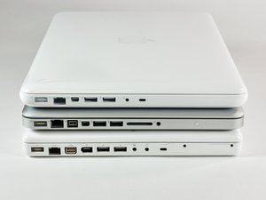

Image 1/2: '''FireWire is gone!''' If you need FireWire, now only a MacBook Pro will do. Image 2/2: Also gone is an IR port for a remote. As far as we know, that makes the MacBook the only currently shipping Apple laptop that doesn't support a remote.
  • Top: New MacBook, Middle: MacBook Pro, Bottom: Old MacBook
  • FireWire is gone! If you need FireWire, now only a MacBook Pro will do.
  • Also gone is an IR port for a remote. As far as we know, that makes the MacBook the only currently shipping Apple laptop that doesn't support a remote.
  • There's also no external battery indicator, a feature borrowed from the MacBook Air.
  • Apple has also replaced Mini-DVI with Mini DisplayPort, and replaced the two audio jacks with a single audio in/out port.
There is no battery indicator on this new MacBook
NaN - Reply
"Also gone is an IR port for a remote. As far as we know, that makes the MacBook the only currently shipping Apple laptop that doesn't support a remote."
And the Mac Pro doesn't support a remote either. What a contrast.
ranron - Reply

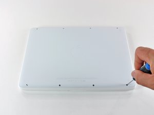

Image 1/2: There are no more rubber feet to tear off! Image 2/2: Eight Phillips #00 screws hold the lower case in place, two less than the 13" Pro.
  • Removing the lower case...
  • There are no more rubber feet to tear off!
  • Eight Phillips #00 screws hold the lower case in place, two less than the 13" Pro.
  • The lower case is surprisingly heavy, weighing in at 266 grams. The lower case is actually a sheet of aluminum with rubberized coating injection-molded onto one side.
  • In contrast, the lower case on the 13" Pro weighs only 142 grams, so the rubber coating nearly doubles the part's weight.
I have a question, when I try to open the lower case, it seems to be stuck in the middle..
I can turn it about 20° to the right and the left but I can't get it open..
what am I doing wrong?
tierce - Reply
I got it, just had to pull a lil harder xD
tierce - Reply

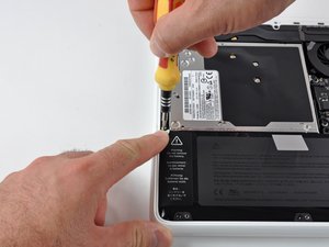

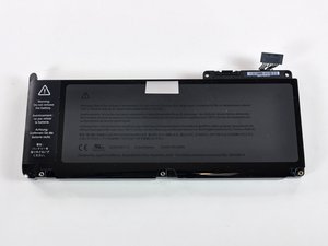

  • Apple boasts an impressive seven hour battery life from the new MacBook, matching that of the 13" and 15" MacBook Pros.
  • The battery is held in with both tri-wing and Phillips screws, an indication that Apple doesn't want you replacing the battery yourself.
  • One of the three tri-wing screws is beneath a warning label in the top left corner of the battery.
  • For most repairs, removing the battery is not necessary, you just need to disconnect it from the logic board. You can use a spudger or your fingernails to lift battery connector straight up out of its socket on the logic board.
Apple doesn’t want you removing the battery yourself so it can be disposed on properly.
NaN - Reply
Quote from Solipsism:
There is plenty of infrastructure for recycling user replaceable batteries in any country where people can afford to buy apple hardware. Requiring two different tools just to replace a battery that definitely will not last any significant international flight or workday is indisputable handicapping. The very minimum battery life where it starts to become acceptable is >10 hours rated, which would probably get you 7-8 hours actual use. At least then you could make it through a days work.
wastedspace - Reply

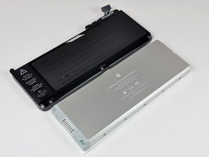

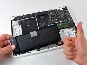

Image 1/3: The previous plastic MacBooks featured a 55 watt-hour battery and claimed a 5-hour run time. Apple has added 5 watt-hours of battery capacity and two hours of run time. Either this machine is substantially more efficient than its predecessor (thanks to the LED backlight?), or Apple's new battery life claims are overly optimistic. Image 2/3: Despite its higher capacity, this new battery is actually lighter than the previous MacBook's battery. This battery boasts a power to weight ratio that's 23.5% better than its predecessor. Image 3/3: Despite its higher capacity, this new battery is actually lighter than the previous MacBook's battery. This battery boasts a power to weight ratio that's 23.5% better than its predecessor.
  • The battery is 60 watt-hours, the same capacity as the 13" MacBook Pro.
  • The previous plastic MacBooks featured a 55 watt-hour battery and claimed a 5-hour run time. Apple has added 5 watt-hours of battery capacity and two hours of run time. Either this machine is substantially more efficient than its predecessor (thanks to the LED backlight?), or Apple's new battery life claims are overly optimistic.
  • Despite its higher capacity, this new battery is actually lighter than the previous MacBook's battery. This battery boasts a power to weight ratio that's 23.5% better than its predecessor.
How do you disconnect the battery from the logic board?
cbee - Reply
I’d wager that the increased run time is due to the LED-backlighting over LCD and that the stated run times are as accurate as previous models.
NaN - Reply
You mean LED backlighting vs CCFL?
LCD is still the display tech. There would be a possible marked difference if it was an OLED display, but given the amount of white on our desktops and that current OLED displays draw significantly more power to display white, it may not save that much power were it to be used.
Diggsby - Reply

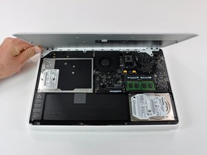

Is it possible to change HDD without removing battery?
ZururuX - Reply
The Mac Mini's also use ram like that, i just upgraded from 1GB to 4, now this thing screams.
Chris Green - Reply
Quote from ZururuX:
Yes, simply remove the two Phillips screws that hold down the hard drive bracket, as described above in step 8
m k - Reply

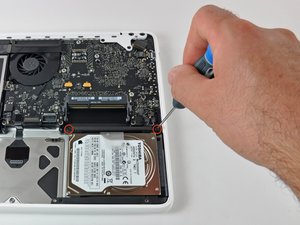

  • The hard drive isn't as easy to replace as it used to be, but it can be done. The hard drive is still considered "user replaceable" by Apple. It's strange that the hard drive is "user replaceable", but the battery is not.
  • After removing two Phillips screws and the hard drive bracket they hold down, lift the hard drive out of the MacBook by its pull tab and disconnect the SATA connector.
  • If you're installing a new hard drive, you'll need a T6 Torx screwdriver to transfer the mounting screws to your new hard drive.
What is the interface between the HDD and the CPU? SATA or SATA2 (1.5GB/s or 3.0GB/s)? What make of HDD would you recommend for a 7200RPH HDD upgrade? Thanks.
tomcat89 - Reply
Quote from tomcat89:
Western Digital, or a seagate baracuda 7200.**, as long as it isn't a 7200.11, they have a lot of firmware problems
Chris Green - Reply

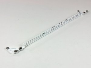

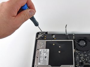

Image 1/2: The rear vent is held in place by both Phillips #00 and T8 Torx screws. Image 2/2: The cast aluminum vent plate is painted with a satin white rubberized paint and probably adds a good amount of rigidity to the device.
  • Getting to the optical drive takes a bit more work...
  • The rear vent is held in place by both Phillips #00 and T8 Torx screws.
  • The cast aluminum vent plate is painted with a satin white rubberized paint and probably adds a good amount of rigidity to the device.
  • The lack of structural supports like these in previous plastic MacBooks accounts for their flexibility.

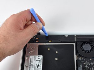

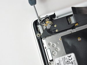

Image 1/3: After popping off a few connectors, removing a few screws (including one inserted into the '''side''' of the optical drive), the optical drive is ''almost'' free. Image 2/3: After popping off a few connectors, removing a few screws (including one inserted into the '''side''' of the optical drive), the optical drive is ''almost'' free. Image 3/3: After popping off a few connectors, removing a few screws (including one inserted into the '''side''' of the optical drive), the optical drive is ''almost'' free.
  • The digging continues as we remove the speaker/AirPort/Bluetooth card assembly.
  • After popping off a few connectors, removing a few screws (including one inserted into the side of the optical drive), the optical drive is almost free.

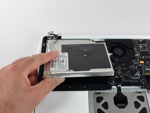

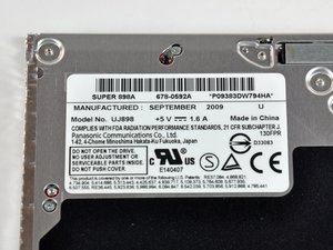

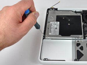

Image 1/3: No surprises here. The optical drive is an 8x SATA SuperDrive. It's a Panasonic model UJ898, made in China September of 2009. Image 2/3: No surprises here. The optical drive is an 8x SATA SuperDrive. It's a Panasonic model UJ898, made in China September of 2009. Image 3/3: No surprises here. The optical drive is an 8x SATA SuperDrive. It's a Panasonic model UJ898, made in China September of 2009.
  • After removing the final few screws, lift the optical drive out of its comfy plastic unibody home.
  • No surprises here. The optical drive is an 8x SATA SuperDrive. It's a Panasonic model UJ898, made in China September of 2009.
Is this UJ898 standard 12.7mm height?
Apple must of got first dibs on this new drive, I only see UJ-875A and UJ-880A on the Panasonic Industrial website.
wefixit - Reply

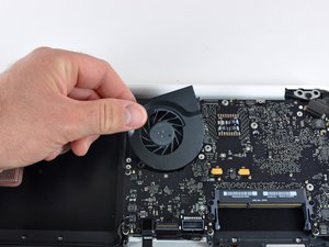

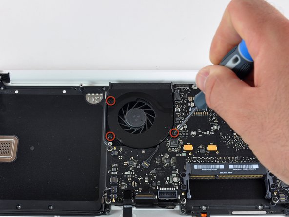

Image 1/2: After a few twists of a screwdriver and the flick of a spudger, the fan lifts right out. Image 2/2: The fan design appears relatively unchanged from previous plastic MacBooks, except that it mounts to the upper case on this model.
  • It has a fan.
  • After a few twists of a screwdriver and the flick of a spudger, the fan lifts right out.
  • The fan design appears relatively unchanged from previous plastic MacBooks, except that it mounts to the upper case on this model.

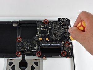

  • Six T6 screws and several fragile connectors stand between us and logic board freedom.
"several fragile connectors stand between us and logic board freedom"
I could really use some more advise on how to disconnect those "fragile connectors" without damaging them! I have been at it for a few hours, but can't find a safe way of doing it. Please help!
Leon R - Reply
Repair guides for this device can be found here.
Andrew Bookholt -
The connector you see at the top right (with the pad on it) is removed by pulling up gently on the black tab, lifting the hinged O-shaped ring free.
EmbraceIT - Reply

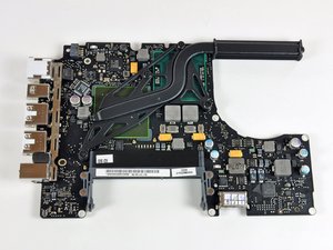

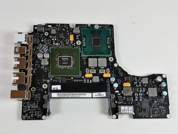

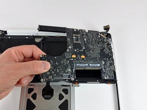

Image 1/2: Like the MacBook Pro Unibody, Apple nicely designed this machine so the logic board and heat sink come out as a single part. This way, you'll only need to get your hands dirty with thermal paste if you're replacing the logic board. Image 2/2: Like the MacBook Pro Unibody, Apple nicely designed this machine so the logic board and heat sink come out as a single part. This way, you'll only need to get your hands dirty with thermal paste if you're replacing the logic board.
  • The logic board removed.
  • Like the MacBook Pro Unibody, Apple nicely designed this machine so the logic board and heat sink come out as a single part. This way, you'll only need to get your hands dirty with thermal paste if you're replacing the logic board.
That's an extremely efficient design to have the heat sink and logic board come out in one piece so you don't have to reapply thermal paste every time. Speaking of, looks like apple really cleaned up their act and applied a correct amount of thermal paste this time around. If it were in old 2,2 MacBook Pro you would be seeing the over applied thermal paste spilling over. Do you have photos of the CPU and GPU before you cleaned the paste off?
wefixit - Reply

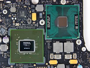

Image 1/2: This is exactly the same GPU and CPU in the base model 13" Unibody MacBook Pro. This CPU offers a whopping 130 MHz increase over the 2.13 GHz chip that powered the old plastic MacBook. Image 2/2: This is exactly the same GPU and CPU in the base model 13" Unibody MacBook Pro. This CPU offers a whopping 130 MHz increase over the 2.13 GHz chip that powered the old plastic MacBook.
  • The MacBook sports a NVidia 9400M GPU and an Intel Core 2 Duo 2.26 GHz CPU.
  • This is exactly the same GPU and CPU in the base model 13" Unibody MacBook Pro. This CPU offers a whopping 130 MHz increase over the 2.13 GHz chip that powered the old plastic MacBook.
It Didn't have any thermal paste on it? or did you guys remove it?
Chris Green - Reply
Image 1/1: Even though the new MacBook ships with a new-style MagSafe adapter, older Magsafe adapters should work just fine.
  • Like other MacBooks, the MagSafe port gets its own board.
  • Even though the new MacBook ships with a new-style MagSafe adapter, older Magsafe adapters should work just fine.
  • Notice the silver grate of a speaker on the right side of this photo. This machine sports two small tweeters beneath the keyboard, one below the caps lock key, and the other below the return key.
Image 1/1: Apple's certainly giving us quite the screw variety on this machine. We've found tri-wing, Phillips #00, T6, and T8 Torx screws.
  • The display assembly is secured by two large T8 screws, one on each side.
  • Apple's certainly giving us quite the screw variety on this machine. We've found tri-wing, Phillips #00, T6, and T8 Torx screws.
  • We sell a screwdriver kit that will enable you to remove all these screws. The tri-wing screws will come out using a 1 mm flathead bit. We'll be adding true tri-wing bits to our screwdriver kits in the near future.
Image 1/1: Since the MacBook now uses a LED backlit LCD, there's no inverter cable. All data and power is transmitted through a single cable.
  • The display assembly. (We did turn it on briefly, and it looks really nice!) On the right side are the three wireless antennas, and on the left side is the single display data cable.
  • Since the MacBook now uses a LED backlit LCD, there's no inverter cable. All data and power is transmitted through a single cable.
  • Apple has shaved about 50 grams off the weight of the display assembly compared to the one on the previous plastic MacBook.
