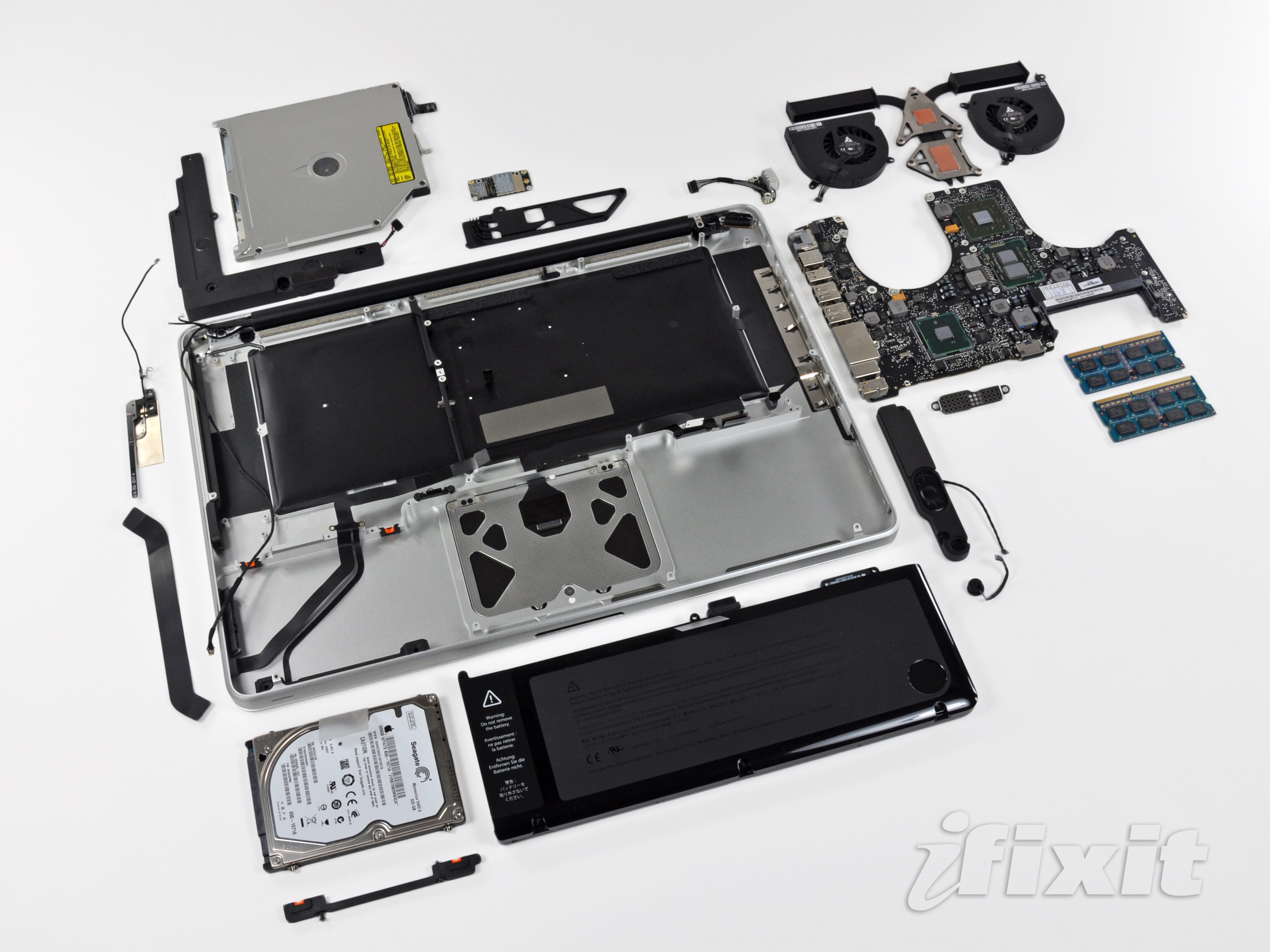

    • After removing the two cooling fans and disconnecting many connectors, the logic board and DC-In board can be removed as one piece.
  14. MacBook Pro 15" Unibody Mid 2010 Teardown: step 14, image 1 of 1
    • The logic board and heat sink assembly by itself.
    • The speaker, microphone, and port layout are unchanged from previous MBP 15" Unibody machines.
  15. MacBook Pro 15" Unibody Mid 2010 Teardown: step 15, image 1 of 2 MacBook Pro 15" Unibody Mid 2010 Teardown: step 15, image 2 of 2
    • Intel Core i5 processor with integrated graphics.
    • NVIDIA GeForce GT 330M. The OS switches to the NVIDIA graphics for higher demand applications.
    • Intel BD82HM55 S LGZS Platform Controller Hub. Interestingly enough, the hub is not connected to the heat sink. Apparently, enough heat is convected from the surface of the silicon to remove the small amount of heat generated by the graphics switching operations.
  16. MacBook Pro 15" Unibody Mid 2010 Teardown: step 16, image 1 of 1
  17. MacBook Pro 15" Unibody Mid 2010 Teardown: step 17, image 1 of 1
    • The heat sinks can be separated from the logic board, leaving it very cold and lonely.
  18. MacBook Pro 15" Unibody Mid 2010 Teardown: step 18, image 1 of 1
    • The Core i5 was no match for iFixit.
    • Here are the remains of this lovely machine...
