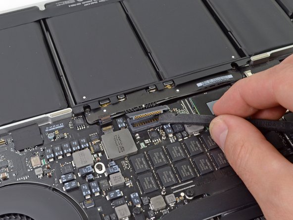

It's always a good idea to disconnect the battery when gutting your gadgets. While Apple seems to have an extensive warning label, it fails to mention potential shocks by failing to disconnect the battery during gadget surgery. Is it possible Apple wasn't expecting us?
  • It's always a good idea to disconnect the battery when gutting your gadgets.
  • While Apple seems to have an extensive warning label, it fails to mention potential shocks by failing to disconnect the battery during gadget surgery. Is it possible Apple wasn't expecting us?
"While Apple seems to have an extensive warning label, it fails to mention potential shocks by failing to disconnect the battery during gadget surgery. Is it possible Apple wasn't expecting us?"
Actually, I think they did. :)

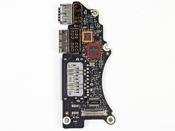

Next up is the I/O board that plays host to one of the two USB 3.0 ports and the SD card reader. We love that this Pro has USB 3.0 ports on both sides. At last we resolved the issues of cables that are 12.5" too short and thumb drives, mouse dongles, and USB toys that are a centimeter too wide.
  • Next up is the I/O board that plays host to one of the two USB 3.0 ports and the SD card reader.
    • We love that this Pro has USB 3.0 ports on both sides. At last we resolved the issues of cables that are 12.5" too short and thumb drives, mouse dongles, and USB toys that are a centimeter too wide.
  • The I/O board also plays host to a Broadcom BCM57100 series Gigabit Ethernet + Memory Card reader controller. The Ethernet controller is accessible through the separately-sold Thunderbolt adapter.
  • ParadeTech PS8401A HDMI Jitter Cleaning 3 Gbps HDMI repeater
"The Ethernet controller is accessible through the separately-sold Thunderbolt adapter."
Do you really think this is the controller that is accessed with the thunderbold adapter?
First: it is on the other side of the computer...
Second: the adapter itself has the ethernet controller on board?!
So what do you mean by that statement?
derbroti - Reply
I would also like to know whether the onboard ethernet is really wired up? It identifies as 14e4:16a3 "Broadcom Corporation Device 16a3 (rev 21)". I do not think it is used in the Thunderbolt ethernet adaptor, since the thunderbolt adaptor has its own onboard BCM57762 ethernet controller. So what is the point of including ethernet in the Macbook itself? Can it be used?
Chris -
this might sound dumb at first but i think it actually works with the airport wireless NIC somehow. (en0)
tjt263 -

A few cables and hefty display hinge screws hold the display assembly in place, but not for long. The Retina display LCD is situated in the display assembly, and it's not going anywhere. Chances are if anything related to the display goes bad, you'll be replacing the whole kit'n'caboodle.
  • A few cables and hefty display hinge screws hold the display assembly in place, but not for long.
  • The Retina display LCD is situated in the display assembly, and it's not going anywhere. Chances are if anything related to the display goes bad, you'll be replacing the whole kit'n'caboodle.
    • Don't forget that the display assembly also includes the FaceTime Camera, WiFi antennas, and Bluetooth antennas.
  • Someone really did not want the battery in the MacBook Pro to come out of the upper case.
  • We tried valiantly with our iFixit 6 Inch Metal Ruler to free the battery from its aluminum confines, but to no avail. Rather than risk puncturing a lithium-polymer battery cell, we left the power source in place.
  • To complicate matters further, the TrackPad cable lies underneath the battery. Attempting to pry the battery off the upper case could easily sever the fragile cable, which would be bad.
What about heat to free the batteries? Since the case is metal, what are the thoughts of gradually heating the case, until the glue begins to loosen up? Naturally, you'd want to do that with as much other stuff removed as possible.
I think the key would be a precision heating of the case (not just hitting the batteries with a heat gun), learning what the meltio0ng point is and not going a degree above that!
John Rees - Reply
Are the battery modules glued to some kind of common rack, which can be then taken out as a whole or are they individually glued to enclosures frame?
Michael Seydl - Reply
The warning label for the batteries says 100 °C. I bet the glue is hot melt and it turns to butter at some temperature well below that. Apple offers battery replacement service so there has to be some reliable way to un-bond the glue.
I bet at about medium well (160 °F or 71 °C) the batteries fall right out.
Dave Adams - Reply
Have your tried a swab of rubbing alcohol on the glue holding the batteries? If it's hot melt adhesive, they'll cleanly pop right off.
Phil Burgess - Reply
Suggest trying "Undu" - scrapbooker's adhesive remover. Brilliant stuff. (chemical = hexane) Dissolves the pressure sensitive adhesive glue bond, then evaporates leaving the adhesive still sticky for reuse. I have used it on iPhone battery with success.
B Louis - Reply
So... while I generally agree with everything said here, I wanted to address the battery issue. I've now stripped out 7x highly used and dying, or damaged batteries without damaging them. I use a 1-1/2" wide very stiff (with a dull front edge, similar to this: http://www.walmart.com/ip/32522800?wmlsp...). I them wrap the entire blade in electrical tape to soften edges. Then, coming at various strategic angles (depends on which portion of the battery I'm removing), I go under each. From a top down view with the battery at the bottom and the logic board on top, the two middle portions are the most difficult (with the middle one on the right being the trickiest) to remove. Leave the two middle portions for last... for one, that's where the trackpad ribbon/trackpad guard is, but also simply because u can go underneath the outside portions to get to those (once you've gotten the outside portions lifted away).
jcarter - Reply

You can't. But you CAN align them. Remove the bottom, loosen the 6 screws of the hinges, and align the display. Tighten, and you're done. It is a 10 minute job.

I removed my battery using your method using 91% Isoproyl. It took a little work but it turned out great!! The battery is defiantly removable and not to difficult to do. So happy to see my computer up and running like normal.

I'm surprised no one has tried a heat gun on the battery yet.
mpias - Reply
I have, not recommended. Thankfully it was tested on an out of warranty one that was going to be binned anyway, but the batteries warped to the point that they no longer fit properly in the case, due to the fine tolerances. All in all, a completely shite design. What is wrong with a slimline plastic frame to hold batteries in place, and screws to hold the plastic in place? This is a top of the range computer, and it's batteries are held on with tape? Better check they didn't cable-tie the screen hinges ;)

I removed the battery using "paracord" of strong string to cut the tape underneath the battery in a garotte fashion. Worked a treat. new trackpad and battery win :) search "How to remove 15" MacBook Pro Retina Glued Battery with a Thread" on youtube.

https://youtu.be/fupkPz55tUo How to replace 15" MacBook Pro Retina Glued Battery with a Thread - Part 1
