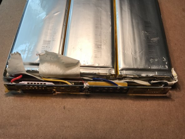

    • You can see the printed circuit board with all the electronics.
    • Always prevent the pan edge from scratching the isolation of the enameled wires between the yellow wire and the blue wire.
    • Do never go with conductive tools into the wiring maze between the cell heads and the electronic board, or you may cause a catastrophic firework that you may regret. Do not pinch or bend the electrical interconnection structure between the cell heads as long as you don't know what you're doing.

    • Mind all the transparent brown tapes that get lost easily and will hinder unsoldering of the wires. Before you do the latter, check the charge status with the electronic functionality for a last time.
  21. MacBook Pro 15" Battery Teardown: step 21, image 1 of 1
    • After having cleared the solder spots from their silicone protection, you can desolder the power wires in that sequence:
    • 1. the blue 4-V wire and the yellow 8-V wire;
  22. MacBook Pro 15" Battery Teardown: step 22, image 1 of 1
    • 2. the enameled wire that is closer to the yellow one (mark it with some duct tape as long its polarity is in doubt);
    • 3. the other enameled wire (now is opportunity for softening the pan edge with duct tape to no longer endanger the enameled wires);
    • 4. the red 12-V Wire and the black 0-V wire.
