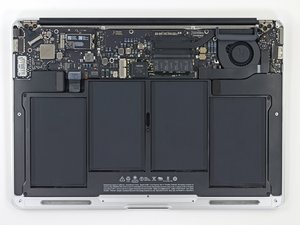

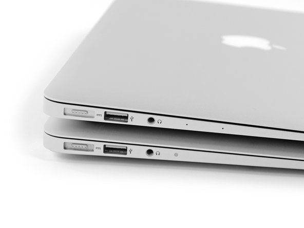

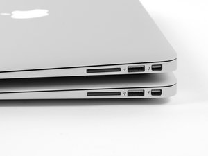

Image 1/3: The right side ports haven't changed a bit, with the new MacBook sporting the same lineup of SD card reader, USB 3.0, and Thunderbolt port. Image 2/3: A 180° rotation gives us a glimpse of the only noticeable change to the outer case: two ports for the dual microphones along the left side. Image 3/3: A 180° rotation gives us a glimpse of the only noticeable change to the outer case: two ports for the dual microphones along the left side.

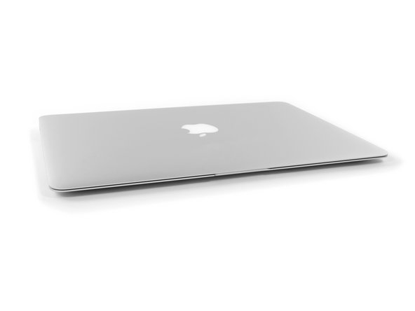

  • Externally, the 2013 MacBook Air is nearly identical to its predecessor, including the model number (A1466).
  • The right side ports haven't changed a bit, with the new MacBook sporting the same lineup of SD card reader, USB 3.0, and Thunderbolt port.
  • A 180° rotation gives us a glimpse of the only noticeable change to the outer case: two ports for the dual microphones along the left side.

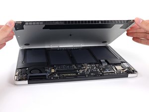

  • We heard all the new stuff was inside the computer, so we grabbed our unfortunately necessary Pentalobe bit to open 'er up.
  • As we've come to expect by now, MacBooks of all shape and size are easy to open with the appropriate tools at hand.

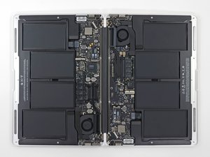

Image 1/3: Smaller SSD module Image 2/3: Updated AirPort card Image 3/3: No separate platform controller hub
  • We can spot the differences between the 2012 (left) and 2013 (right) MacBook Airs, but can you? Let's see if you see what we see.
    • Smaller SSD module
    • Updated AirPort card
    • No separate platform controller hub
    • New heat sink clamp
    • Opposite-facing speaker cable connector
  • We could nitpick the differences between the two models all day, but we'd rather get back to disassembling the new guy.

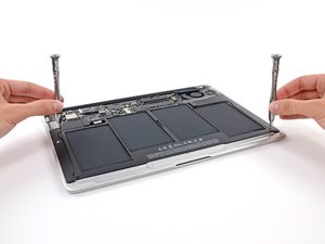

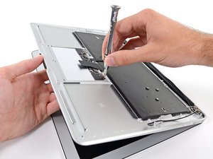

Image 1/3: ''iFixit fun fact:'' All iFixit guide makers must be ambidextrous enough to simultaneously use two screwdrivers. Image 2/3: The 7.6 V, 7150 mAh battery inside this year's Air is an upgrade from the 2012's 7.3 V, 6700 mAh power source and contributes to the claimed 12-hour battery life. Image 3/3: Increased capacity isn't the only addition to the new battery—important information is now printed in ~~Chinese~~ Korean as well as English.
  • When we want to fast-forward through battery removal we go double time on our screw removal.
    • iFixit fun fact: All iFixit guide makers must be ambidextrous enough to simultaneously use two screwdrivers.

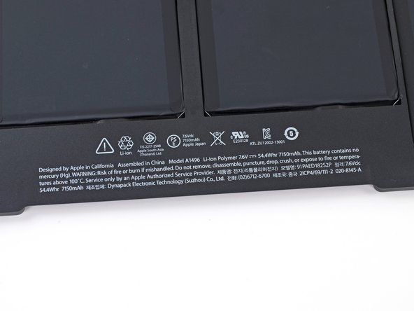

  • The 7.6 V, 7150 mAh battery inside this year's Air is an upgrade from the 2012's 7.3 V, 6700 mAh power source and contributes to the claimed 12-hour battery life.
  • Increased capacity isn't the only addition to the new battery—important information is now printed in Chinese Korean as well as English.
It's not Chinese, it is Korean
Ethan - Reply
Thanks, fixed.
Kyle Wiens -

I have a question - The 2013 model's battery looks to be the same size and shape of the 2011, 2012 (A1369) models' - Is it possible to install a 2013 model's battery in a 2011 model (for example) in order to get that coveted 12 hour battery life? Or is it more complicated than a simple swap?
Ike - Reply
Am I right in assuming that the batteries are not glued? Because that is awesome!
ch4di - Reply

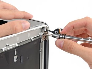

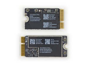

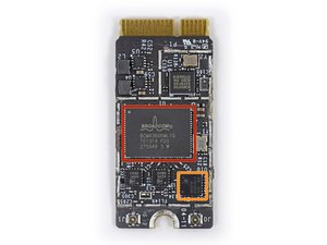

Image 1/3: While the current and prior generations' Airport cards will fit in each others' logic board slots, their different lengths will prevent you from fastening them down. We haven't yet tested for compatibility beyond this. Image 2/3: At the heart of the card we find a Broadcom [http://www.broadcom.com/products/Wireless-LAN/802.11-Wireless-LAN-Solutions/BCM4360|BCM4360|new_window=true], which enables operation on the 5 GHz band at speeds up to 1.3 Gbps and communication via Bluetooth 4.0. Image 3/3: Also on the board is a Skyworks [http://www.skyworksinc.com/uploads/documents/SE5516A_202396B.pdf|SE5516] dual-band 802.11 a/b/g/n/ac WLAN front-end module.
  • Next out is the totally redesigned AirPort card, providing 802.11ac Wi-Fi connectivity.
    • While the current and prior generations' Airport cards will fit in each others' logic board slots, their different lengths will prevent you from fastening them down. We haven't yet tested for compatibility beyond this.
  • At the heart of the card we find a Broadcom BCM4360, which enables operation on the 5 GHz band at speeds up to 1.3 Gbps and communication via Bluetooth 4.0.
  • Also on the board is a Skyworks SE5516 dual-band 802.11 a/b/g/n/ac WLAN front-end module.
Dear team iFixit. Please, for the love of god, do indeed go ahead and try your darndest to install this in the 2012 model, I will most certainly buy an 802.11ac AirPort-card from you, as well as any potential "kit" or otherwise to install it, if you end up bringing out such a product! And I know at least 5 other people who will as well!

Has anyone tried to connect a external wifi antenna? The wifi antenna connector is broken by the previous user. I am looking for 2 wifi antenna. What I want to do is to attach the wifi antenna outside the MacBook air to improve the reception.
Does any one know where to buy the antenna (only antenna, not with isight camera.....etc) ? Is Ipad antenna compatible or any other apple product?

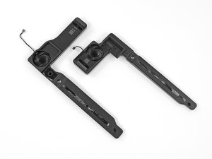

Image 1/2: Other than the aforementioned change in the direction of one of the speaker cables, these appear to be the same speakers found in last year's model. Image 2/2: Some [http://shopping.hp.com/en_US/home-office/-/static/page-beats|computer|new_window=true] and [http://www.htc.com/www/why-htc/partners/Beats/|smartphone|new_window=true] manufacturers like to emphasize an industry partner's audio systems in their marketing. Apple is not one of those companies, simply listing the noisemakers in the MacBook Air as "stereo speakers."
  • What's that sound? Oh, it's just the MacBook Air's stereo speakers.
  • Other than the aforementioned change in the direction of one of the speaker cables, these appear to be the same speakers found in last year's model.

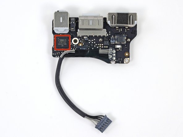

Image 1/3: We find a Cirrus chip marked 4208-CRZ next to the headphone jack. This appears to be a two-channel version of the CS4207 low power HD audio codec with headphone amp. Image 2/3: We find a Cirrus chip marked 4208-CRZ next to the headphone jack. This appears to be a two-channel version of the CS4207 low power HD audio codec with headphone amp. Image 3/3: We find a Cirrus chip marked 4208-CRZ next to the headphone jack. This appears to be a two-channel version of the CS4207 low power HD audio codec with headphone amp.
  • The I/O board in the MacBook Air is mostly unchanged from last year, except that it no longer has a socket for the iSight cable.
  • We find a Cirrus chip marked 4208-CRZ next to the headphone jack. This appears to be a two-channel version of the CS4207 low power HD audio codec with headphone amp.

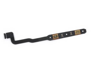

Image 1/3: As in the iPhone, the Air's dual microphones help cut out background noise while you're making a FaceTime call or dictating important memos. Image 2/3: As in the iPhone, the Air's dual microphones help cut out background noise while you're making a FaceTime call or dictating important memos. Image 3/3: As in the iPhone, the Air's dual microphones help cut out background noise while you're making a FaceTime call or dictating important memos.
  • If one microphone was good in last year's MacBook Air, then two microphones in this year's model must be better!
  • As in the iPhone, the Air's dual microphones help cut out background noise while you're making a FaceTime call or dictating important memos.

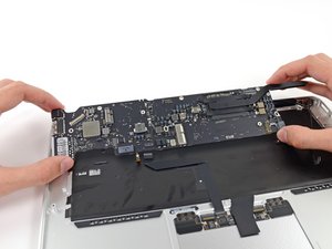

Image 1/1: 1.3GHz (with Turbo Boost up to 2.6 GHz) dual-core Intel [http://ark.intel.com/products/75028/|Core i5 processor], with integrated Intel HD graphics 5000
  • Let's take a closer look at the logic board:
    • 1.3GHz (with Turbo Boost up to 2.6 GHz) dual-core Intel Core i5 processor, with integrated Intel HD graphics 5000
    • Intel platform controller hub (unmarked)
    • Intel DSL3510L Thunderbolt controller
    • Genesis Logic GL3219 USB 3.1 Gen 1 hub controller
    • Linear Technology LT3957 inverting controller
The orange chip looks like Intel's new eDRAM module for its Iris Pro graphics.
Lucian Pacurar - Reply
No, that is correctly labelled as the platform controller hub. Before Haswell it was a separate chip package but is now situated on the same package as the CPU/GPU. The 2013 MacBook Air has Intel HD 5000 graphics, not Iris (5100) or Iris Pro (5200).
Emyr -
Error in name Thunderbolt controller. In Air 2013 is the same like Air 2012 (DSL3510L):
http://www.macwyznawca.pl/mac/files/thun...
Jaromir Kopp - Reply

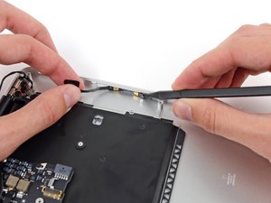

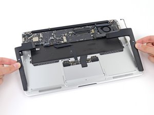

Image 1/3: In addition to a plethora of connectors, we find the following chips on the trackpad board: Image 2/3: STMicroelectronics [http://www.st.com/web/catalog/mmc/FM141/SC1169/SS1031/LN1565/PF164493|STM32F103VB|new_window=true] microcontroller Image 3/3: MXIC [http://www.macronix.com/QuickPlace/hq/PageLibrary4825740B00298A3B.nsf/h_Index/6F878CF760C559BD482576E00022E6CC/?OpenDocument&EPN=MX25L2006E|MX25L2006E|new_window=true] 2 Mb serial flash
  • As in most other unibody MacBooks, the Air's trackpad is held to the upper case with six tiny Phillips screws and comes out without much hassle.
  • In addition to a plethora of connectors, we find the following chips on the trackpad board:
  • Finally, we free the display assembly from the upper case by removing the Phillips screws that secure the two hinges.
