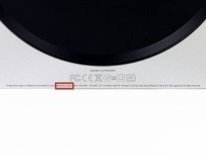

Image 1/2: The port layout is consistent with last year's model: Image 2/2: 10/100/1000BASE-T Ethernet
  • It's beginning to feel like Groundhog Day. The same model number (A1347) has graced the 2011 and 2010 Minis.
  • The port layout is consistent with last year's model:
    • 10/100/1000BASE-T Ethernet
    • FireWire 800
    • HDMI (HDMI to DVI adapter included)
    • Thunderbolt (supports high-speed I/O and Mini DisplayPort)
    • Four USB 3.0 ports (an upgrade from last year's 2.0)
    • SDXC card reader

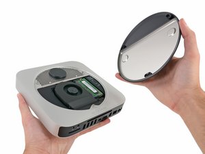

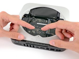

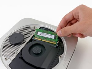

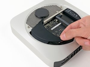

Image 1/3: A simple twist of the bottom cover and we're in. That is plus one for repairability. Image 2/3: Upgradeable RAM!! Oh, how we've [guide|11225|missed you|stepid=40246]! Image 3/3: The 2012 iteration of the Mac Mini is equipped with PC3-12800 DDR3 RAM.
  • Twist and shout!
  • A simple twist of the bottom cover and we're in. That is plus one for repairability.

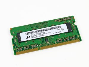

  • Upgradeable RAM!! Oh, how we've missed you!
  • The 2012 iteration of the Mac Mini is equipped with PC3-12800 DDR3 RAM.
  • It's refreshing to see an Apple product with user replaceable/upgradeable RAM.
Macbooks and iMacs are always easy to upgrade for memory..

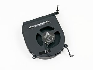

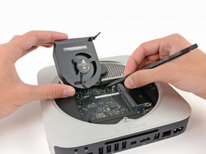

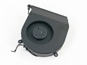

Image 1/3: Easily accessible fans mean [http://en.wikipedia.org/wiki/Susuwatari|soot sprites] better run for cover, because cleaning dirty fans is no problem. Image 2/3: Need to clean your fan? Directions can be found [http://www.wikihow.com/Clean-the-Inside-of-a-Computer|here]. Image 3/3: Need to clean your fan? Directions can be found [http://www.wikihow.com/Clean-the-Inside-of-a-Computer|here].
  • We're fans of easily removable fans.
  • Easily accessible fans mean soot sprites better run for cover, because cleaning dirty fans is no problem.
    • Need to clean your fan? Directions can be found here.
Why exactly are you fans of "upgradable fans"? Is there a need or benefit to "upgrading" the Mac mini fan. Isn't the included fan more than sufficient to the task?

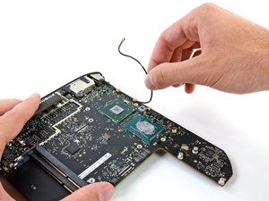

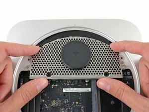

Image 1/2: We are really starting to suspect that [http://www.imdb.com/title/tt0088763/|Dr. Emmett Brown] had something to do with this Mini as the antenna board and grille look identical to the last [guide|6389|two] [guide|3111|renditions]. Image 2/2: We are really starting to suspect that [http://www.imdb.com/title/tt0088763/|Dr. Emmett Brown] had something to do with this Mini as the antenna board and grille look identical to the last [guide|6389|two] [guide|3111|renditions].
  • We remove the fan cowling, eager to get at the Wi-Fi antenna plate.
  • We are really starting to suspect that Dr. Emmett Brown had something to do with this Mini as the antenna board and grille look identical to the last two renditions.
  • Here we find the legendary Mac Mini logic board removal tool in its natural habitat.
    • Note the ease of use as the tool swoops in to release the logic board of the Mini.

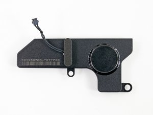

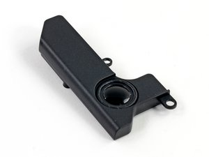

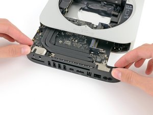

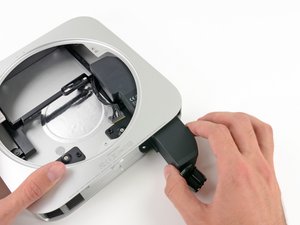

Image 1/3: The speaker cable was arranged in a [http://en.wikipedia.org/wiki/Twisted_pair|twisted pair], probably to reduce EMI that could distort the sweet, iconic tones of the [http://www.youtube.com/watch?feature=player_detailpage&v=_868pOOsxgs#t=22s|Apple startup sound]. Image 2/3: The speaker cable was arranged in a [http://en.wikipedia.org/wiki/Twisted_pair|twisted pair], probably to reduce EMI that could distort the sweet, iconic tones of the [http://www.youtube.com/watch?feature=player_detailpage&v=_868pOOsxgs#t=22s|Apple startup sound]. Image 3/3: The speaker cable was arranged in a [http://en.wikipedia.org/wiki/Twisted_pair|twisted pair], probably to reduce EMI that could distort the sweet, iconic tones of the [http://www.youtube.com/watch?feature=player_detailpage&v=_868pOOsxgs#t=22s|Apple startup sound].
  • The first component off the logic board assembly is the speaker assembly.
  • The speaker cable was arranged in a twisted pair, probably to reduce EMI that could distort the sweet, iconic tones of the Apple startup sound.

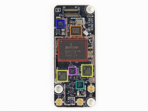

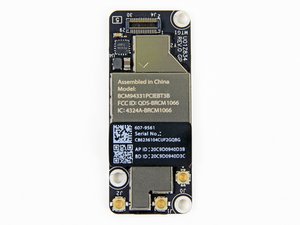

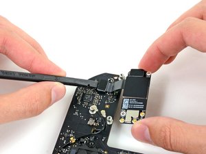

Image 1/3: Removing the EMI shields allows us to peek at the ICs on the communications board: Image 2/3: Broadcom [http://www.broadcom.com/products/Wireless-LAN/802.11-Wireless-LAN-Solutions/BCM4331|BCM4331] 802.11 a/b/g/n Wi-Fi chip Image 3/3: Broadcom [http://www.broadcom.com/products/Bluetooth/Bluetooth-RF-Silicon-and-Software-Solutions/BCM20702|BCM20702] Bluetooth 4.0 transmitter
  • The Wi-Fi board, labeled BCM94331PCIEBT3B, stands no chance against our spudger as we make it truly wireless.
  • Removing the EMI shields allows us to peek at the ICs on the communications board:
    • Broadcom BCM4331 802.11 a/b/g/n Wi-Fi chip
    • Broadcom BCM20702 Bluetooth 4.0 transmitter
    • SiGe 5503A 2304A Dual Band 802.11a/b/g/n Wireless LAN Front End
    • SiGe 2598L
    • P2303A TUB2P
    • 7871 1228 C6050
SiGe 2598L - SE2598L 2.4 GHz Power Amplifier with Power Detector

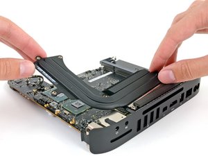

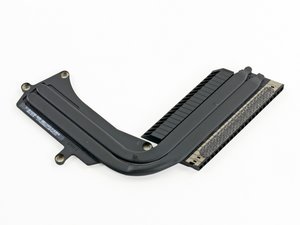

Image 1/2: Apple has really keyed in on their boomerang-style heat sink abilities—and for that, we applaud them. We know boomerangs can be [http://www.youtube.com/watch?v=ZIey192juAo|tough to master]. Image 2/2: [guide|6131|Similar, again!|stepid=26685] We have not tried installing old 2011 Mini parts in the 2012 Mini, but we are certainly not ruling out the possibility!
  • The heat sink is next to go.
  • Apple has really keyed in on their boomerang-style heat sink abilities—and for that, we applaud them. We know boomerangs can be tough to master.
  • Similar, again! We have not tried installing old 2011 Mini parts in the 2012 Mini, but we are certainly not ruling out the possibility!

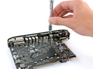

Image 1/3: A few twists of our [http://www.ifixit.com/Tools/54-Bit-Driver-Kit/IF145-022|precision aluminum driver with a T6 Torx bit] and some cable de-routing is all it takes to remove the shield. Image 2/3: A few twists of our [http://www.ifixit.com/Tools/54-Bit-Driver-Kit/IF145-022|precision aluminum driver with a T6 Torx bit] and some cable de-routing is all it takes to remove the shield. Image 3/3: A few twists of our [http://www.ifixit.com/Tools/54-Bit-Driver-Kit/IF145-022|precision aluminum driver with a T6 Torx bit] and some cable de-routing is all it takes to remove the shield.
  • A series of screws and tightly wrapped antenna cables secure the rear I/O panel shield to the logic board.
  • A few twists of our precision aluminum driver with a T6 Torx bit and some cable de-routing is all it takes to remove the shield.

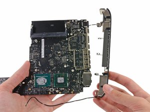

Image 1/1: Cirrus Logic 4206B Audio Controller
  • Some mini players on the top of the not-so-mini logic board:
    • Cirrus Logic 4206B Audio Controller
    • SMSC USB2512B USB Hub Controller
    • Broadcom BCM57765 gigabit ethernet and memory card controller
    • Intel L232TB45 Thunderbolt Port Controller
    • LSI L-FW643E-2
    • DELTA 8904C-F Filter

Image 1/1: Intel HM77 (SLJ8C) platform controller hub
  • The rear side of the logic board:
    • Intel HM77 (SLJ8C) platform controller hub
    • Intel V227C254 2.5 GHz dual-core i5
    • SMSC 1428-7 system management bus temperature sensor
    • Parade PS8401A HDMI/DVI level shifter

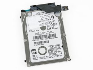

Image 1/2: Our model came with a 500 GB Hitachi hard drive. Image 2/2: The Mini is one of the Macs launched with the [http://www.washingtonpost.com/business/technology/what-is-apples-fusion-drive-and-how-does-it-work/2012/10/25/9f86b330-1e08-11e2-ba31-3083ca97c314_story.html|Fusion Drive].
  • Tucked away neatly near the rear of the Mini is the hard drive.
  • Our model came with a 500 GB Hitachi hard drive.
  • The Mini is one of the Macs launched with the Fusion Drive.
Wheres the ssd?It that a non fusion drive model, or it is build into the hard drive?
Honam1021 - Reply
Can you verify the data rate of the I/O is it SATA-3?
Dan - Reply
Based on the spec of Mac mini 2012, looks like 500GB is not fusion drive, I think.
http://store.apple.com/us/browse/home/sh...
Liang Qi - Reply
What is the maximum hard drive height if one is looking for a replacement? I see the drive you have is 7mm, but is there any wiggle room to go higher?
Jeradw - Reply
MacRumors: Apple's New Fusion Drive Works on Older Macs
http://www.macrumors.com/2012/10/31/appl...
Liang Qi - Reply

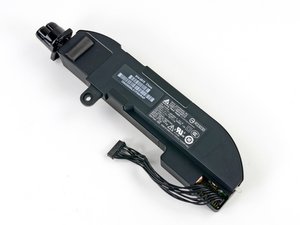

Image 1/3: It is beginning to feel repetitive to say how repetitive Apple is in the design of the Mini; nonetheless, the power supply appears identical to [guide|6131|last year's model|stepid=26693]. Image 2/3: In this case, we have to say that repetition is a good thing, as the Mini continues to be one of the most repairable devices that Apple produces. Image 3/3: Just like last year, the power supply provides 85 watts to the Mac Mini—that's the same kind of electric juice as the [product|IF113-045|AC adapter] for a 15" or 17" MacBook Pro.
  • Next up, we displace the power of the Mini.
  • It is beginning to feel repetitive to say how repetitive Apple is in the design of the Mini; nonetheless, the power supply appears identical to last year's model.
    • In this case, we have to say that repetition is a good thing, as the Mini continues to be one of the most repairable devices that Apple produces.
  • Just like last year, the power supply provides 85 watts to the Mac Mini—that's the same kind of electric juice as the AC adapter for a 15" or 17" MacBook Pro.
We can clearly see this is an international PSU. Switching power supply, 110-240V, meaning it can be used in Norway, UK as well as USA. Using the proper cord of course, which is so different.
amazonborga - Reply

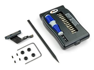

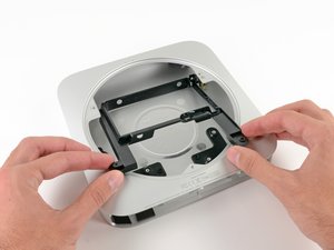

Image 1/3: Following along with our own [guide|6634|guide] for the 2011 model was a snap, and everything fit perfectly. Image 2/3: After a quick reassembly, we booted this guy up for the first time—with 50% extra storage. Success! Image 3/3: After a quick reassembly, we booted this guy up for the first time—with 50% extra storage. Success!
  • We were especially curious to see if this new Mac Mini is still compatible with our dual hard drive upgrade kit, so we got to testing it!
  • Following along with our own guide for the 2011 model was a snap, and everything fit perfectly.
  • After a quick reassembly, we booted this guy up for the first time—with 50% extra storage. Success!

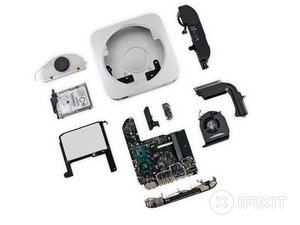

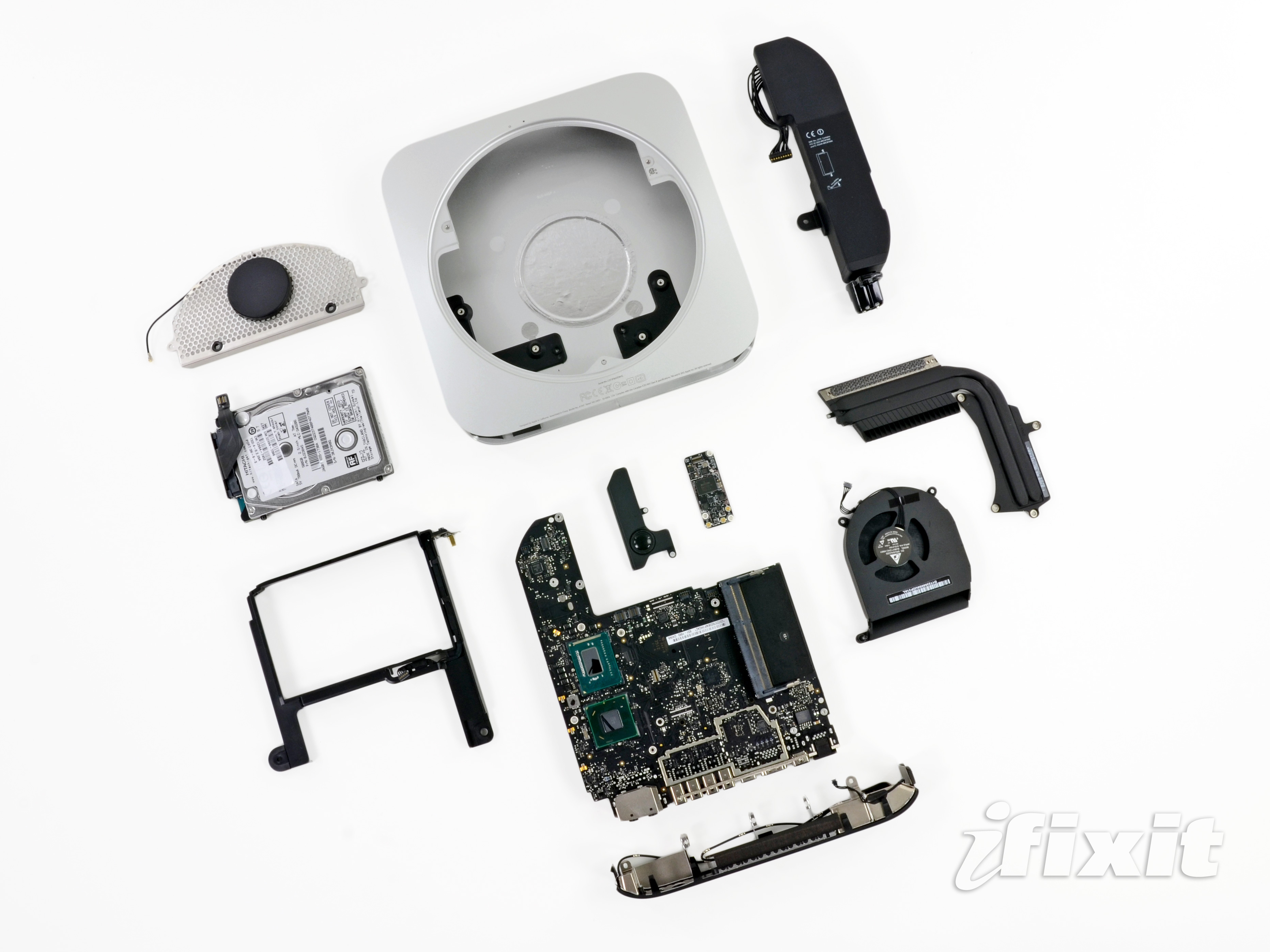

Image 1/2: No proprietary screws are found within the device. Image 2/2: You can easily upgrade your RAM and hard drive, as well as add a secondary drive.
  • Mac Mini Mid 2012 Repairability: 8 out of 10 (10 is easiest to repair).
    • No proprietary screws are found within the device.
    • You can easily upgrade your RAM and hard drive, as well as add a secondary drive.
    • There's no glue anywhere inside that needs to be removed while disassembling the Mini.
    • The CPU is soldered to the logic board and not user-upgradeable.
    • While not difficult to do, you still have to remove almost all the internals in order to replace the power supply.
