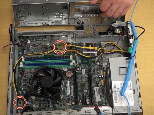

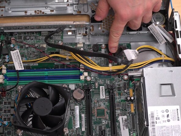

  5. Lenovo M910S Teardown, Remove cables: step 5, image 1 of 3 Lenovo M910S Teardown, Remove cables: step 5, image 2 of 3 Lenovo M910S Teardown, Remove cables: step 5, image 3 of 3
    • Remove all the cables as shown in the photos.
    • Then, remove the RAM as shown in the last photo.

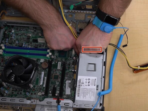

  6. Lenovo M910S Teardown: step 6, image 1 of 2 Lenovo M910S Teardown: step 6, image 2 of 2
    • Now, remove the PSU via the 3 screws on the back of the computer.
    • Then, press down on the metal latch inside the bottom of the case to remove the power supply.
    Ask FixBot
