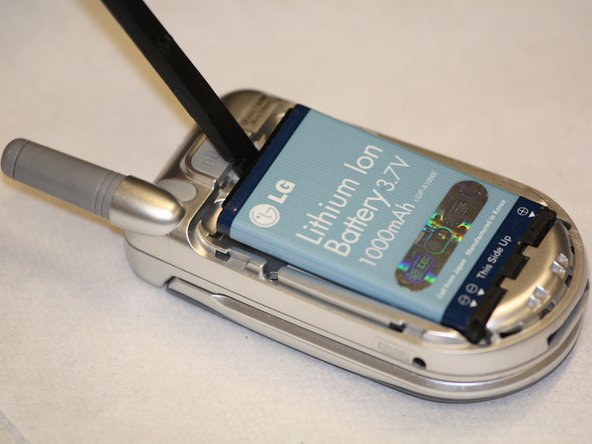

From the lip on the top of the battery, lift it out of the phone.
  • From the lip on the top of the battery, lift it out of the phone.

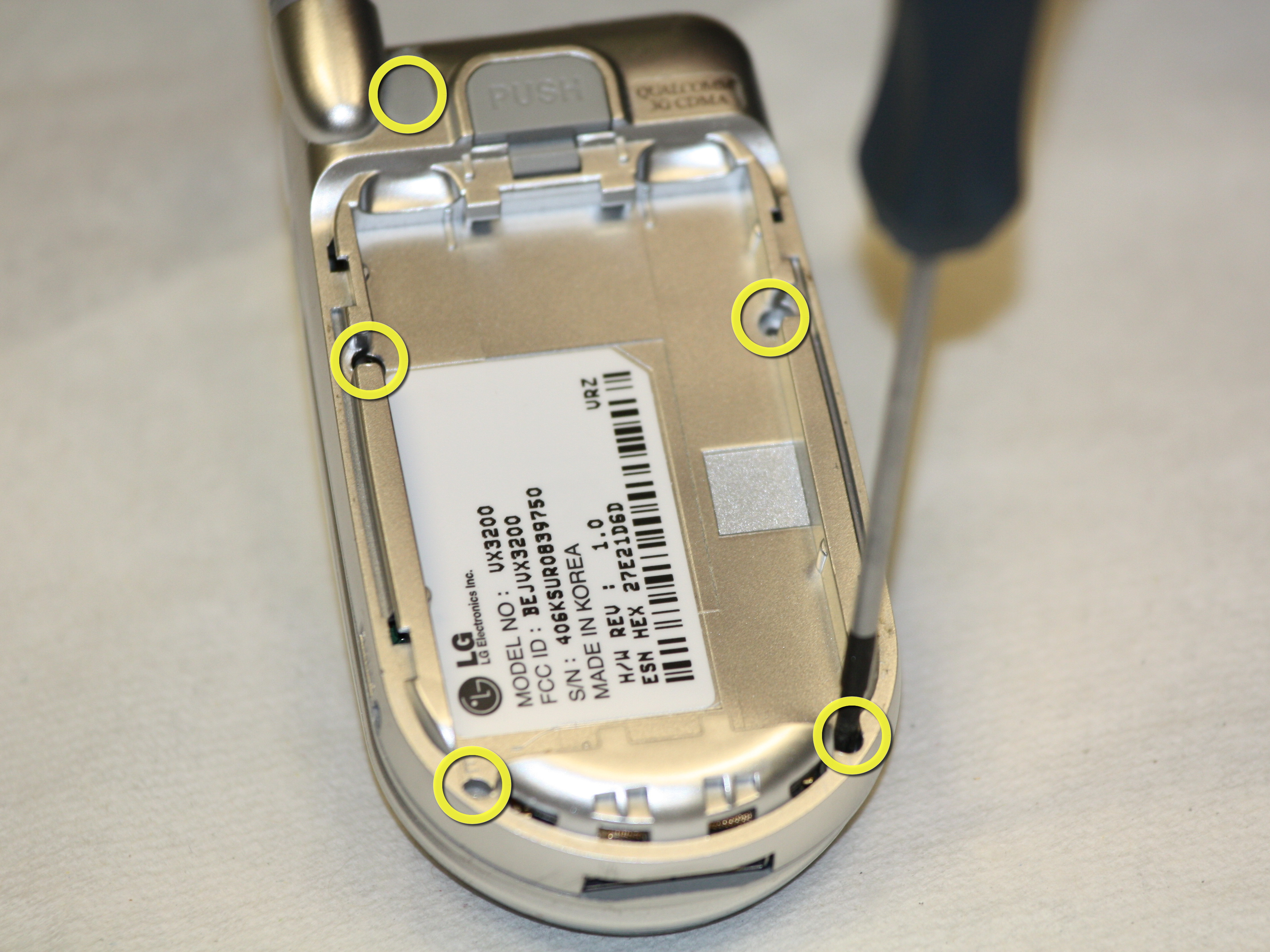

Remove the 5 small screws from the back panel, under the battery.
  • Remove the 5 small screws from the back panel, under the battery.
  • There is a hidden screw under the rubber pad next to the antenna. To remove this pad use a screwdriver to pry out rubber.

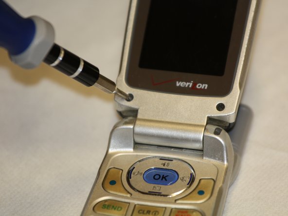

In order to remove the back panel of the screen half of the phone, you have to remove the 4 screws.
  • In order to remove the back panel of the screen half of the phone, you have to remove the 4 screws.
  • First, open the phone and remove the 4 rubber pads that are around the screen. you can use a small screwdriver or a pin to pop them out.
Remove the 4 screws using your Phillips head screwdriver.
  • Remove the 4 screws using your Phillips head screwdriver.
