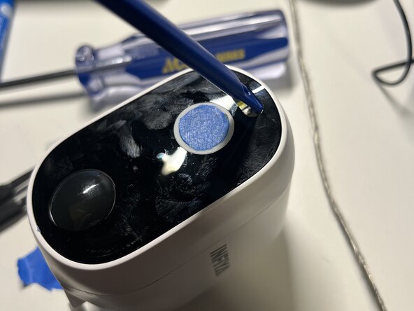

  2. INFIYA Z1 Teardown, Pull out LED cover/plug: step 2, image 1 of 1
    • Carefully remove the LED 'plug' as shown
  3. INFIYA Z1 Teardown, Remove faceplate: step 3, image 1 of 2 INFIYA Z1 Teardown, Remove faceplate: step 3, image 2 of 2
    • Use a tool to carefully lever the faceplate away from the body of the device. Peel the face plate off - It acts like a giant sticker. Remove it slowly to avoid tearing / leaving residue.

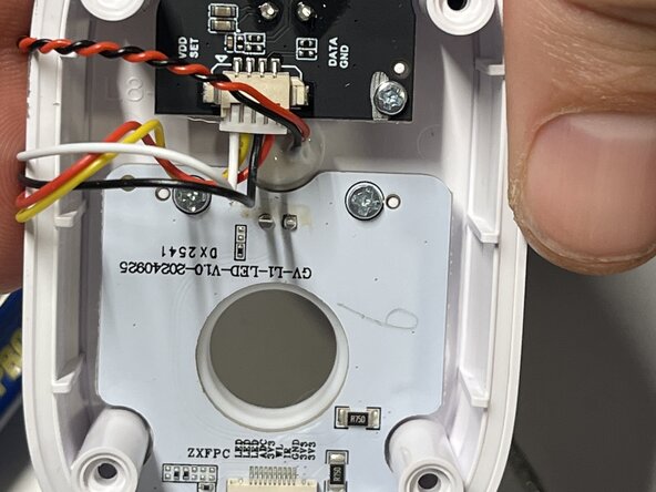

  4. INFIYA Z1 Teardown, Remove front enclosure cover: step 4, image 1 of 3 INFIYA Z1 Teardown, Remove front enclosure cover: step 4, image 2 of 3 INFIYA Z1 Teardown, Remove front enclosure cover: step 4, image 3 of 3
    • There are 4 phillips head screws. Remove them.
    • Carefully remove the front cover of the enclosure. There are several wires attached.
    • Use a small flat head screwdriver to pop out the two non-ribbon connectors that connect the body of the camera to the front cover.
  5. INFIYA Z1 Teardown, Main Circuit Board: step 5, image 1 of 3 INFIYA Z1 Teardown, Main Circuit Board: step 5, image 2 of 3 INFIYA Z1 Teardown, Main Circuit Board: step 5, image 3 of 3
    • That's it. Here are some pics of the main circuit board.
    • Ingenic T23 4011122112601A01 - ZN 211230724DB712
    • ATBM6441 CH2 CF30Y15 C30YG2
    • 1P5209 5117.1CAU
    • P24C02A
