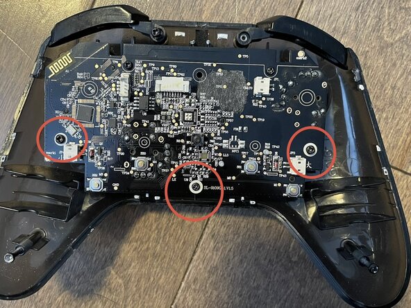

  7. GameSir T4 Pro Teardown, Removing the motherboard: step 7, image 1 of 2 GameSir T4 Pro Teardown, Removing the motherboard: step 7, image 2 of 2
    • There are three screws holding the motherboard in place: two long ones and a short one. After removing them you can remove the motherboard.

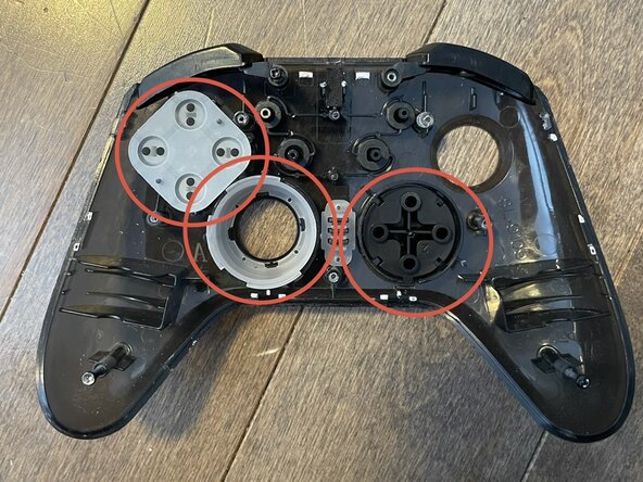

  8. GameSir T4 Pro Teardown, Removing the rest of the front panel: step 8, image 1 of 3 GameSir T4 Pro Teardown, Removing the rest of the front panel: step 8, image 2 of 3 GameSir T4 Pro Teardown, Removing the rest of the front panel: step 8, image 3 of 3
    • Now to completely remove the buttons. (Bumpers, ABYX, and D-Pad) Take the front panel and remove the rest of the button just by pulling them out. They’re very easy to take out.

  10. GameSir T4 Pro Teardown, Removing the D-Pad membrane: step 10, image 1 of 2 GameSir T4 Pro Teardown, Removing the D-Pad membrane: step 10, image 2 of 2
    • Pull the membrane buttons off of the motherboard.
