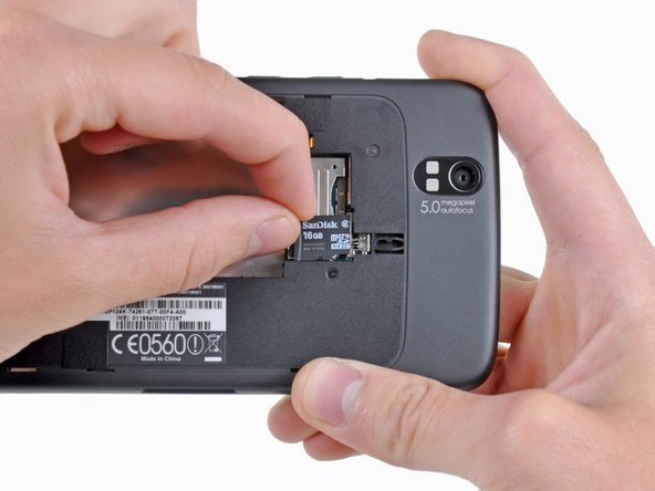

    • After the rear panel is gone, the battery can be easily removed from its home.
    • The Streak's 3.7 V 1530 mAh (5.66 Whr) battery reportedly powers the gargantuan device for...well...we don't know how long.
      • The fact that Dell didn't publish the battery life hints at the fact that it isn't too great. What do you expect from a 5" display?
    • The inner face of the battery is covered with a sheet of steel, rather than plastic, to decrease its overall thickness. Perhaps the Streak also doubles as body armor?
    • After the battery is removed, the pre-installed 16 GB microSD card can be slid out of its socket.

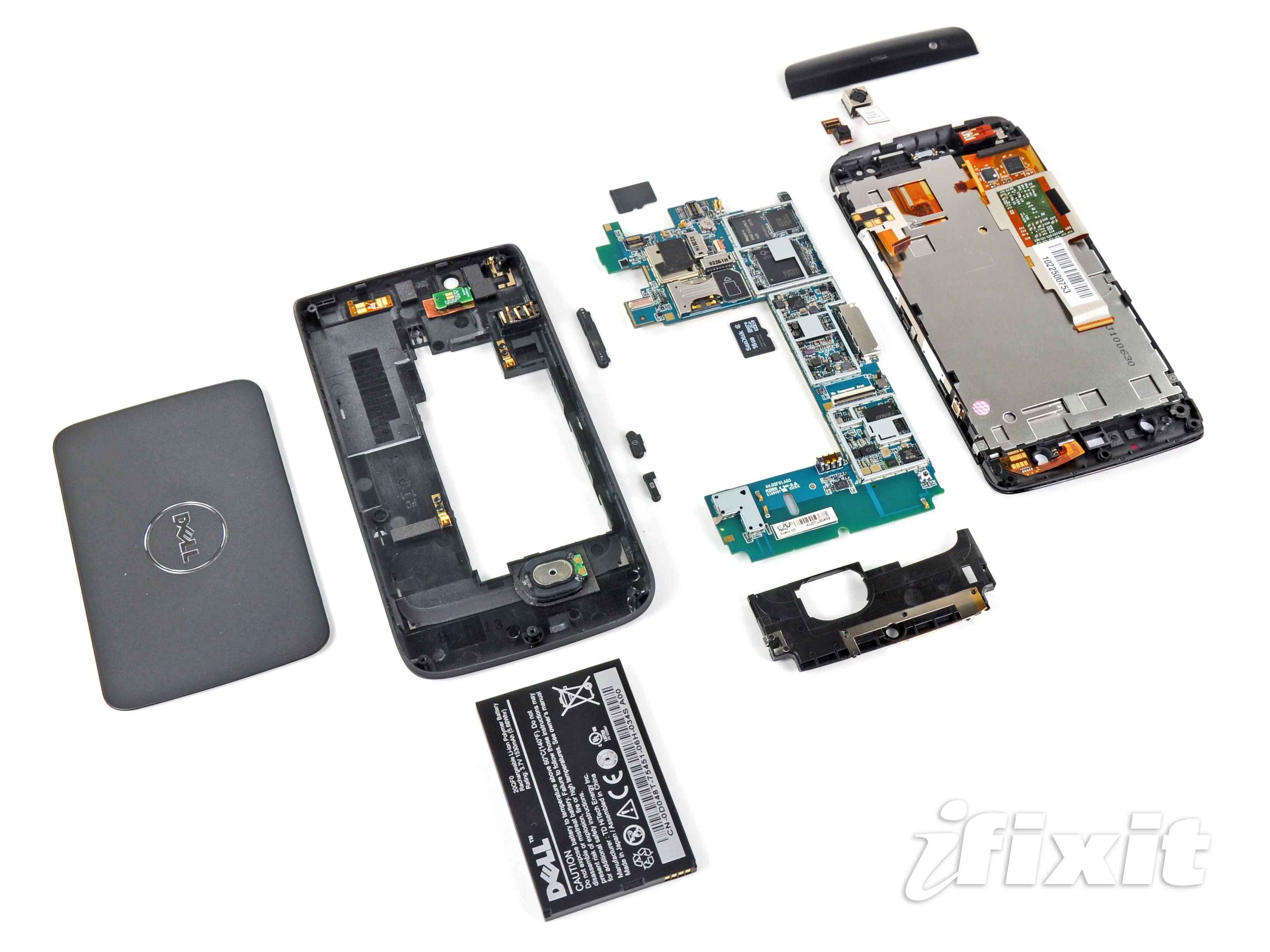

    • The rear case houses many components, including:
      • LED flash
      • Headphone jack
      • Loudspeaker (for speakerphone)
      • Antennas

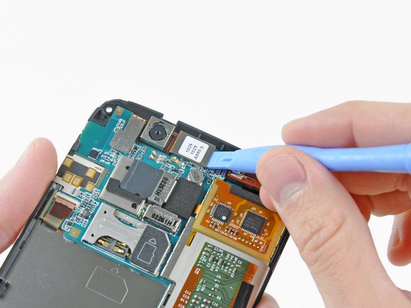

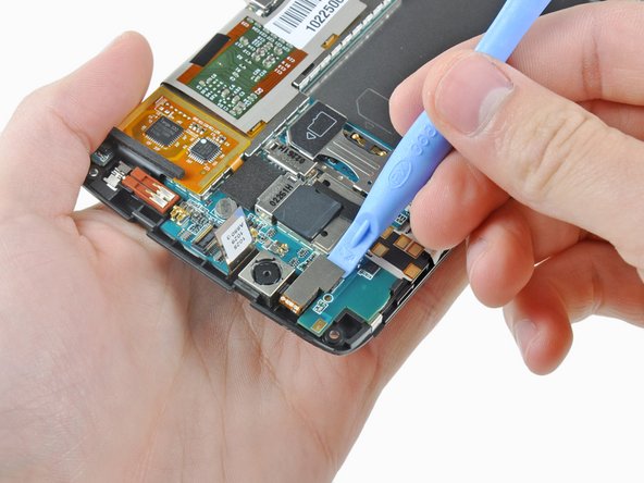

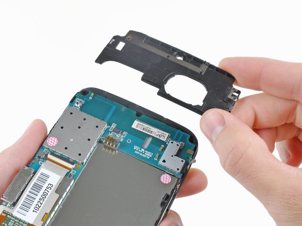

    • The digging continues as we remove a small plastic bezel attached to the lower edge of the motherboard.
    • At this point, both the front-facing and rear-facing cameras can be disconnected from the motherboard.
    • Before lifting out the motherboard, the touchscreen, LCD, and control button ribbon cables must be disconnected.
    • The "C"-shaped motherboard comes out easily. Rather than using daughterboards like the Droid 2, the Streak has all components attached to this singular motherboard.
