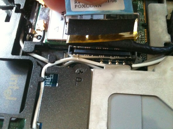

  5. Dell Latitude D620 Teardown, Display Connector: step 5, image 1 of 2 Dell Latitude D620 Teardown, Display Connector: step 5, image 2 of 2
    • Grab the top of the display connector and pull it straight up and out.
    • This connector requires a little more force than the others, so it may take some effort.

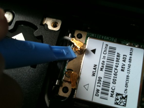

  6. Dell Latitude D620 Teardown, WLAN Card Antenna Removal: step 6, image 1 of 3 Dell Latitude D620 Teardown, WLAN Card Antenna Removal: step 6, image 2 of 3 Dell Latitude D620 Teardown, WLAN Card Antenna Removal: step 6, image 3 of 3
    • Use a tool or your fingers to gently remove the antenna cables from the wireless card.

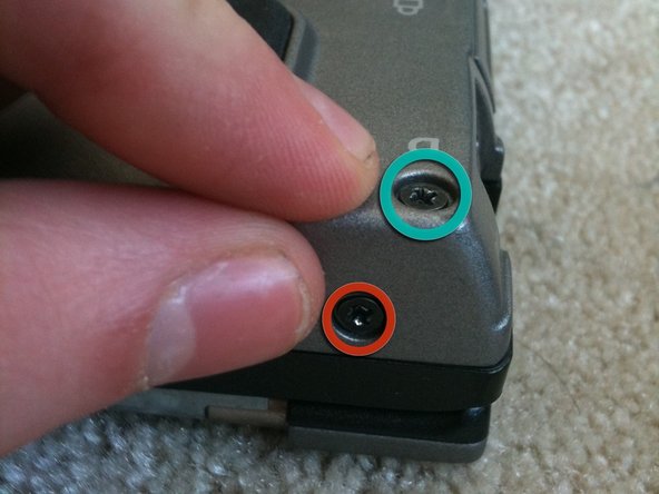

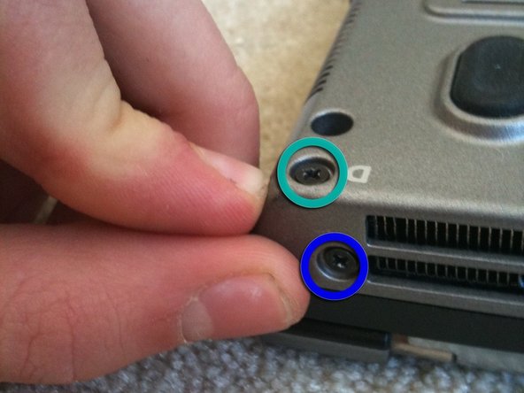

  9. Dell Latitude D620 Teardown, LCD Screws: step 9, image 1 of 2 Dell Latitude D620 Teardown, LCD Screws: step 9, image 2 of 2
    • Close the laptop screen completely, make sure it clips in place.
    • Follow the Green bullet first then move onto the Blue bullet.
    • Make sure no cables or parts get caught in the hinge.
    • The bottom screw is labeled with D, remove it.
    • The screw on the rear is not labeled, remove it as well.
    • Repeat this for the opposite side of the laptop.

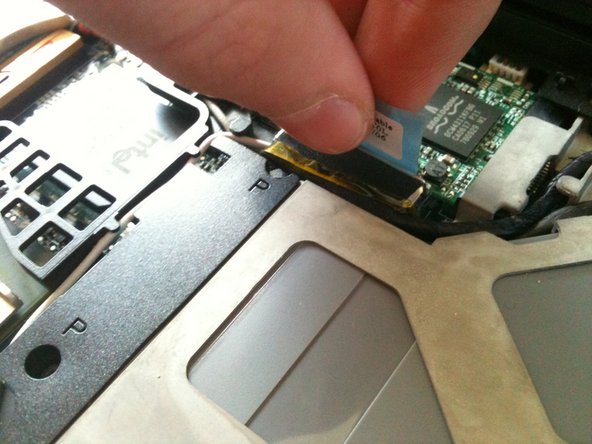

  11. Dell Latitude D620 Teardown, Remaining Screw Removal: step 11, image 1 of 3 Dell Latitude D620 Teardown, Remaining Screw Removal: step 11, image 2 of 3 Dell Latitude D620 Teardown, Remaining Screw Removal: step 11, image 3 of 3
    • Remove all of the remaining screws on the laptop with a Phillips screwdriver.
    • There are screws on the top under the keyboard as well, remove those.
    • All of the screws with a P by them means they secure the palmrest. This will help you keep organized.
