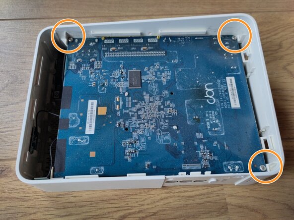

  3. Compal CH7465LG-ZG Teardown, remove the circuit board: step 3, image 1 of 3 Compal CH7465LG-ZG Teardown, remove the circuit board: step 3, image 2 of 3 Compal CH7465LG-ZG Teardown, remove the circuit board: step 3, image 3 of 3
    • Remove the side panel.
    • Using the T10 screwdriver, unscrew the 3 screws attaching the board to the case.
    • Use the spudger to unclip the board, and while removing the board from the case, remove the attachments.
