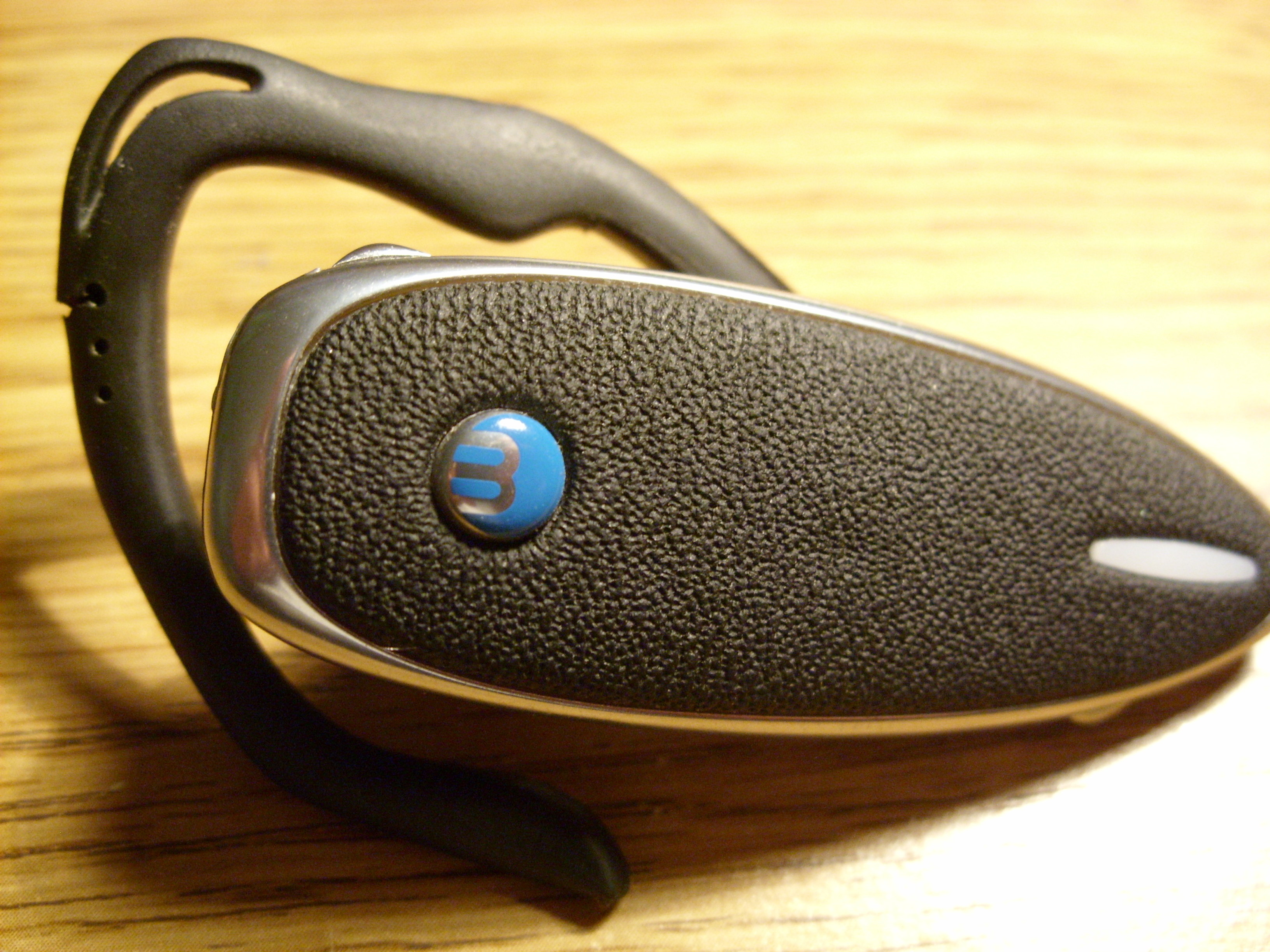

  1. Bluetrek Skin Teardown, Bluetrek Skin Teardown: step 1, image 1 of 3 Bluetrek Skin Teardown, Bluetrek Skin Teardown: step 1, image 2 of 3 Bluetrek Skin Teardown, Bluetrek Skin Teardown: step 1, image 3 of 3
    • It puts the lotion on its skin... Or else it gets the hose again.
    • In the last photo, I'm removing the removable ear clip. Don't worry, it gets better.
