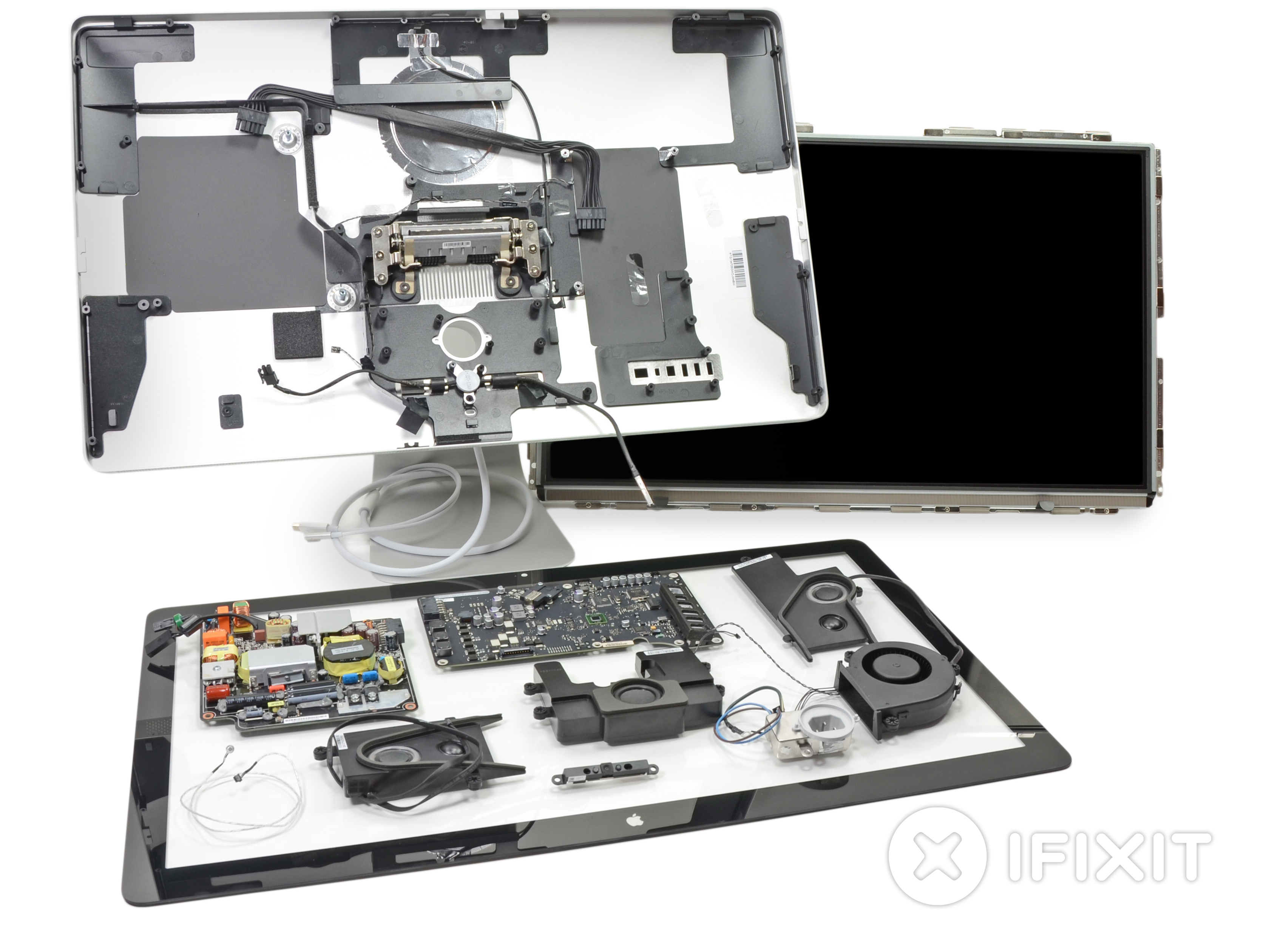

Great Odin's Raven! With that old, crappy LCD removed (who needs it anyway), we get a full frontal view of the Thunderbolt Display's inner layout.
Where to start . . . the fan you say? Sounds good to us.
The fan is easily removed simply by detaching a couple of connectors and unfastening a few screws.
Apple has, as usual, chosen to go with a large, brushless fan to keep the colossal Thunderbolt Display nice and cool.

St. Damien's beard! The front of the logic board includes these stellar packages:
Pericom PI7C9X440SL PCIe-to-USB 2.0 host controller
L129NB11 EFL, which looks to be the Thunderbolt port controller (as viewed in the second picture)
Analog Devices ADAV4601 audio processor
NXP LPC2144 USB 2.0 microcontroller
Delta LFE9249 10/100/1000 Base-T LAN filter
SMSC USB2517-JZX USB 2.0 hub controller
LPC 1114F
Sweet grandmother's spatula! The back of the board also contains oodles of chips:
Maxim MAX9736B Mono/Stereo High-Power Class D Amplifier
Texas Instruments LC573A D-type Latch
Silego SLG8SP568VCK505 Clock Generator
LSI L-FW643E-2 Open Host Controller Interface
Broadcom BCM57761 Gigabit ethernet controller
Texas Instruments NH245 Dual Supply Translator
Supertex HV9982 3-channel switch-mode LED driver IC

Thunderbolt Display Repairability Score: 8 out of 10 (10 is easiest to repair)
Only T6 and T10 torx screws hold it together, meaning minimal tooling is required to service.
Minimal use of adhesives means reassembly will be easier and cleaner.
Front glass panel and LCD are easy to remove and major components are exposed upon removal.
You have to use suction cups to remove the front glass, which could end poorly if not done properly.
While disassembly was very straightforward, there are a lot of parts, cables and connectors, making full reassembly not for the faint of heart.
