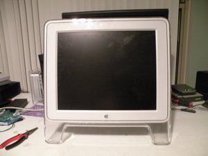

The Apple 17" ADC Studio Display, looking displays Apple has ever produced. This Display was designed to match the clear acrylic aesthetic qualities of G4-based Macs, so much that Apple made it so that it would only work on Powermac G4's And Early G5's and to use it on a PC or ibook or powerbook you need a ADC to DVI Adaptor available only from apple. This display does have numerous technical issues though. The backlight inverters tend to fail, and on the LDC panel has been known to fail under certian operating enviroments. Even though, this display looks great, and has crystal clear images and came in 15", 17" and a whooping 23" this display is great because of the ADC connector, it carries power, signal, and USB to the display so there is less cable clutter, this is reminicant of NeXT Workstation MegaPixel Displays. And, for those of you wondering, ADC stands for Apple Display Connector, Apple and their proprietary connectors...

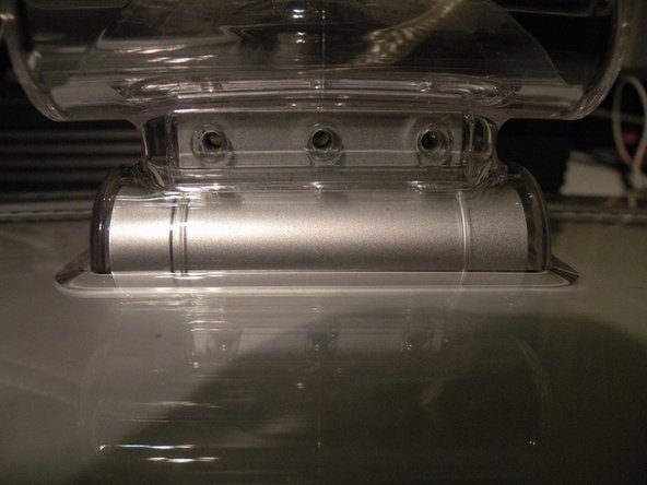

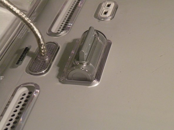

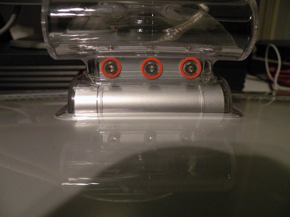

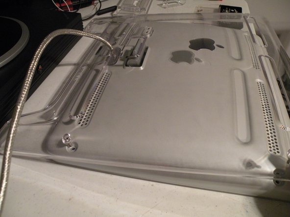

Image 1/3: Remove these 3 hex screws on the swing arm of the display. Image 2/3: Then remove the swing arm, and the piece of plastic underneath it. Image 3/3: Then remove the swing arm, and the piece of plastic underneath it.
  • Start by fliping the display so it is face down.
  • Remove these 3 hex screws on the swing arm of the display.
  • Then remove the swing arm, and the piece of plastic underneath it.

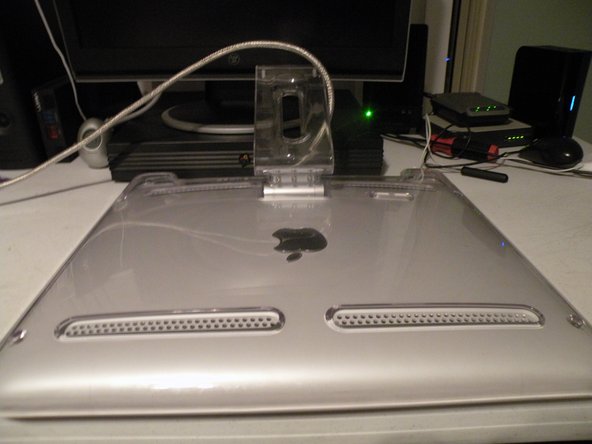

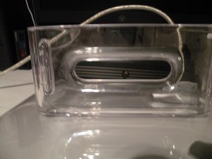

Image 1/2: The Piece of plastic under the swing arm, you need to remove this(2nd Photo). Image 2/2: The Piece of plastic under the swing arm, you need to remove this(2nd Photo).
  • The Swing Arm:
  • The Piece of plastic under the swing arm, you need to remove this(2nd Photo).

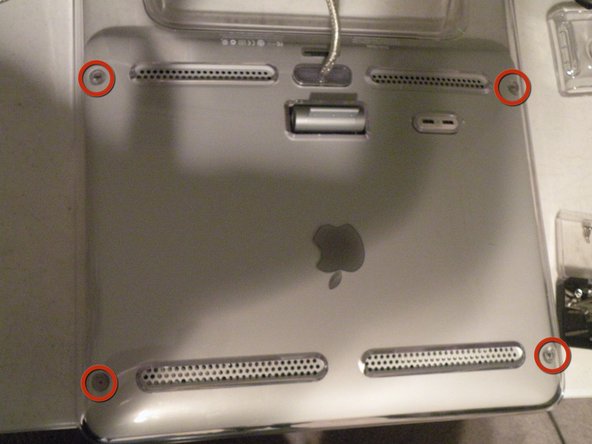

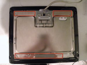

Image 1/3: Then lift the panel from the top of the display. Image 2/3: Then lift the panel from the top of the display. Image 3/3: Then lift the panel from the top of the display.

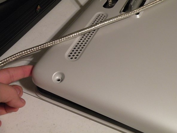

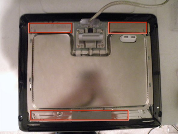

  • To remove the back panel, remove these hex screws.
  • Then lift the panel from the top of the display.
Image 1/3: Grasp the bottom of the 2nd panel and lift it up, route the ADB cable through the hole. Image 2/3: This will reveal a shiney metal panel. Image 3/3: There may be tape here, remove it.

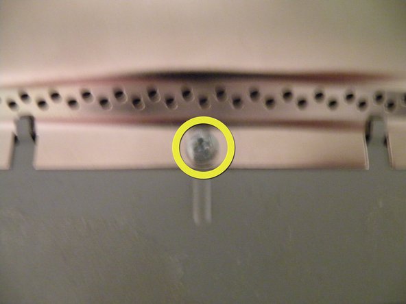

  • Removing the 2nd panel:
  • Grasp the bottom of the 2nd panel and lift it up, route the ADB cable through the hole.
  • This will reveal a shiney metal panel.
  • There may be tape here, remove it.
  • Remove this screw.

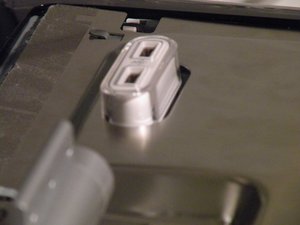

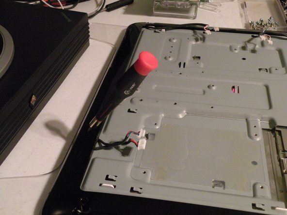

Image 1/3: After the tape and screw is removed, slide the panel towards you and lift it out. Image 2/3: Also, remove the clear USB port cover. Image 3/3: We now have full access to the electronics.

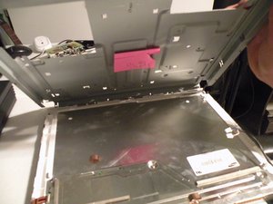

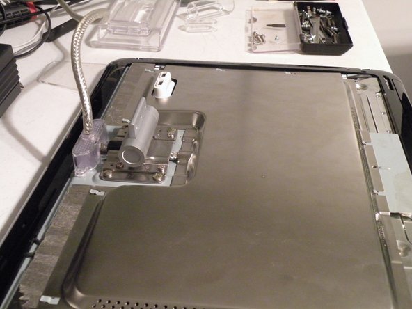

  • Removing the metal shield:
  • After the tape and screw is removed, slide the panel towards you and lift it out.

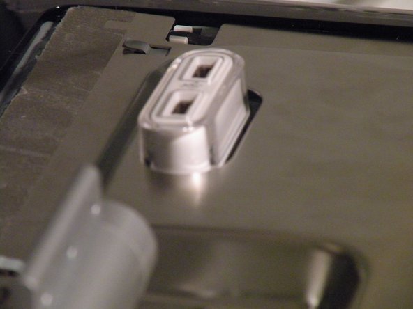

  • Also, remove the clear USB port cover.
  • We now have full access to the electronics.

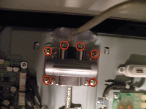

  • To partially free the ADC cable, remove these 6 phillips screws, than remove the metal hinge and the cable elbow.

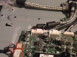

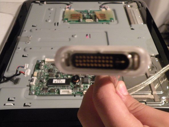

Image 1/2: Remove these phillips screws. Image 2/2: Remove these 3 connectors CareFully!
  • Removing the ADC Cable:
  • Remove these phillips screws.
  • Remove these 3 connectors CareFully!
  • The ADC cable should now be free from the rest of the monitor.
  • Remove this cable as well.
  • The ADC Cable, similar to DVI, provides power, signal, and USB to the display (2nd Photo).

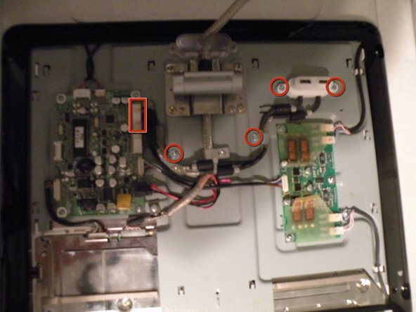

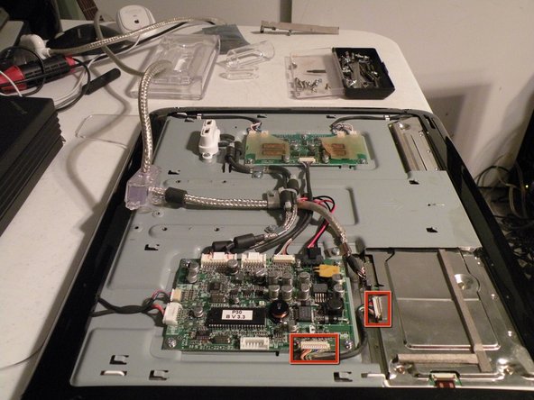

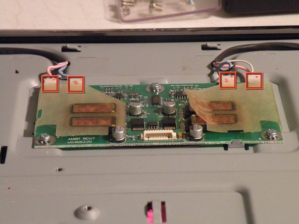

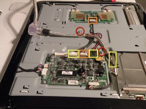

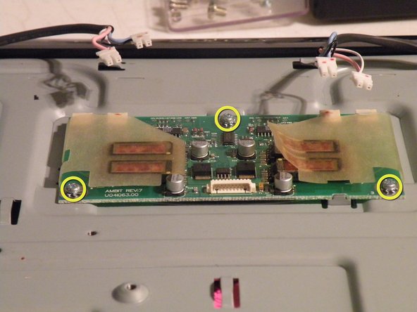

Image 1/3: Remove these 4 connectors, it is important to remeber their order! Image 2/3: Remove these 3 phillips screws. Image 3/3: Remove these 3 phillips screws.

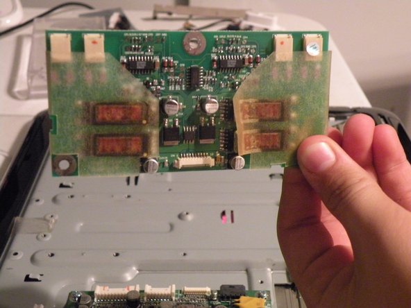

  • Removing the backlight inverter:
  • Remove these 4 connectors, it is important to remeber their order!
  • Remove these 3 phillips screws.

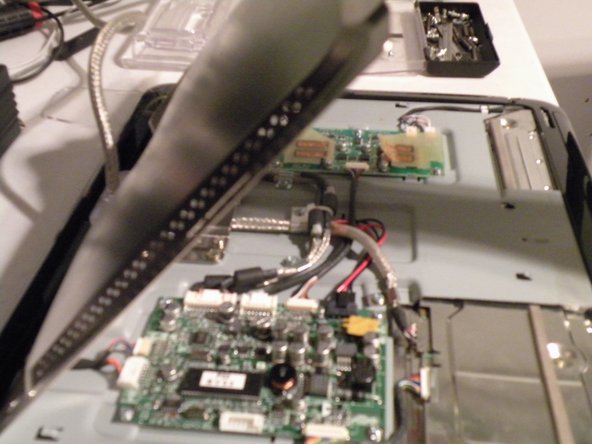

Image 1/2: Remove these two connectors. Image 2/2: This one too!

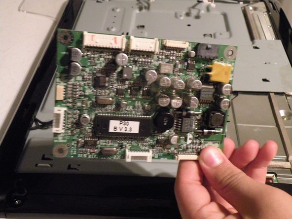

  • Removing the logic board:
  • Remove these two connectors.
  • This one too!

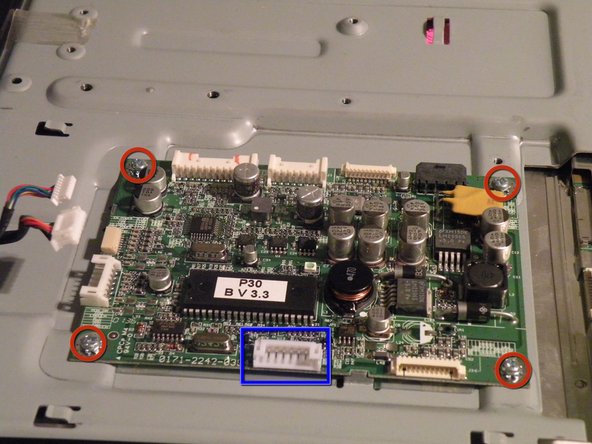

Image 1/2: Remove these 4 phillips screws. Image 2/2: This connector isn't used, it is left disconnected, I am assuming that it is to test the display for Apple.
  • Remove these 4 phillips screws.
  • This connector isn't used, it is left disconnected, I am assuming that it is to test the display for Apple.
  • Lift the logic board out if the case and set it aside.

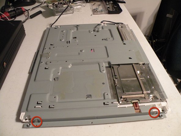

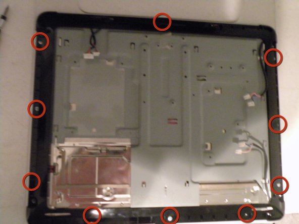

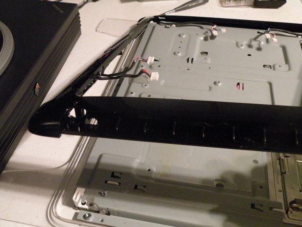

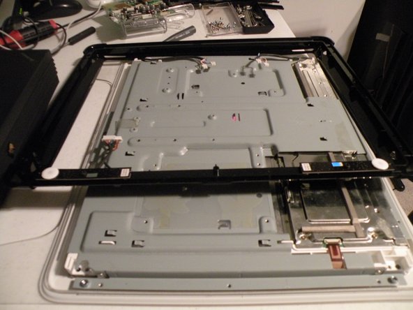

Image 1/3: Using a flathead screwdriver, or spudger, remove the 4 pieces of plastic around the black frame. Image 2/3: This will reveal numerous phillips screws. Image 3/3: Remove them all.
  • Removing the inner rim and button assembly:
  • Using a flathead screwdriver, or spudger, remove the 4 pieces of plastic around the black frame.
  • This will reveal numerous phillips screws.
  • Remove them all.
Image 1/2: Image 2/2:
  • Once all of the screws are removed, lift the rim out.

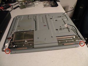

Image 1/3: Remove all of these screws from the metal frame. Image 2/3: Remove all of these screws from the metal frame. Image 3/3: Remove all of these screws from the metal frame.
  • Removing the LCD Panel
  • Remove all of these screws from the metal frame.
Image 1/1:
  • And, all of these:

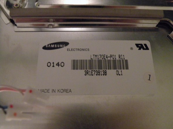

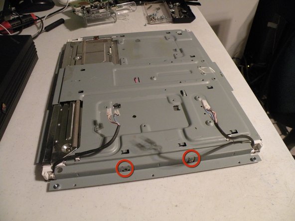

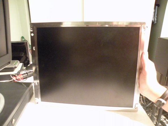

Image 1/3: The Panel is manufactured by Samsung, and aparerntly, aren't easy to find, I Googled the model # and found 2 results. Image 2/3: Well, that's it for this teardown, good luck! Image 3/3: Well, that's it for this teardown, good luck!
  • Once you have removed all of the screws, remove the rear metal panel, watching the inverter cables of course!, this will provide acess to the LCD Panel
  • The Panel is manufactured by Samsung, and aparerntly, aren't easy to find, I Googled the model # and found 2 results.
  • Well, that's it for this teardown, good luck!
