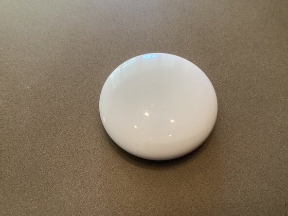

    • This is a first generation Apple AirTag. Released in 2021, this coin shaped device is a helpful device for people tracking valuable lost items for security and protection against theft, but the AirTag has been criticized for privacy concerns. Either way, mine has reached the end of its life, so, I figured I’d do a teardown of it.
    • The AirTag features a CR2032 lithium cell battery that is easy to replace by twisting the metal backplate off.

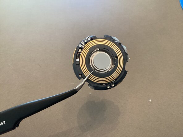

    • Here is the round PCB responsible for the device being able to work.
    • Some of the main chips On the back (main side) of the board:
    • Apple U1 ultra-wide and transceiver chip (largest one on the board.)
    • Nordic Semiconductor nRF52832 Bluetooth low-energy SoC with an NFC controller integrated.
    • GigaDevice GD25LE32D 32 Mb serial NOR flash Chip
    • There are some diodes on the front side and a Bosch Sensortec BMA28x 3-axis accelerometer chip too.
