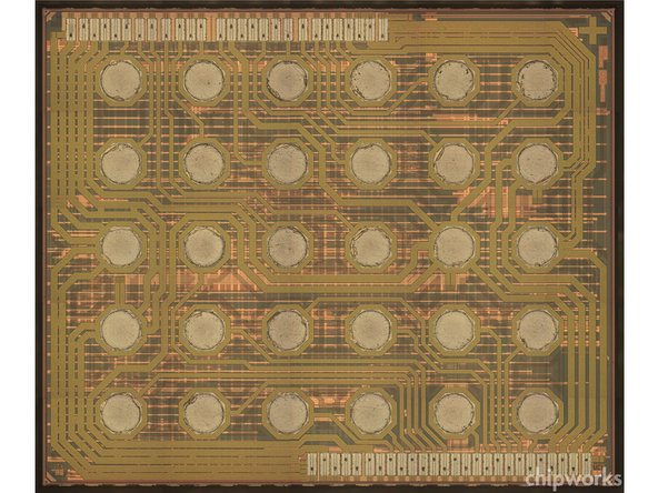

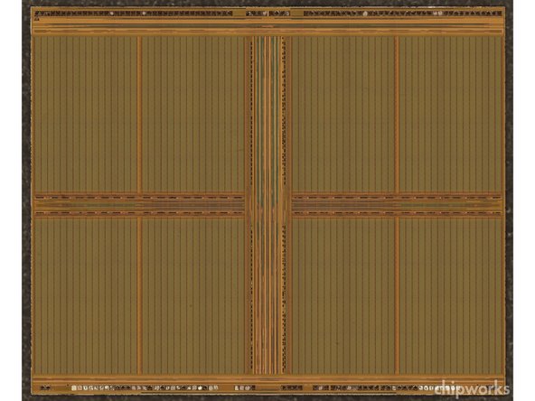

Image 1/2: It wouldn't be Apple season without our friends at [http://www.chipworks.com|Chipworks]. Thanks to these bearers of good tidings, we have the inside scoop on Apple's new processor. Image 2/2: It wouldn't be Apple season without our friends at [http://www.chipworks.com|Chipworks]. Thanks to these bearers of good tidings, we have the inside scoop on Apple's new processor.
  • It's that time of year again. The air is crisp, the leaves are turning, the Apples are coming out. If you ask us, the best thing about fall is tearing into an Apple or two. In the spirit of the season we're headed into Apple's A7 processor.
  • It wouldn't be Apple season without our friends at Chipworks. Thanks to these bearers of good tidings, we have the inside scoop on Apple's new processor.
Image 1/2: Don't worry, we'll get there. But first, here's the science behind the magic. Image 2/2: It's not science without a laboratory. And Chipworks has just that.
  • What, you wanted to see the internals?
  • Don't worry, we'll get there. But first, here's the science behind the magic.
  • It's not science without a laboratory. And Chipworks has just that.
  • We've got total ion blaster envy for Chipwork's Ion Beam Etcher, or IBE.
  • Our friend IBE takes layers off a semiconducter by blasting it with atoms in an ion beam. Power. Precision. Prettydangawesome.

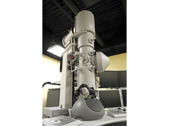

Image 1/2: ...ready for the transmission electron microscope (TEM). Image 2/2: This bad boy is handy when you want to know transistor strain, gate oxide thicknesses, or crystal lattice orientation.
  • After pre-processing the chips are examined. It's best to see that your specimen is ready...
    • ...ready for the transmission electron microscope (TEM).
  • This bad boy is handy when you want to know transistor strain, gate oxide thicknesses, or crystal lattice orientation.
  • Like the ion blaster, the TEM uses the shoot-first-ask-questions-later method by blasting electrons at its prey to see just what they're made of.
  • We've had fun taking a tiny peek at Chipworks's playground, but we've got to move on before the anticipatory drool leads to a series of keyboard replacements.

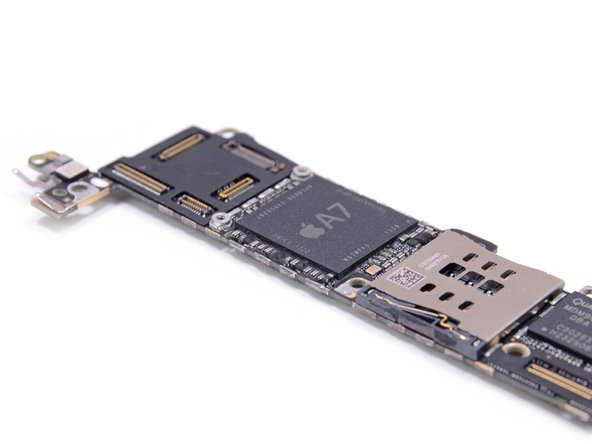

Image 1/2: The A7 is the first use of a 64-bit processor in a smartphone. Based on [http://anandtech.com/show/7335/the-iphone-5s-review/2|AnandTech's review], it seems that the bulk of the A7's performance gains do not come from any advantages inherent to a 64-bit architecture, but rather from the switch from the outdated ARMv7 instruction set to the newly-designed [http://www.arm.com/files/downloads/ARMv8_white_paper_v5.pdf|ARMv8]. Image 2/2: The modern ARMv8 instruction set was designed for a 64-bit architecture. It does away with the legacy support of the last 20 years, which increases efficiency, improving performance without sacrificing battery life.
  • As promised by Apple, and most recently confirmed by Gizmodo via the magic of benchmark testing, the A7 provides twice the performance of the A6 processor.
  • The A7 is the first use of a 64-bit processor in a smartphone. Based on AnandTech's review, it seems that the bulk of the A7's performance gains do not come from any advantages inherent to a 64-bit architecture, but rather from the switch from the outdated ARMv7 instruction set to the newly-designed ARMv8.
  • The modern ARMv8 instruction set was designed for a 64-bit architecture. It does away with the legacy support of the last 20 years, which increases efficiency, improving performance without sacrificing battery life.

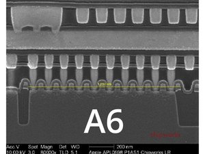

Image 1/2: The techs at Chipworks took out their [nano]meter stick and measured the distance between these transistors, which at first seemed very similar to the A6. Image 2/2: But wait! It turns out that the A7′s “gate pitch” — the distance between each transistor — is 114 nm, compared to the A6′s 123 nm.
  • Check out the A7 processor's cross-section. Every little hump (through which you see that yellow line) is a transistor. By measuring the total distance between ten of these transistors, we can estimate a chip’s manufacturing process—essentially how tightly the manufacturer can pack in all that processing power.
  • The techs at Chipworks took out their [nano]meter stick and measured the distance between these transistors, which at first seemed very similar to the A6.
  • But wait! It turns out that the A7′s “gate pitch” — the distance between each transistor — is 114 nm, compared to the A6′s 123 nm.
  • Those 9 nm are a big deal. Looking to improve on their current 32 nm process, Apple decided to make the A7 with the same 28 nm process as the eight-core Samsung Exynos 5410, the current flagship CPU for Samsung’s own Galaxy line.
  • So what does that translate to? Applying some mathematrickery (28^2 divided by 32^2 = 784/1024), this seemingly small change equates to having the same computing power, but in 77% of the original area. And given that the A7 processor is larger in area than the A6, that means even more processing power to lead a healthy, smartphone-laden lifestyle.

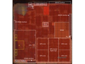

  • Apple's September 10th Town Hall event marked the first time an official transistor count was given. Will we see a more transparent Apple in the future? Only time (or a back panel modification) will tell.
  • Update: Our chip-buddies have given us the "floorplan" of the A7!

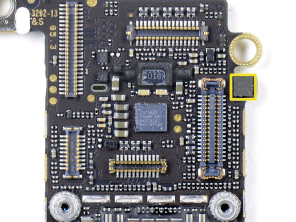

Image 1/2: Bosch Sensortech BMA220 3-axis accelerometer Image 2/2: STMicroelectronics 3-axis gyroscope
  • So the M7 is tasked with accessing information from three sensors, and with Chipworks' help we found these too:
    • Bosch Sensortech BMA220 3-axis accelerometer
    • STMicroelectronics 3-axis gyroscope
    • AKM AK8963 3-axis magnetometer
  • After collecting information from the accelerometer, gyroscope, and magnetometer, the M7 performs some matrix math processing magic to produce an absolute orientation of the phone relative to the world. This data is then passed to the A7 in a neat package, probably in the form of three headings (roll, pitch, and yaw).

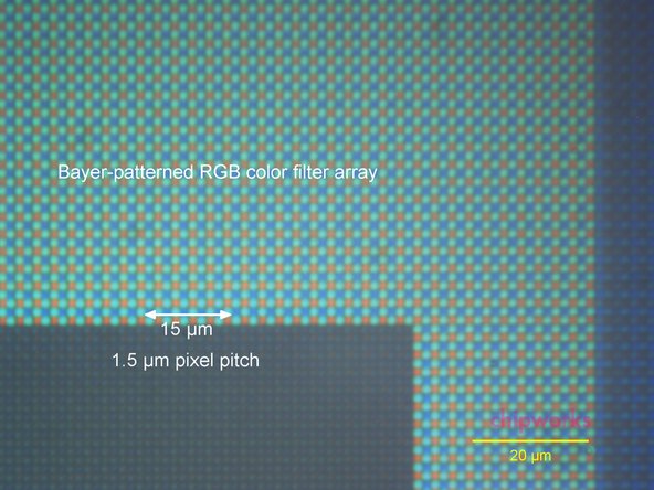

Image 1/3: That's gravy and all, but ever wonder what a 1.5 µm pixel pitch actually looks like? ''Well wonder no more!'' The first image in this step shows how your camera sees you when you take that duck-faced selfie. Image 2/3: The end result from these tweaks should be better low-light photography, and combined with the dual-color LED flash, retention of natural coloring. No more [http://d3nevzfk7ii3be.cloudfront.net/igi/VlgTLm4jKtNc2rfV|Predator-vision party pics.] Well... unless you're the Predator. Image 3/3: The end result from these tweaks should be better low-light photography, and combined with the dual-color LED flash, retention of natural coloring. No more [http://d3nevzfk7ii3be.cloudfront.net/igi/VlgTLm4jKtNc2rfV|Predator-vision party pics.] Well... unless you're the Predator.
  • This time around, Apple opted to stick with 8 MP resolution for the iSight camera, but increased the active pixel array area by 15%. Bigger pixels and a wider f/2.2 aperture means the system delivers a 33% increase in light sensitivity.
  • That's gravy and all, but ever wonder what a 1.5 µm pixel pitch actually looks like? Well wonder no more! The first image in this step shows how your camera sees you when you take that duck-faced selfie.
  • The end result from these tweaks should be better low-light photography, and combined with the dual-color LED flash, retention of natural coloring. No more Predator-vision party pics. Well... unless you're the Predator.

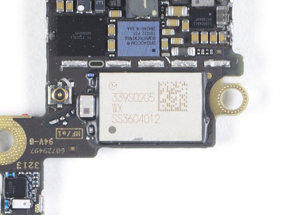

Image 1/1: It is designed to be used with external 2.4 GHz and 5 GHz front-end modules, which include power amplifiers, T/R switches and optional low noise amplifiers.
  • Contained within this module is the BCM4334, like we saw last year in the iPhone 5. It includes IEEE 802.11 a/b/g/n single-stream MAC/baseband/radio, Bluetooth 4.0 + HS, and an integrated FM radio receiver.
  • It is designed to be used with external 2.4 GHz and 5 GHz front-end modules, which include power amplifiers, T/R switches and optional low noise amplifiers.
  • Apple chose not to upgrade the iPhone to the latest Broadcom chipset to take advantage of their new 802.11ac base stations.

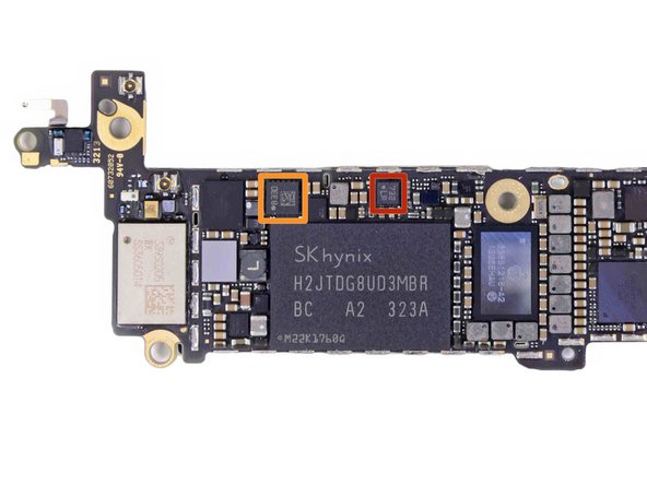

Image 1/1: Skyworks SKY77810 2G/EDGE Power Amplifier
  • With all of the power of the new A7, exciting camera features, and the M7 coprocessor, it's easy to forget that smartphones are still phones, and making and taking calls ought to be a pretty high priority. This functionality is handled by an impressive array of RF components working together:
    • Skyworks SKY77810 2G/EDGE Power Amplifier
    • Avago A792503 Band 25/3 Power Amplifier
    • RF Micro RF3763 Band 5/8 Dual Power Amplifier
    • Skyworks SKY77572 Band 18/19/20 Power Amplifier
    • Skyworks SKY77496 Band 13/17 Power Amplifier
    • TriQuint TQF6414 Band 1/4 Dual Power Amplifier
