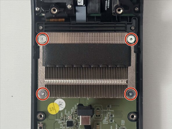

  4. Amazon One Palm Reader Teardown (Nalloy A2D0US), Peeking at The Core Architecture: step 4, image 1 of 2 Amazon One Palm Reader Teardown (Nalloy A2D0US), Peeking at The Core Architecture: step 4, image 2 of 2
    • We're finally in! To take a look at the brains of the device, locate the heatsink.
    • Unscrew the 4 large screws holding the heatsink in place with your T6 screwdriver bit (these screws are equipped with springs, so they'll stay attached to the heatsink even when fully loosened).
    • We've made it to the core architecture! The device is powered by a Qualcomm QCS610 running Android 10, with 32GB of eMMC storage (SanDisk SDINBDA4) and 4GB of LPDDR4X RAM (Samsung K4UBE3D4AA-MGCL).

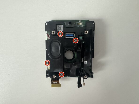

  9. Amazon One Palm Reader Teardown (Nalloy A2D0US), Disconnecting the Speaker: step 9, image 1 of 3 Amazon One Palm Reader Teardown (Nalloy A2D0US), Disconnecting the Speaker: step 9, image 2 of 3 Amazon One Palm Reader Teardown (Nalloy A2D0US), Disconnecting the Speaker: step 9, image 3 of 3
    • To remove the speaker on the imaging assembly, locate the 4 screws holding the module in place, and remove them using your T6 screwdriver bit.
    • Find the connector that connects the speaker to the PCB and unplug it.
    • Remove the speaker! The speaker wasn't used very often by the palm scanner, and it's unsure why it even exists. My personal guess is that it was most likely included in the final product in-case Amazon planned to utilize it in the future... or perhaps it's used for accessibility if headphones aren't available?
