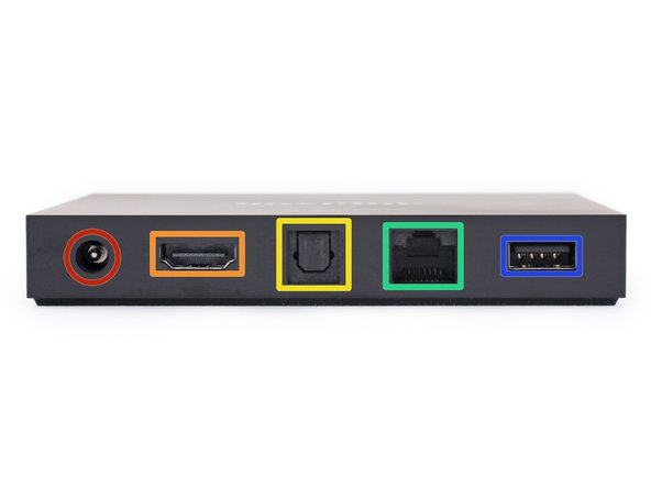

The otherwise featureless black box has a rainbow of ports on its rear:
5.5 mm DC Jack
Type A HDMI 1.4b output, w/HDCP
Optical Audio (TOSLINK)
10/100 Ethernet
USB 2.0 Type A

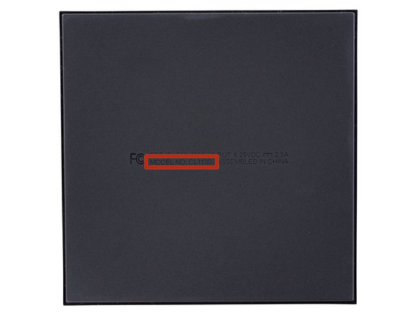

On the flip-side we've got some runes:
Model CL1130
6.25 Volt DC Input
Federal Communications Commission Approval

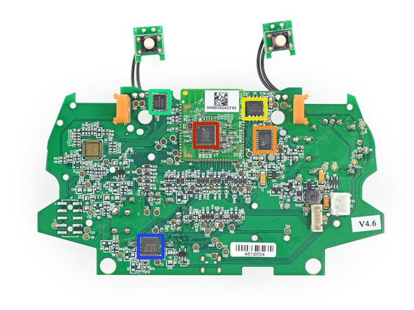

But wait...there's more! Round three of this teardown brings us to the gaming controller.
The controller is tamper-proofed with a variant of the tri-wing screw family. They look cool and resemble shurikens, but we don't know anybody who keeps a shuriken driver on their tool belt.
Outwitting the strange screws, we pop this controller open. At least there's no adhesive keeping it shut.
And to complete the trifecta, there lies the controller's RFID tag.

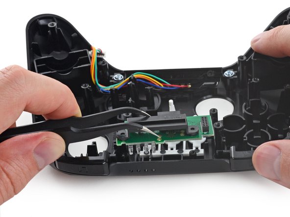

We tweeze out little trigger button boards like splinters.
There's no time for a status report as we quickly free the status light and its
little green friendboard.
Next we pull the trigger...off the controller's motherboard.
We've touched the
Flying Spaghetti Monstermotherboard, and we're ready for some tasty treats: -
Boy howdy, it's your lucky day, reader! A second (gamier) layout, just for you.

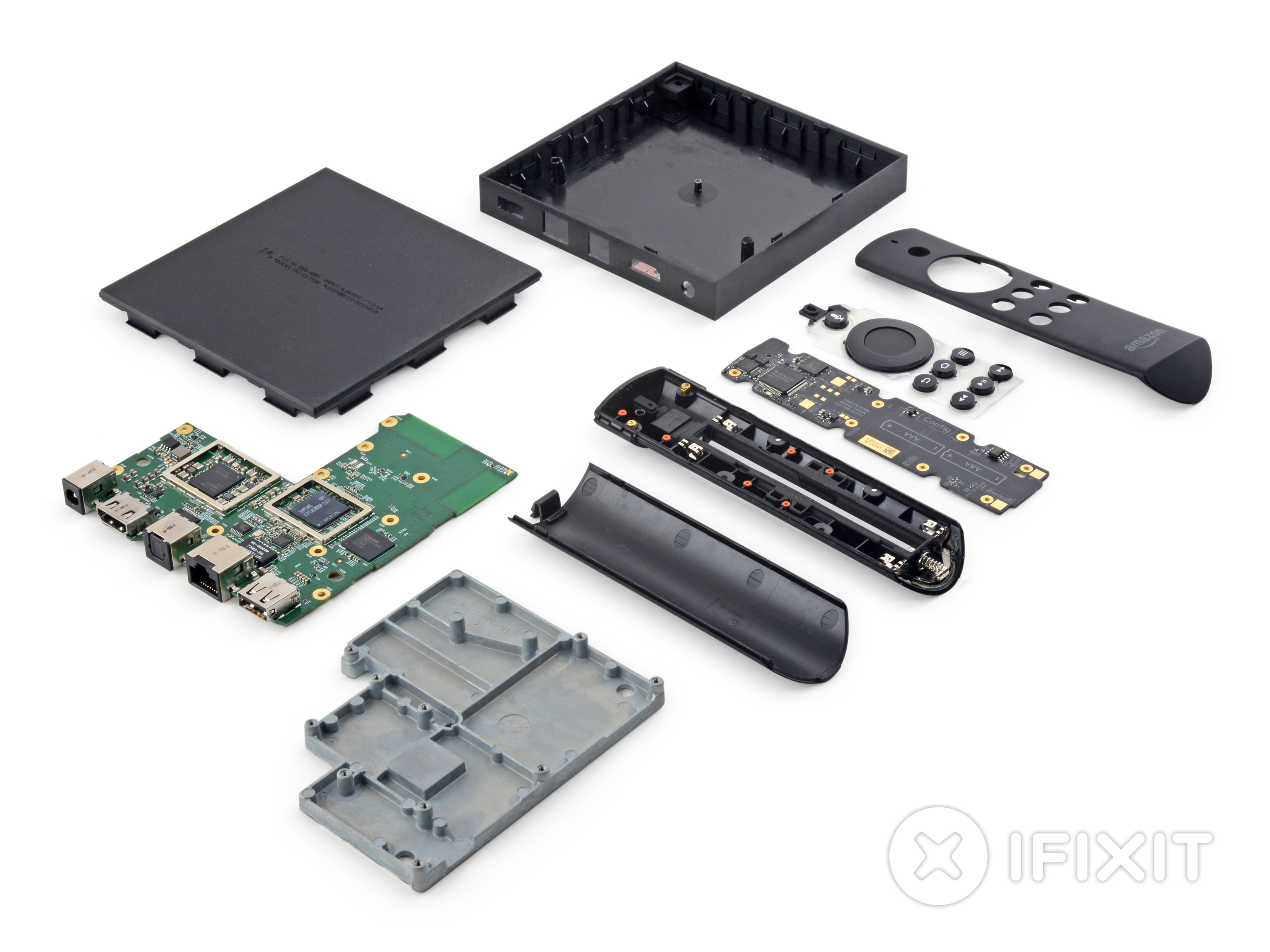

Amazon Fire TV Repairability Score: 6 out of 10 (10 is easiest to repair)
Simple construction—upper case, lower case, heat sink, motherboard. Once it's apart, there's not much to keep track of.
The power supply is separate; should it ever need replacement, there'll be no disassembly required.
Standard Phillips screws populate the internals, making this box a worry-free affair once you're inside...
...provided you never need to remove the heat sink, which is secured with copious amounts of extremely sticky glue.
The outer case is a very tight fit. Plastic clips are used rather than glue, but they're so stubborn you'd be forgiven for thinking otherwise.
A single board hosts all the vitals—clean and simple, but when it comes to repair, it's all or nothing.

So, I'm assuming we have analog sticks. But what are we seeing for the face buttons? Pressure sensitivity or digital only?
will - Reply
are those feedback motors or just weights
Vince - Reply
The buttons are just digital. You can tell from the PCB lands.
Those are just weights, and not motors. Maybe they were a late scratch for cost, or they will add a new more expensive version with the same enclosure. The weight probably makes it feel "better". I know I prefer heavier controllers than those without motors or batteries inside.
