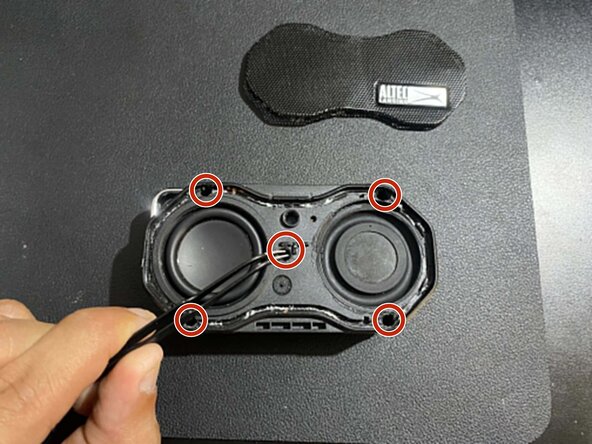

  3. Altec Lansing Baby Boom Speaker Teardown, Rubber Seals: step 3, image 1 of 1
    • Use your tweezers to remove/pull those 5 rubber seals encircled to reveal the screws.
    • Note: At this point, by performing this step, you are actively voiding the warranty, and the waterproofing will no longer work, so proceed at your own risk.

  4. Altec Lansing Baby Boom Speaker Teardown, Screws: step 4, image 1 of 1
    • Use your phillips screwdriver (preferably magnetic) and unscrew all 5 screws.
