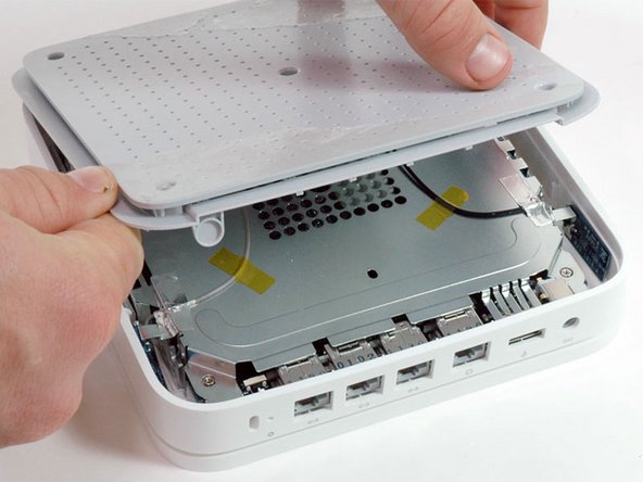

    • Lift the perforated plastic cover out.

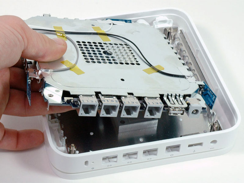

    • Lift the guts of the base station out of the casing.
    • There are two large blocks of aluminum on the upper case that Apple is using as heat sinks. The upper case alone is .9 lbs-- over half the weight!
    • There are three antennas mounted internally: one on front (white cable), left (grey cable), and right (black cable). They all have standard antenna conectors on them.
