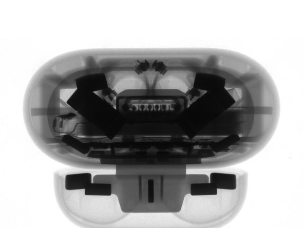

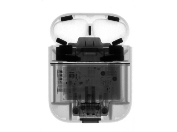

  2. AirPods—featuring the electrifying Apple Egg! On one end, this power-packed charging case is equipped with a Lightning connector to charge its battery. At the other end, recessed deep within each AirPod housing, is a pair of contacts for charging the 'Pods respective onboard batteries.
    • AirPods—featuring the electrifying Apple Egg!
    • On one end, this power-packed charging case is equipped with a Lightning connector to charge its battery.
    • At the other end, recessed deep within each AirPod housing, is a pair of contacts for charging the 'Pods respective onboard batteries.
    • Finally, at the top of the charge case, we spy a little status LED for notifying you when the triad of batteries is collectively out of juice.
    • You can see it all end-to-end if you have X-ray vision. Keep your eyes peeled for some deep scans of the AirPods throughout this teardown.

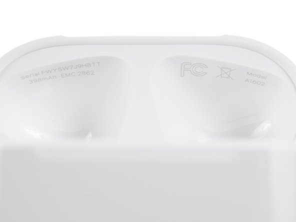

  3. The charge case cover sports a new model number—A1602—and offers up some info on the case's overall power capacity: 398 mAh. Performing our last teardown rites on the charge case, we take a quick peek at the setup button on the back. If Apple's highly-touted instant sync feature fails or isn't available, this button is here to save the day with a more traditional Bluetooth pairing process. Alright, no more wasting time. Let's get to the good stuff.
    • The charge case cover sports a new model number—A1602—and offers up some info on the case's overall power capacity: 398 mAh.
    • Performing our last teardown rites on the charge case, we take a quick peek at the setup button on the back. If Apple's highly-touted instant sync feature fails or isn't available, this button is here to save the day with a more traditional Bluetooth pairing process.

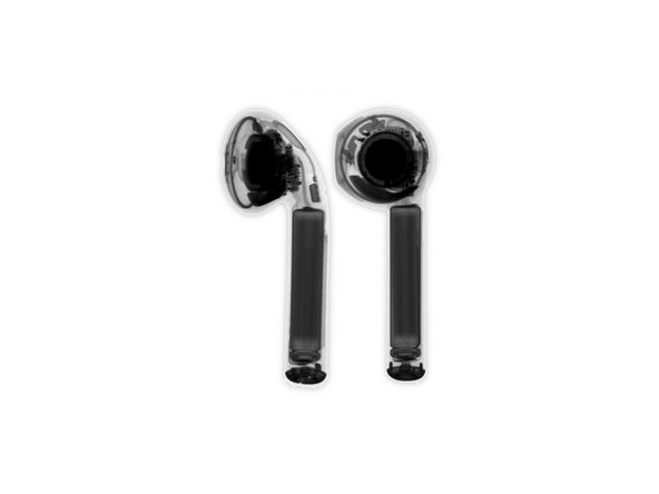

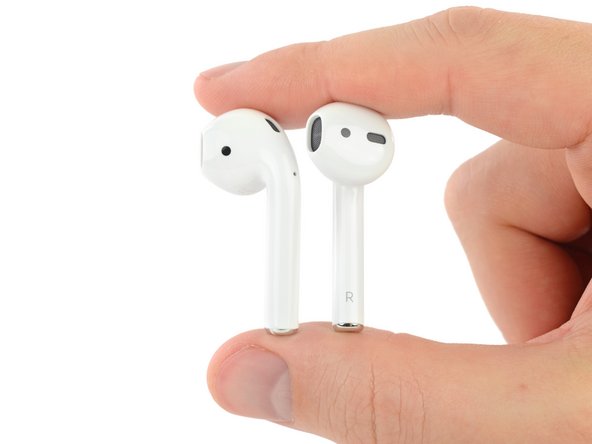

  4. The earbuds are covered in dots: grilles for speaker action, microphone holes for those noise-canceling secondary mics, and black dots for IR proximity sensors. The 'Pods are individually labeled with separate model numbers—A1722 (left) and A1523 (right)—and FCC IDs, BCG-A1722 and BCG-1523. X-rays give us a peek at what's inside, some grilles, and that microphone, the rest is a mystery to unravel.
    • The earbuds are covered in dots: grilles for speaker action, microphone holes for those noise-canceling secondary mics, and black dots for IR proximity sensors.
    • The 'Pods are individually labeled with separate model numbers—A1722 (left) and A1523 (right)—and FCC IDs, BCG-A1722 and BCG-1523.
    • X-rays give us a peek at what's inside, some grilles, and that microphone, the rest is a mystery to unravel.

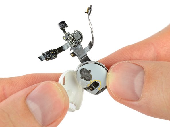

  6. At this point we're momentarily stymied—what remains in the earbud is a hot mess of cables and adhesive, and none of it seems particularly keen on coming out. So we turn to the stem, hoping for another entry point. Instead, we encounter a waterfall of glue. That shiny metal cap provides contact points for charging the AirPod, and surrounds the primary microphone. Hidden behind and within the torrent of glue, we spy the end of the battery cable.
    • At this point we're momentarily stymied—what remains in the earbud is a hot mess of cables and adhesive, and none of it seems particularly keen on coming out. So we turn to the stem, hoping for another entry point.
    • Instead, we encounter a waterfall of glue.
    • That shiny metal cap provides contact points for charging the AirPod, and surrounds the primary microphone. Hidden behind and within the torrent of glue, we spy the end of the battery cable.
    • Ripping out the glue plug reveals the end of a teensy weensy battery, with teensy weensy spot welds. Looks like we won't be replacing these any time soon (or recycling them, ever).
    • Having exhausted the obvious entry points, we opt for the full surgical approach. Nurse, hand me the scalpel.
    • Lifting the membrane with surgical precision reveals what's likely an antenna laid over the heart battery.
    • Okay, so we might not have the patience of a surgeon. The pliers come out, and we rip the rest of the casing off to get to the goodies.

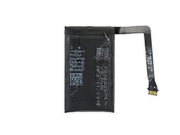

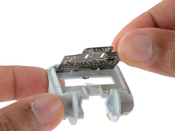

  7. With the plastic casing off, we're able to peel that long antenna from the battery. Finding the antenna here explains a bit about the AirPods' design. That hanging boom is for more than just balance—it's also to improve reception.
    • With the plastic casing off, we're able to peel that long antenna from the battery.
    • Finding the antenna here explains a bit about the AirPods' design. That hanging boom is for more than just balance—it's also to improve reception.
    • Digging deeper under more glued-on cables and tape, we find some markings etched into the battery. Looks like this is a 93 milliwatt hour battery—equivalent to a little over 1% of the charge capacity in an iPhone 7.

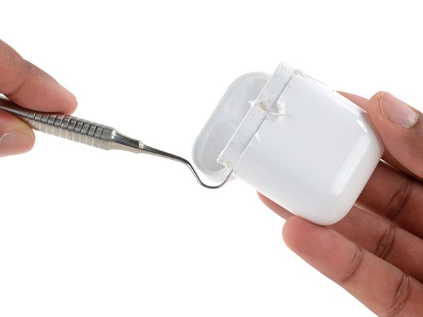

    • AirPods pretty well destroyed, we turn to their seamless-looking case...
    • Jimmy proves to be too nice a guy to open our stubborn charging case.
    • So we grab something with a little more tooth. Don't worry, you'll only feel a sliiight pressure ...
    • Fair warning: this is not the safest way to do this. But the dentist told us we only bled because we haven't been flossing.
    • We're finally able to pull the cabley 'pod holder out of the main case, revealing some internals—namely a hefty battery.

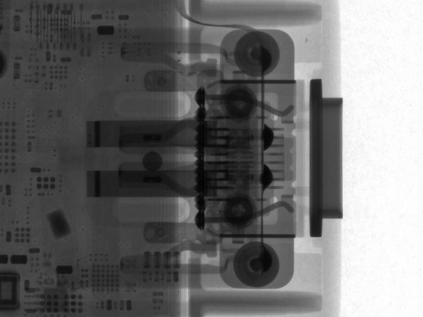

  14. We loosen a pair of Phillips screws to access the Lightning connector, pop its press connector off the back of the logic board, and seconds later it's free to leave this plastic mess behind. Luckily, the Lightning port is modular—so if you wear your port out, all you have to do is utterly destroy the case to replace that component. The logic board is secured with a lot of sticky tape.
    • We loosen a pair of Phillips screws to access the Lightning connector, pop its press connector off the back of the logic board, and seconds later it's free to leave this plastic mess behind.
    • Luckily, the Lightning port is modular—so if you wear your port out, all you have to do is utterly destroy the case to replace that component.

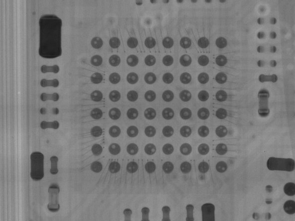

  15. Let us take a look at what silicon is so heavily guarded by the charging case: STMicroelectonics STM32L072 ARM Cortex-M0+ MCU Our X-ray imagery shows some quality issues in this chip's solder joints. Empty spaces, known as voiding, could be evidence of low quality standards, or a rushed product release. Could issues with the AirPod case be what delayed release?
    • Let us take a look at what silicon is so heavily guarded by the charging case:
    • STMicroelectonics STM32L072 ARM Cortex-M0+ MCU
    • Our X-ray imagery shows some quality issues in this chip's solder joints. Empty spaces, known as voiding, could be evidence of low quality standards, or a rushed product release. Could issues with the AirPod case be what delayed release?
    • NXP 1610A3 charging IC (as seen in iPhones 6s and SE and both iPad Pro models)
    • Texas Instruments BQ24232 power management IC

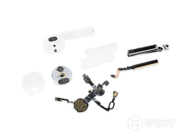

  16. Blood, sweat, and lots of glue later, we give you: A pile of 'pod parts... and a collection of case components.
    • Blood, sweat, and lots of glue later, we give you:
    • A pile of 'pod parts...
    • and a collection of case components.
