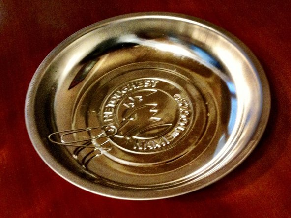

A few pieces that help you when working:
1) A mechanics magnetic bowl. You can pick them up at home depot for around $10 and work great for holding your screws. It reduces the chance of knocking them off of the table.
